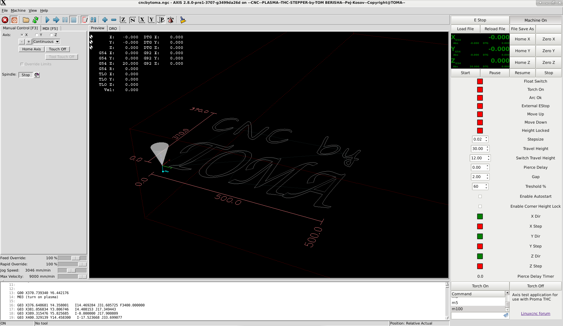

Several different configs for Plasma cutters with simple THC that output UP/DOWN/ARCOK signals and for THCAD, one is for stepper motor driven machine using parallel port, the other is for a servo driven machine with one stepper driving the Z axis using 5i25/7i77 for servo and parallel port for the stepper control. Added for Mesa cards, added for a full servo system with Mesa 5i25/7i77, added for THCAD etc.
Most of the instructions are included in the files, but here is some short info on the usage and capabilities:
-You have to edit the hal and ini files for it to work on your machine as every machine has differences.
-Make sure that the values you enter correspond to your machine.
-Use a text editor like Nano, Gedit, Pluma, Geany, do not use word processors like openoffice.
-Use Inkscape for drawings and conversion to gcode, using gcodetools included with Inksape, set the Z height to 0 in the gcodetools configuration window.
===Features and capabilities===
-Fully automated torch height control for plasma cutting.
-Does not require any post processor.
-Uses gcode directly exported from Inkscape.
-Does not need any touch off, subroutines or remapping.
-Does not require using offsets
-Settable pierce height
-Settable cut height
-Settable THC speed
-Settable pierce delay
-Settable pierce gap
-Corner lock with settable threshold
===How it works===
-At every M3 it does the following:
--move the torch down till it trips the floating switch
--move the torch up to the height set in the "Sw.Travel" plus the "Pierce gap"
--fire the torch and wait for ARCOK signal
--wait for the Pierce delay if set
--move to the cut height and commence motion
if the signal for ARCOK fails ( miss fire ), it will retry the number of times set at the bottom of the ini file
if it looses the ARCOK signal while cutting, it will stop motion and retry to fire the torch

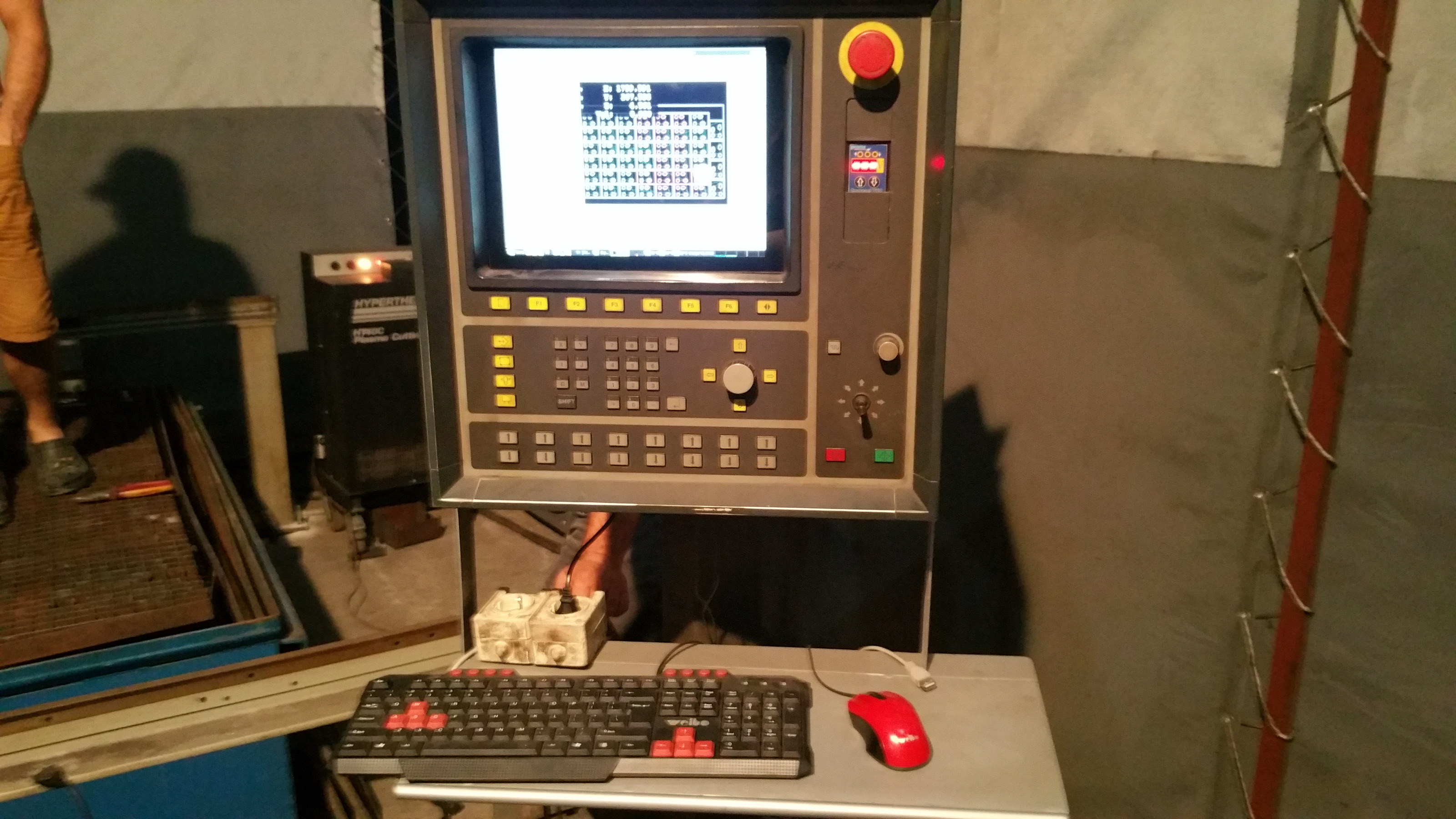

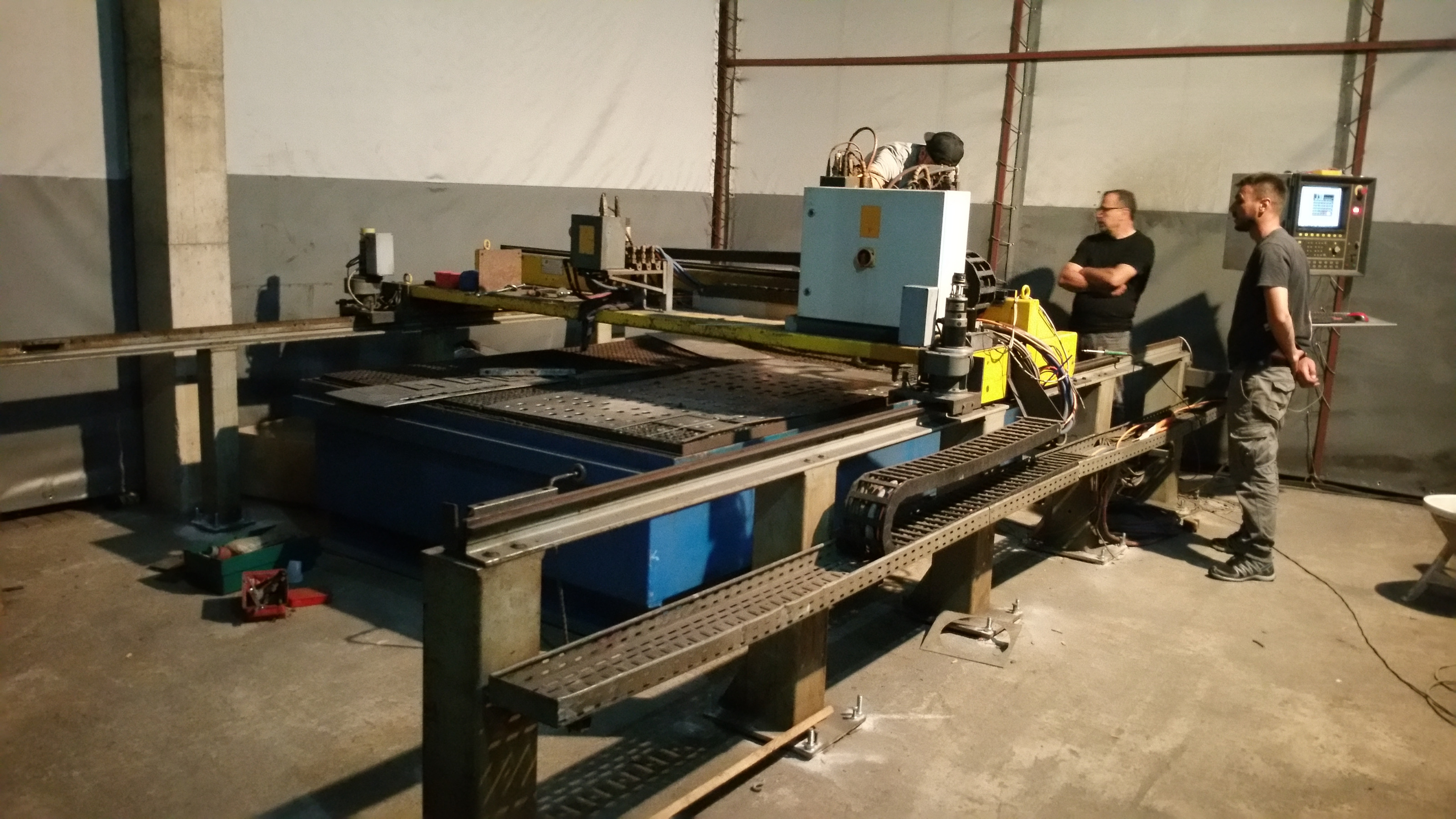

This is the last retrofit i did on an ESAB Ultrarex UXD-P 2500, it uses servo drives controlled by Mesa 6i25/7i77 with the added stepper drive for the Z axis connected to parallel port. Proma THC used for torch height control as they have proven very reliable. Also added to "show your stuff" thread with youtube video of it working.
forum.linuxcnc.org/show-your-stuff/34986...nuxcnc-and-proma-thc
This one uses the config uploaded at the beginning of this thread.
And this is the control panel.

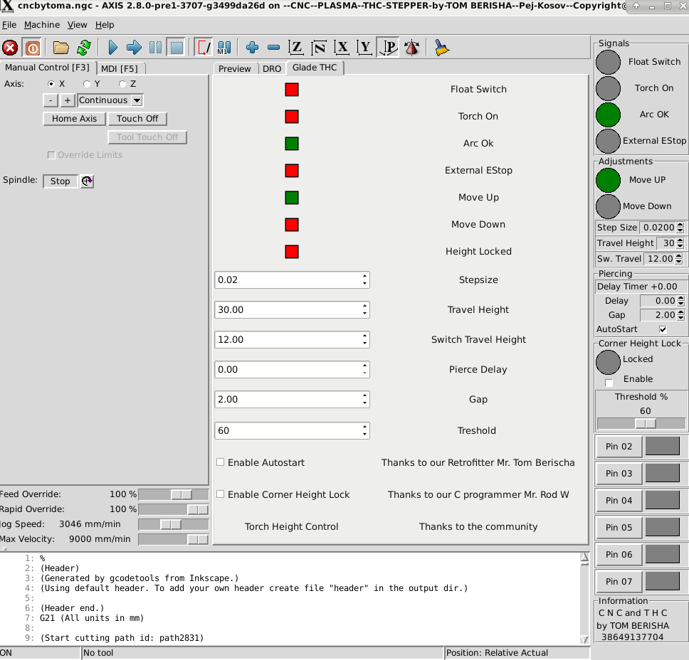

I have made a glade panel. and it works ! For me it was quite easy to do. Had a 4 or 5 difficulties to merge, but no problem.
Here the picture of the standard glade panel i made and tested for signals.
Now second item is to make a nice looking tab for Axis and for Gmocappy and Gscreen.
In the zip files, all connections to the glade panel are made in : thc_vcp.hal
In thc_toma.ini i load the glade screen in.
I have set my parport adres to 1110 instead of 378.
So this zip file is only for those who want to explore this, this file is only for information and backup info for a thc project.
