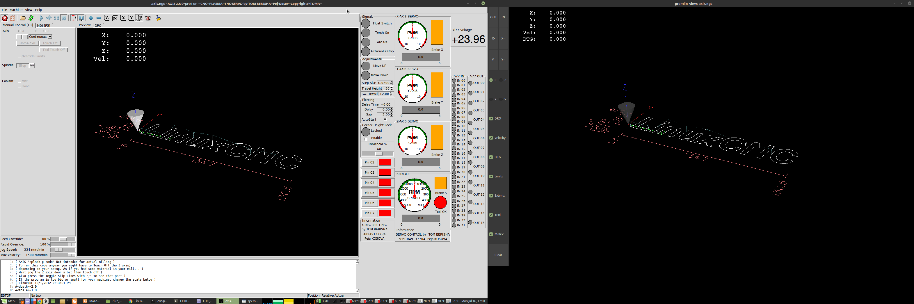

Last night i was thinking of doing something different for my machines, all of them and it goes something like this,
Find a crappy touch screen LCD monitor that is 7 to 10 inches big (already have a 7" one ) and another big monitor ( currently using 24" ), connect them to the same computer as two separate screens and use the small one with the touchy interface for control and the big one to show gremlin_view.
I did test that on a 22" and a 24" monitor and it works perfectly.
Here is how that looks with axis and a lot of PyVCP.
There is one thing i do not like about glade that has prevented me from using it before, namely when you have you mouse pointer over the glade window you can not jog the machine, although pressing esc works.

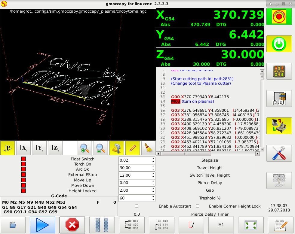

Here is the Gmocappy plasma configuration for usage with Proma Toma THC.
I had a few difficulties to solve, it works.
All the files :
Fastest installation :
If you do start linuxcnc with gmocappy plasma config, this creates automatic all the files and destop icon.
Then copy and overwrite the zip file in the target folder.
Rod, i made a few improvements. I loaded the toma ngc code at startup. And the ngc startup code is now just like toma.
All the files :

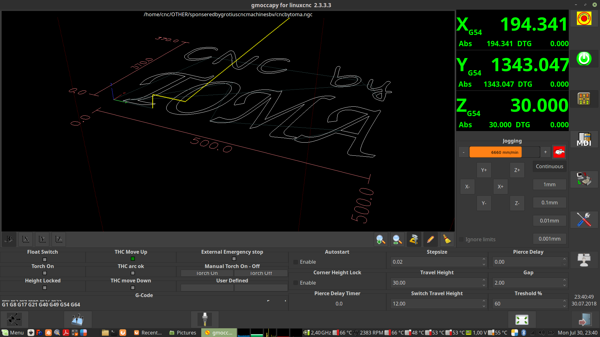

30 Jul 2018 20:45 #115172
by Grotius
Replied by Grotius on topic THC plasma configs, with HOW TO.
Hi Tommy,
I did some make up at the screen tonight.
Just like woman sometimes do when they want to look sexy.
Here the screen layout and ready project files. Also added torch on/off button. And added user defined button to fill empty space.
The Files :
The Files :

30 Jul 2018 21:43 - 30 Jul 2018 21:44 #115179
Here is how it looks on one of my laptops
I can live with that.
Bigger LED would be nice !
Replied by tommylight on topic THC plasma configs, with HOW TO.
Yes, a two meter tall blonde, please !Tommy,
I will make up the axis side screen now. Do you have any wishes?
