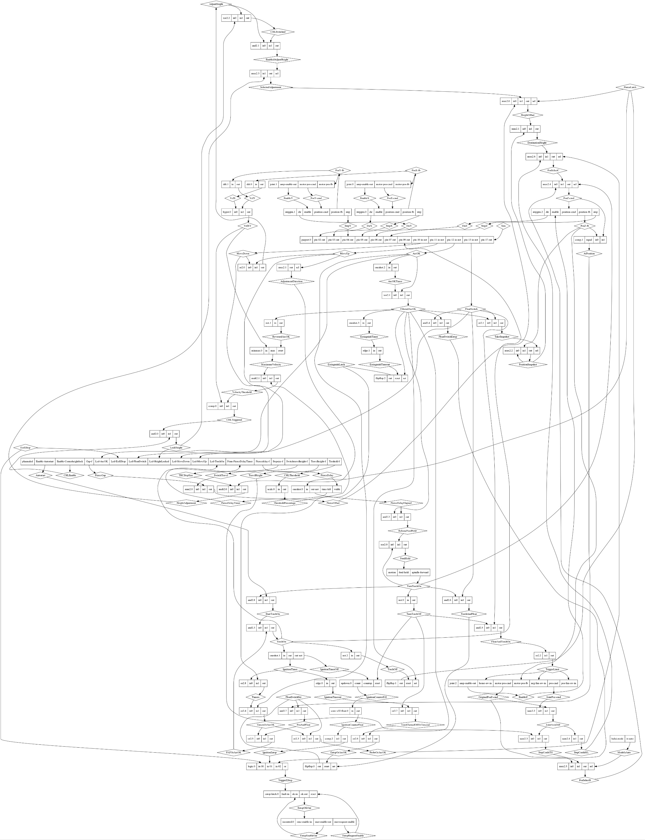

Okey, I have made a Gmoccapy Hal Visualisation of the Toma Plasma Config.
See attached documents how to do it yourself.
It's late now.
To make a cleaner image, we have to delete some hal trash, just for getting a better overview.
In the attached doc you see this line :
It also works with jpg.
It's almost impossible to do this shematic within 180 lines of Python code. But it is done !
Rename the python attachement file to : dot.py

02 Aug 2018 00:54 #115373
Replied by tommylight on topic THC plasma configs, with HOW TO.
Grotius, you are da man !!!
That is ............a LOT of work, thank you for reminding me, just scrolling through that PDF was very hard on the nerves, never mind having to follow everything around.
Well, it is complicated for sure !
With utmost respect,
Tom.
Tom.
