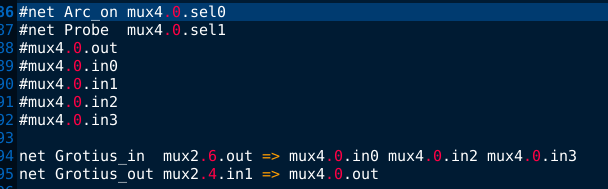

Problem is not solved.
The muxers are not working my way.
The mux2 would connect the same signal over 2 imputs. The mux4 will not do this. So 5 hours trying to do this brings no luck...
net grotius_button mux4.0.sel1
#mux4.0.out
#mux4.0.in0
#mux4.0.in1
#mux4.0.in2
#mux4.0.in3
net Grotius_in0 mux2.4.in1 mux4.0.in0
net Grotius_in2 mux2.4.in1 mux4.0.in2
net Grotius_in3 mux2.4.in1 mux4.0.in3
net Grotius_out mux2.6.out mux4.0.outThe mux2 would connect the same signal over 2 imputs. The mux4 will not do this. So 5 hours trying to do this brings no luck...

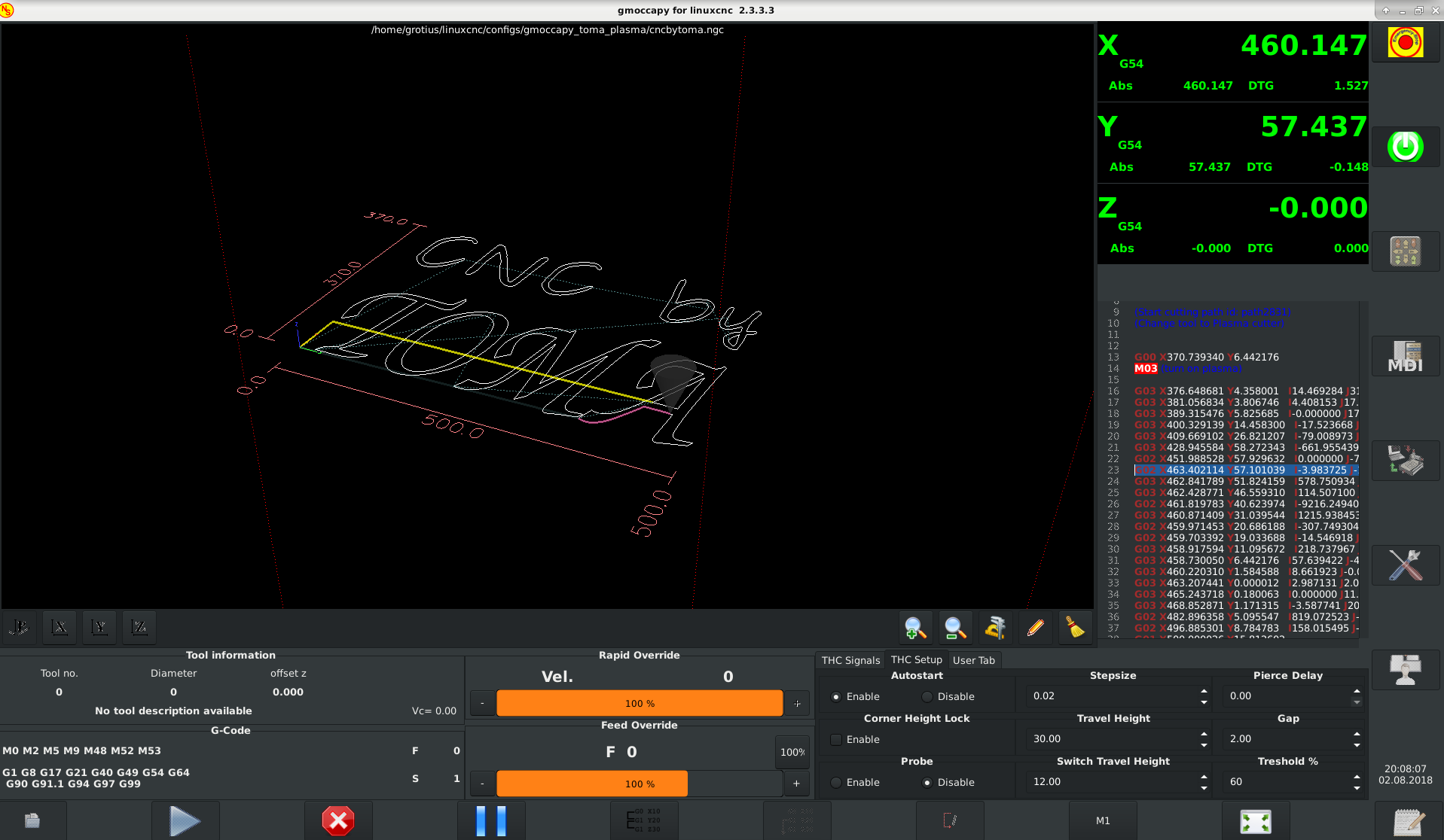

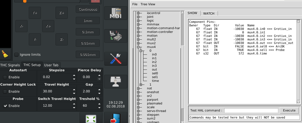

Finally Fertig.
Wow this works very nice !!
Everything is in hal.
I impressed myself with this working result.
The probe and autostart is now radiobutton. The buttonhandler works better with radiobuttons, checkbuttons don't work very well in replacement panel's. You ask yourself maybe, why is that g-code panel still on the left. My pc is out of memory in 64bit to open
the main gmoccapy glade file, so next week i get a new pc and replace the left panel for something that we can use for plasma.
Hmm. Now we can add in hal the future probe section module.
But first let's print a new hal schematic.

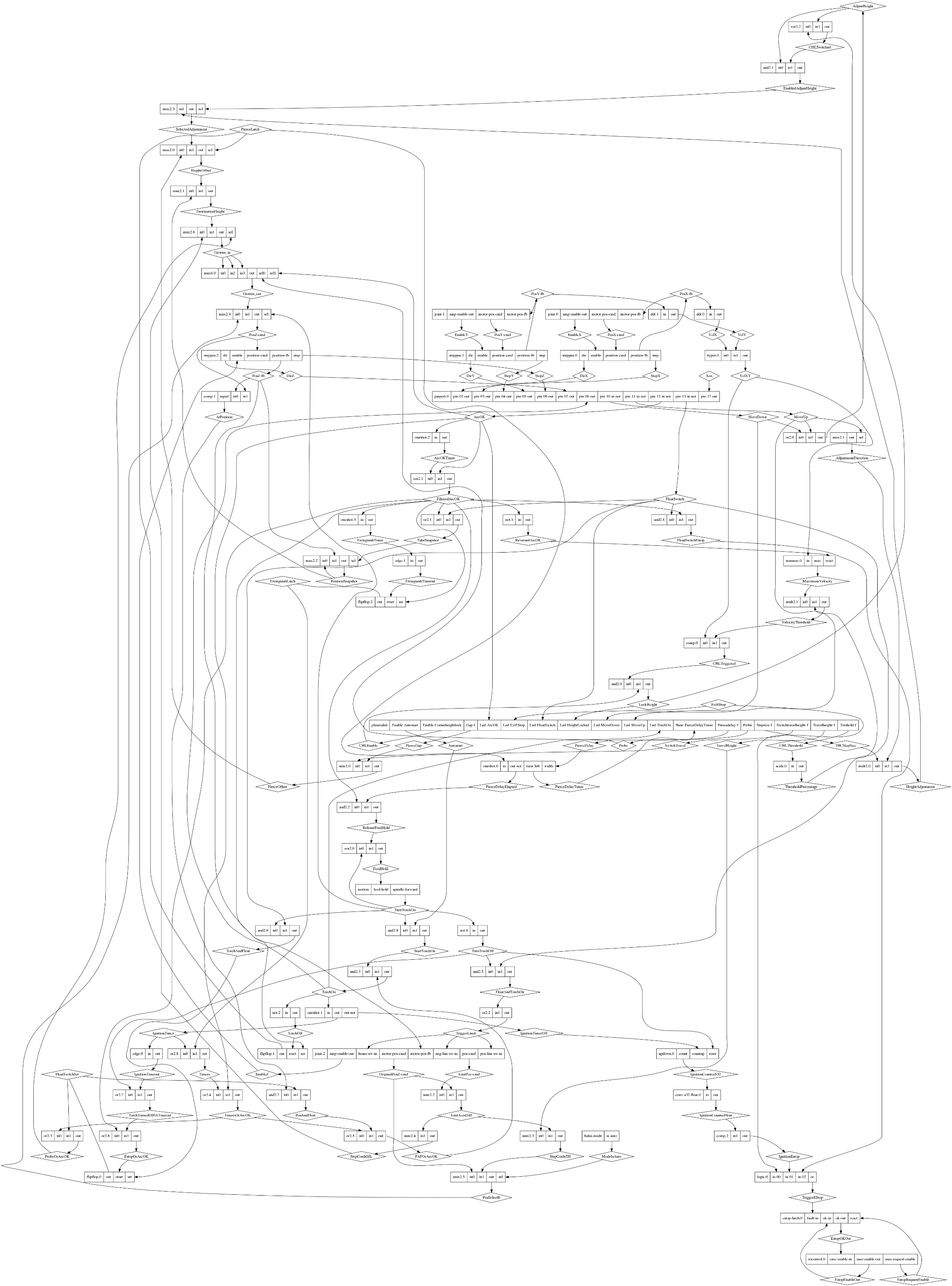

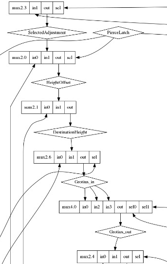

For making the schematic png or jpg, rename the file to dot.py :
Attached the latest config files for Toma Plasma
The new Hal configuration including the option :
- Enable / Disable probe (height measuring function at start)
I see the schematic has changed. It now has it's first mux4 component.

Made By Grotius, 1 August 2018 Visual Complicated Hal Files
Okey if you run the linuxcnc program with Toma config.
In linuxcnc open Halshow. Pasword = 123
Then open terminal in same folder whre dot.py is living, execute in terminal :
python dot.py > final.dot
or try
this also works fine.
Then we get some hal drawings of current configuration.For making the schematic png or jpg, rename the file to dot.py :
