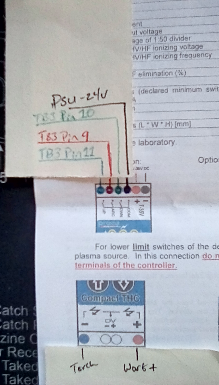

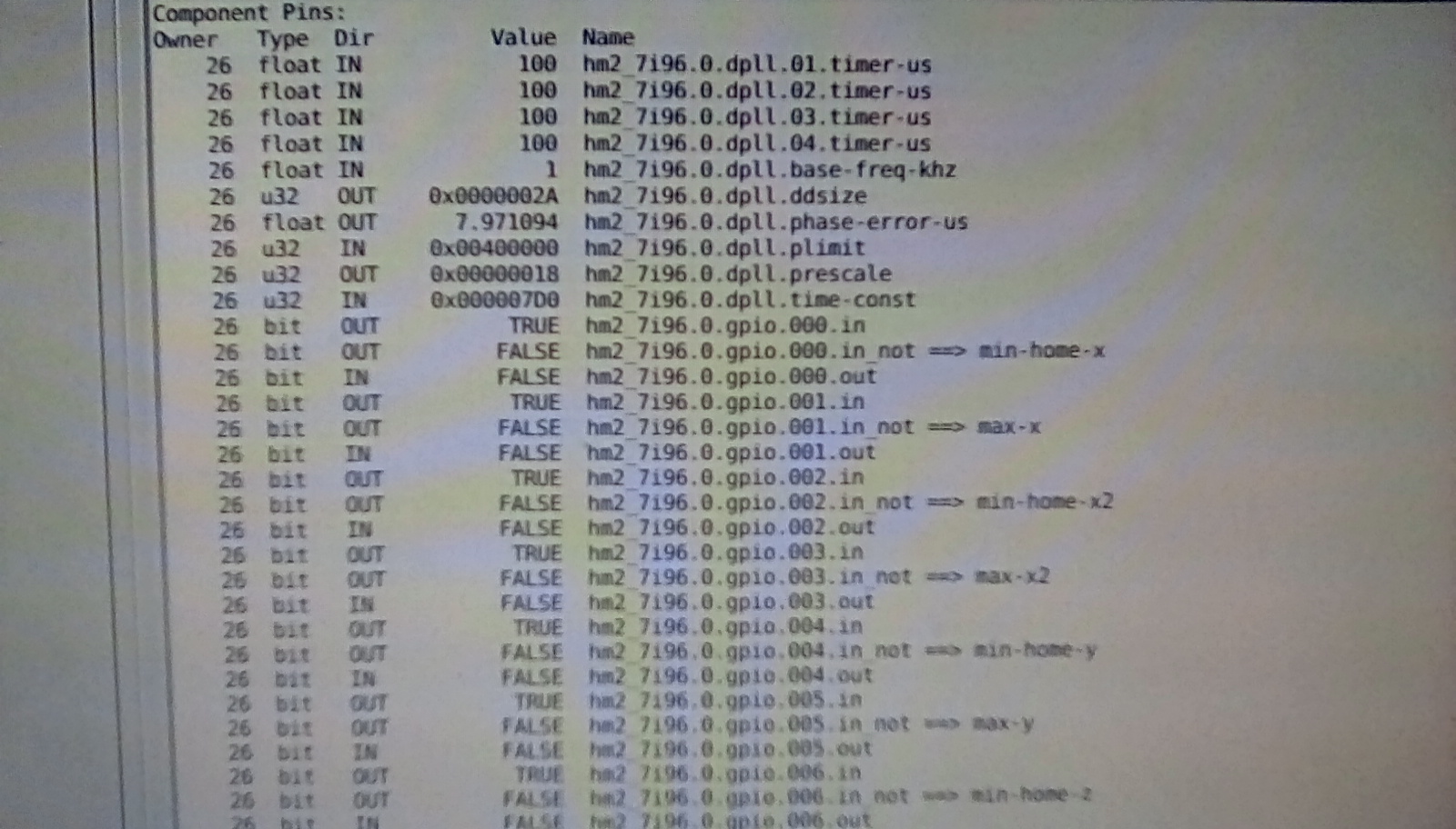

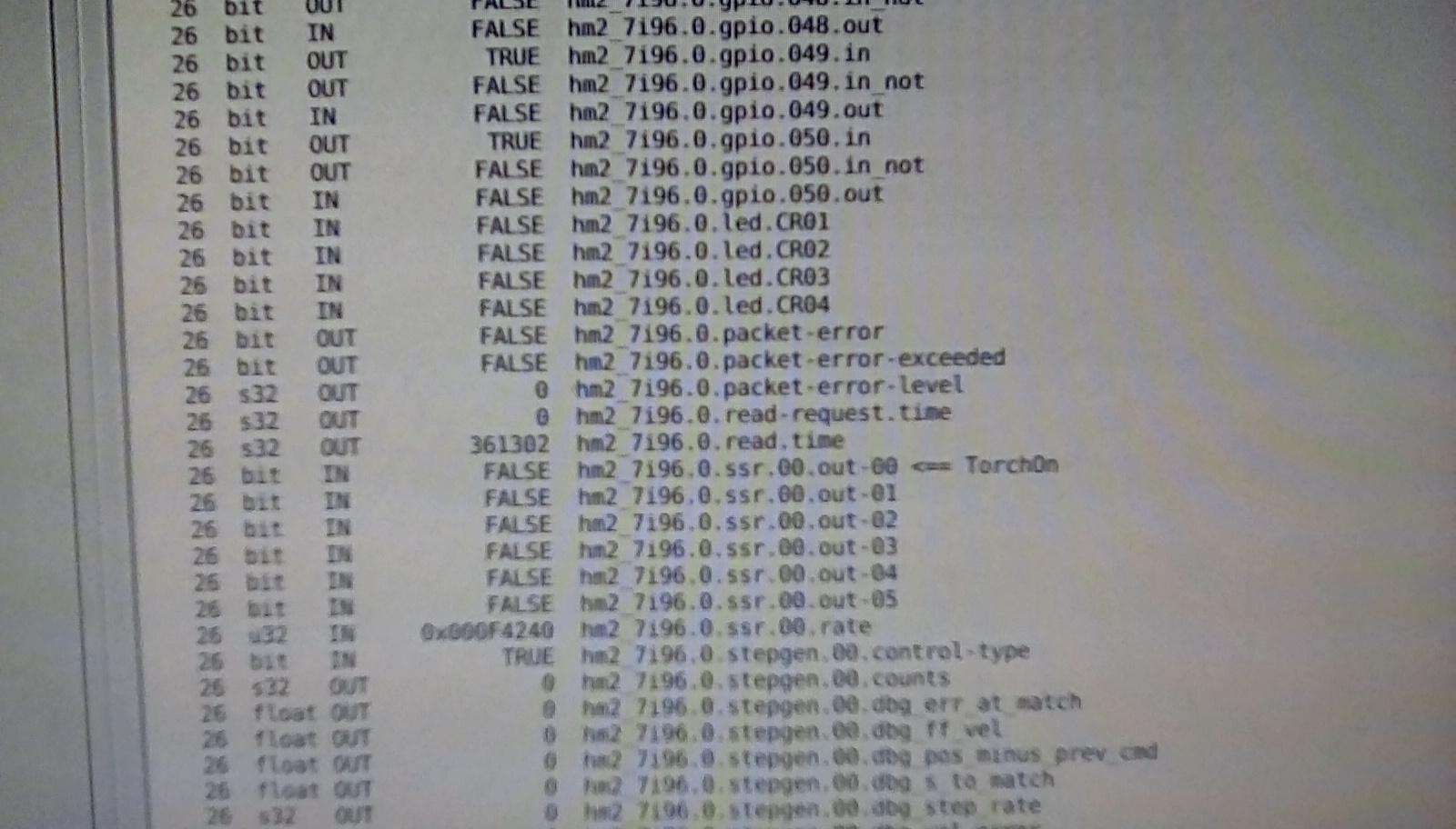

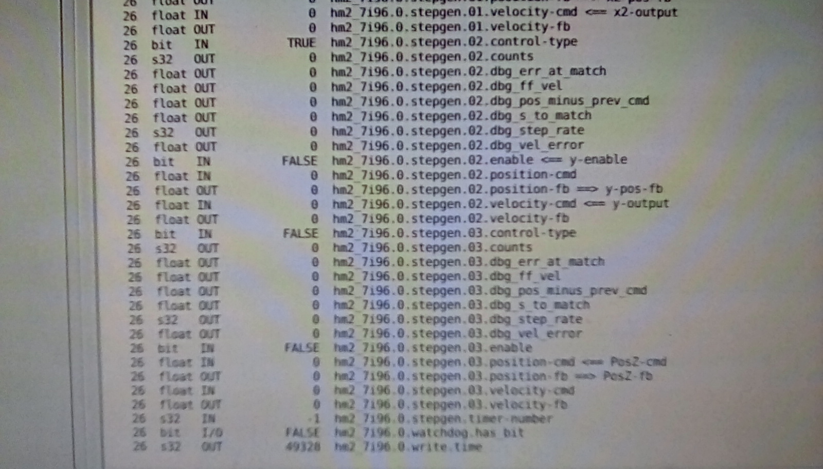

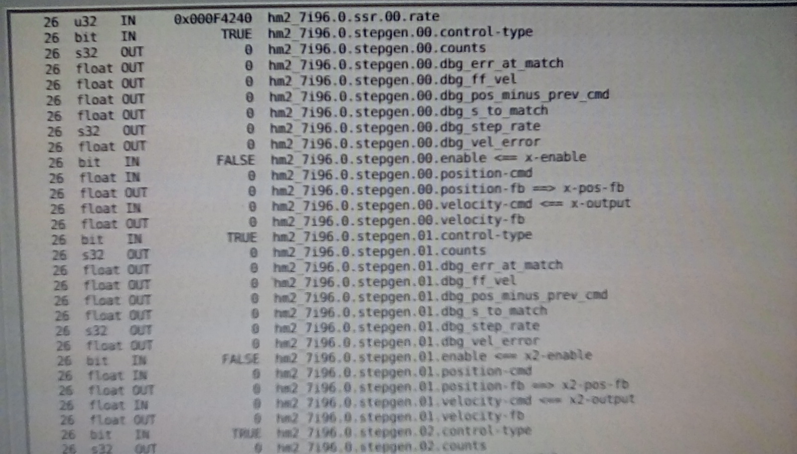

Ok, you must use a relay to start your plasma! Even a HT requires a dry contact closure to correctly work 100% of the time. You will almost assuredly toast your mesa card trying with out isolation on an offshore manufactured plasma power supply.
What we don't have but need to help is:
1. Error messages or screen dump when you start lcnc from a terminal.
2. Halshow screen dump when looking at the pins of your 7i96, HM2... May take several screens. We need to see every signal connected to TB3.
3. A drawing of the connections between your 7i96 and proma 150. This will help you verify that things are connected the way you think they are.
What is really need is a step by step methodical approach to this, no shotgunning if you hope to succeed.
What I can tell from posts is now you can jog under control all three axis X,Y,Z. You can home at least X and Y. Can you jog Z and see your float switch react correctly? Do the signals from the proma measured with a multimeter at TB3 make sense?

Please take the time to read what has been said about your wiring. You are set up to use active high inputs (Pin 12 connected to -24V)
So you need to connect the Proma common to +24v.
Replied by rodw on topic Snuggly's Plasma Build
Current wiring
TB3:
8 = z float
9 = Arc-OK
10 = Down
11 = Up
12 = Common --> -24v
13 = Torch Relay -
14 = Torch Relay +
Proma common --> PSU ground
The following user(s) said Thank You: tommylight, snugglylovemuffin

@Islander 261: Noted, I was just curious to know if a relay is necessary; now I know it is. I haven't experienced any error messages on launch lately, just no movement. I will make a screenshot of all the HM2 ports and draw up a wiring diagram from the Proma. I can jog each axis and home X and Y but I cannot home Z.

Since the 7I96 has a single input common for all 11 inputs, you must wire the Proma common pin the same as the limit switch common.
That is, if you wire 7I96 input common (TB3 pin12) to +24V, the common of the limit switches and the Proma must be 24V common (-24V)

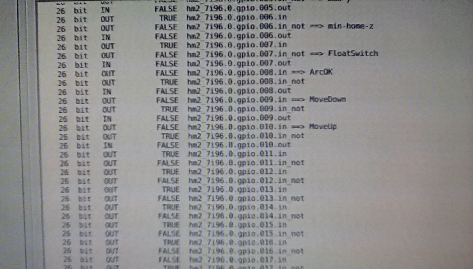

@Islander261: yes, I have an independent min-home-2 switch.
I am getting a "joint_3_limit" error when my float switch is activated
Pin 33 is switching on an off randomly, probably a problem with the board itself so I'm not too concerned with it.

If you mean GPIO33, its expected to toggle at 1 MHz so reading it in hal will result in random true/false data
