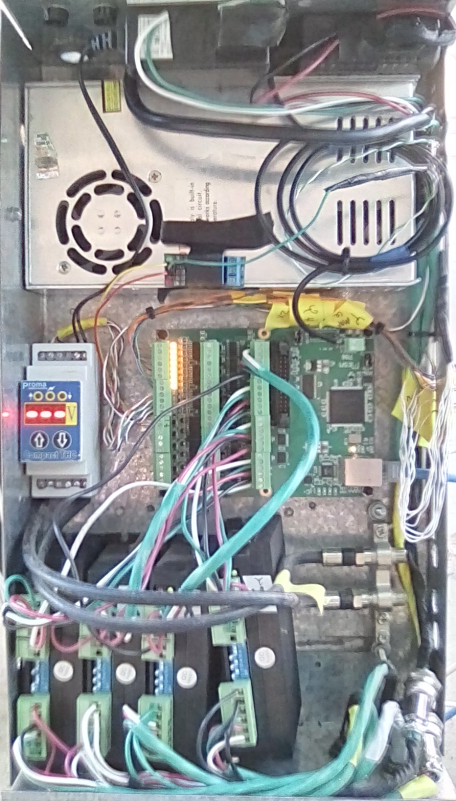

Ok, on your limit switches is the common contact connected to +24V and the NC contact connected to 7i96 TB3 Pin X? Is your float switch connected the same way?
You didn't show the power supply connections to your 150. You must use an independent power supply for your 150 that isn't connected to anything else in you system except the AC input.

@Islander261, So I need to get a completely new PSU to run my Proma? That's weird... The common, pin12, is currently connected to -24V, and my +24V is being directly applied to the switches. I can easily swap these out if necessary. All of my switches, including my float switch are connected this way.

You've got 3 people telling you what to do (PCW, TommyLight and myself) and you are ignoring us. we can't help if you don't follow our instructions.
Change the COM in this picture to +12volt
Your 7i96 is set for active high signals so inputs require +24v so you need to give the Proma +24v to send to the inputs.

Ok, as I understand the admittedly sparse Proma manual the 150's power supply must not be connected to the output or any other circuitry. Rod is correct the common on the Proma output needs to be connected +24V like the rest of your switches.
One other question is the Z homing switch at the top (away from material) of the motion? I am assuming the at the Z jog commands move the correct direction.

@rodw; it's not that I'm not listening, that's just how I had it set up. I don't have a 12v power supply hanging out and I want to make sure that I can't run it off of the 24v power supply that I have before I spend money buying one.
@Islander261: got it, I'll order up a new PSU specifically for the Proma as well as a computer case for all my electronics.
The z axis is stepping in the correct direction but it does not home yet; I'm working on getting that to work. Thank you.

The Proma manual says its good for 7-35 volts so 24 volts is within that range.

Just go to your local dump and get a 12 to 24V, 1A wall wart from the e-waste barrel (power supply from ethernet switch, router or modem should work if the voltage is in the correct range). This doesn't need to be fancy.

UPDATE #2: Proma hooked up to 12v independent PSU, w/ common to TB3 pin 12 = no signal whatsoever under testing conditions.

Again, it will not work like that.
Common on THC to +24V, common on 7i96 to 24V GND
OR
Common on THC to 24V GND, common on 7i96 to +24V
No need for a separate power supply for the Proma THC, it will work just fine with whatever is powering the rest of the system.
