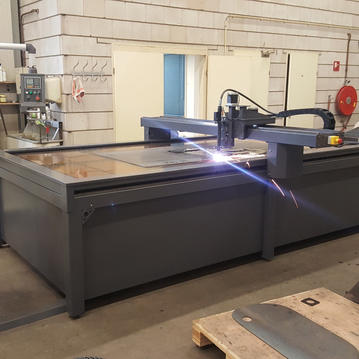

Replied by snugglylovemuffin on topic Snuggly's Plasma Build
I checked the resistance between the TB3 and the Proma. I checked the resistance on the pins and they were all under 2 ohms and they're all connected up properly.
pin7 = arc-ok
pin8 = down
pin9 = up
pin10 = common to ground
All of the inputs from the proma to the board are blinking in pyvcp while the LEDs on the proma are steady on/off; so there are two potential problems from what I can tell; either I need to debounce the signal inputs or change the ground coming off the 150's common pin, which is currently going straight to the PSU's ground.
I'll try the latter option first as I'm not fully aware of how to debounce the signals from the proma (I think Toma does have a function for that though, I'll check here soon)

If you set for example 5 volt on the common line of the thc, in your case pin 10.
You get out :
pin7 = arc-ok ( +5v when triggered )
pin8 = down ( +5v when triggered )
pin9 = up ( +5v when triggered )
So common works like a relais. Try this yourself.

What the 7I96 input common (TB3 pin 12) connected to?
If you have the Proma common pin connected to the low side of the control power you would expect this kind of wiring:
+24V --> 7I96 input common
7i96input --> Proma Arc-ok
Proma common --> 24V power common
Last edit: 08 Dec 2018 16:43 by PCW.

I think Grotius has solved your problem.
Looking at the proma manual its written for a parallel port system which usually switches active low.
The mesa cards are active high.
Now don't do this without confirmation from Tommy or Grotius as I don't want to blow up anything on your hardware but I think your Proma Common terminal should be connected to +24 volt (or what ever voltage you are using for input pins on your 7i96).
So then when the contacts in the Proma close, they will send +24v to your input pins.
Grotius, Tommy, I've never used a Proma. Is it OK to do this?

The 7I96 has 11 isolated inputs and 6 isolated outputs. All 11 Isolated inputs have
a common pin. This common pin must be connected to ground for active high inputs and
connected to the I/O power for active low inputs. The 6 isolated outputs are completely
floating switches so can be use for pull-up/pull-down and mixed voltage switching.
So it sounds like there could be a wiring error. The Proma Ground should be attached to TB3 Pin 12 not to his Power supply GND (unless its connected to TB3 Pin 12).

There is no normal circumstance where you would wire the Proma common to the 7I96 input common
If you are using active low inputs you would wire the 7I96 input common to +12 or +24V
and connect the 7i96 inputs to the low side (common ) of the power source to activate
In this circumstance, the Proma common would be the power supply common
If you are using active high inputs you would wire the 7I96 input common to power supply common
and connect the 7I96 inputs to the power supply high side (+12 or +24V) to activate.
In this circumstance you would wire the Proma common to +12/+24V
