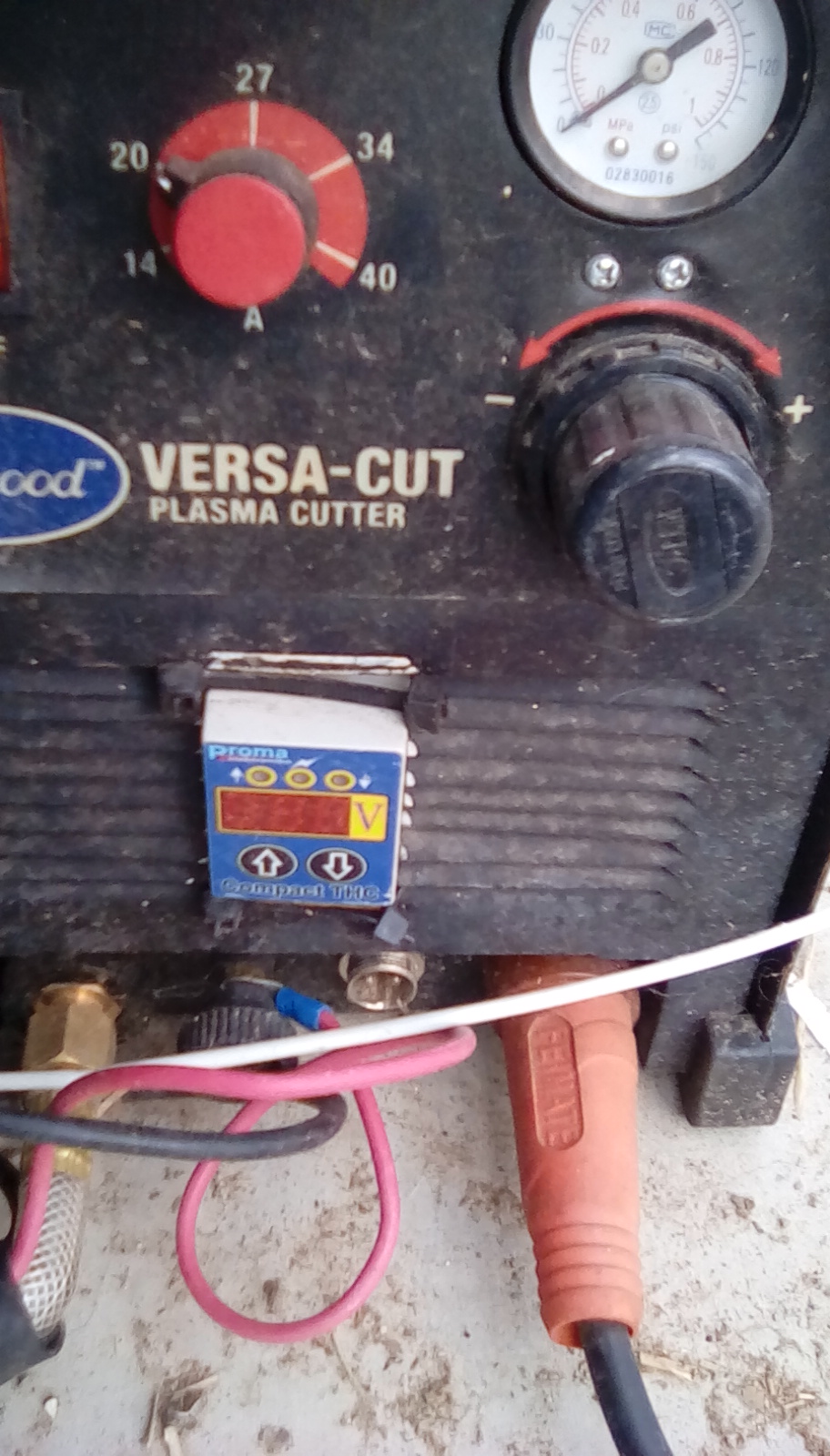

@Tommylight - I have my Proma 150 wired up as Proma directed; negative to the torch, positive to work clamp. I've done all the wiring internally on the plasma cutter to reduce wire length and HF interference.

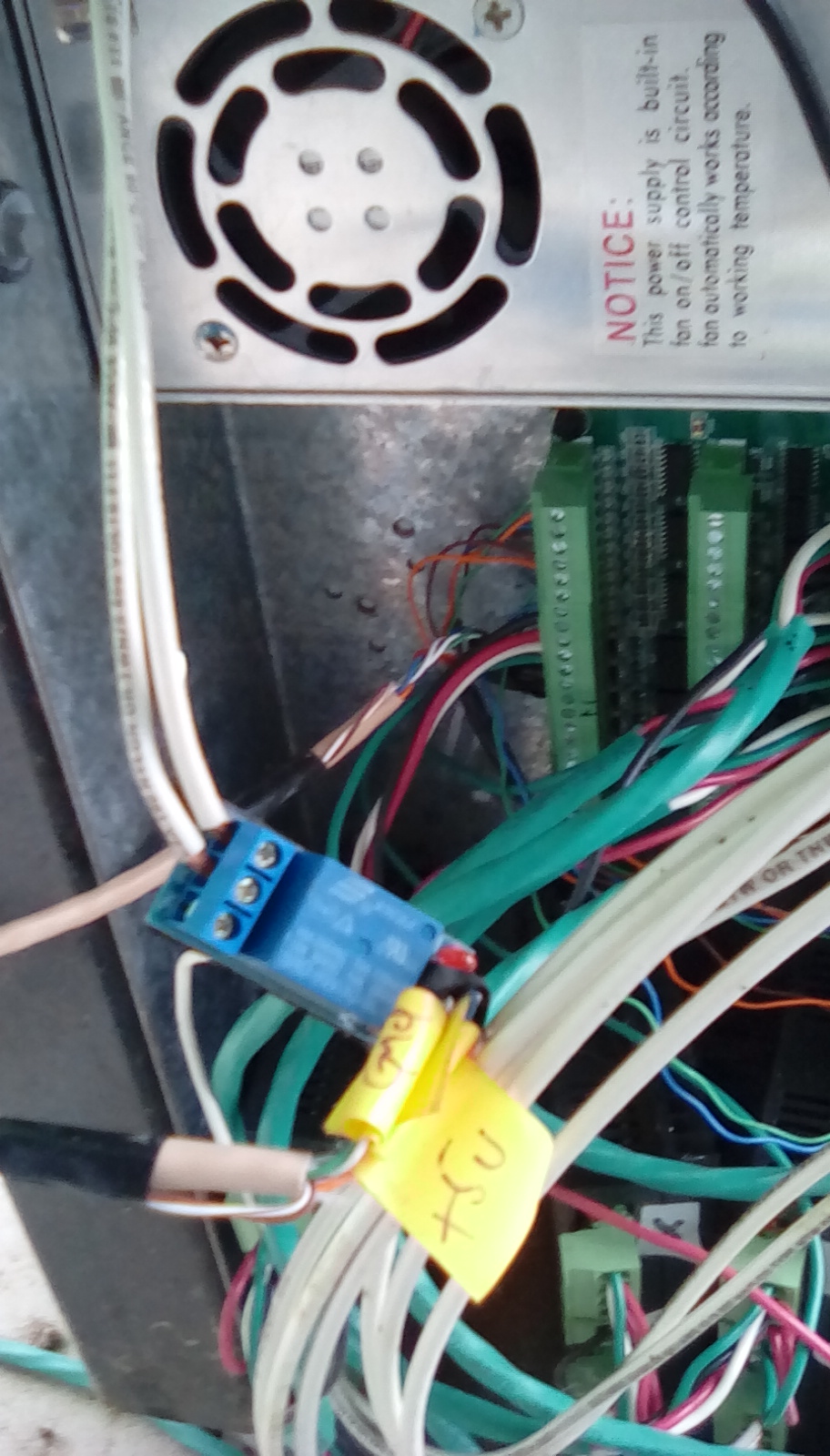

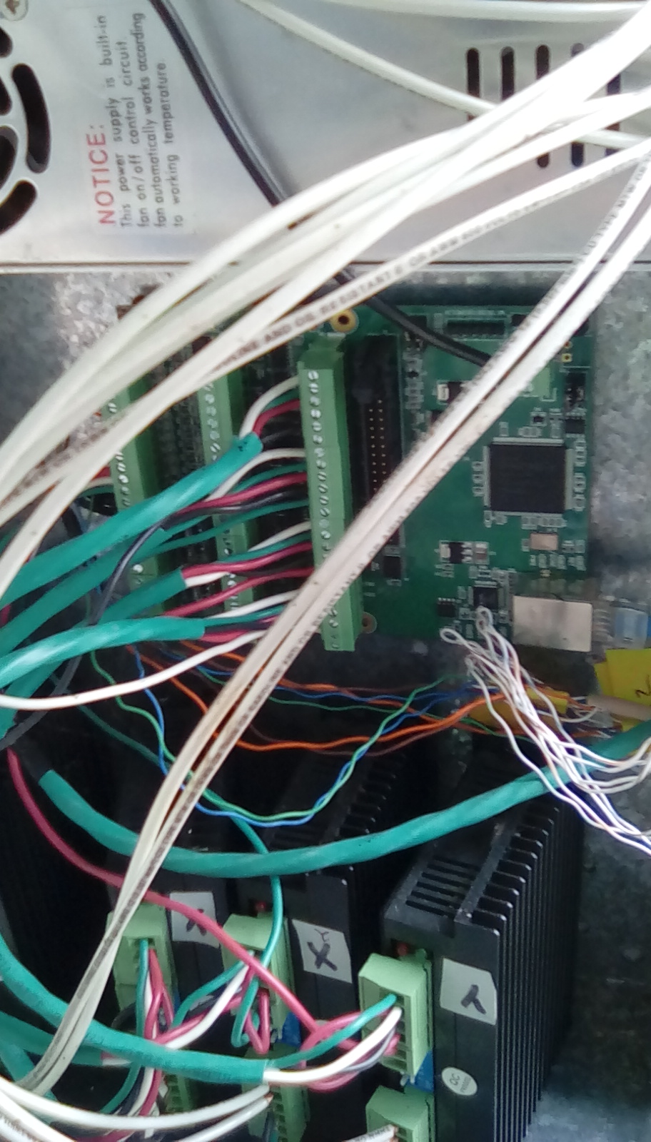

Just a quick peek inside my (grounded) control box

17 Oct 2018 16:15 #118958 by tommylight
Replied by tommylight on topic Snuggly's Plasma Build
Use a shielded cable from control box to the Proma THC, grounded only on the control box side.
Use a simple relay for the probe switch, powered from the same power supply as the drives ( assuming you are using 24V ), or if you do have a 5V one. The probe switch should just turn on that relay, nothing else, the NO side of the relay should be wired to the input of your mesa card. That will eliminate all the interference from the cable going to probe switch.
As a side note, i refrain from putting the Proma THC anywhere near the plasma, i use double shielded cable to wire the output voltage wires to the proma. I am fully aware that if those two wires come near each other all hell will break loose the instance the torch is fired.
I would advise to move the voltage cables from the output terminals and rewire them as near as possible to the capacitors that are used to protect the rectifier inside the plasma. That will help a lot in avoiding interference.

17 Oct 2018 23:15 #118978 by snugglylovemuffin
Replied by snugglylovemuffin on topic Snuggly's Plasma Build
@Tommylight
I'll swap over the proma to the controller box and run a shielded cable to it. I'll see what I can do about adjusting the mounting points of the the voltage cables for the thc, it's a pretty dense unit and it was pretty difficult to get them where they are currently.
My float switch is normally open and I have my relay setup (inside the shielded controller box) as normally open, with pins 13(-) and 14(+) triggering the relay. That would be => hm2_7i96.0.ssr.0.out-00
