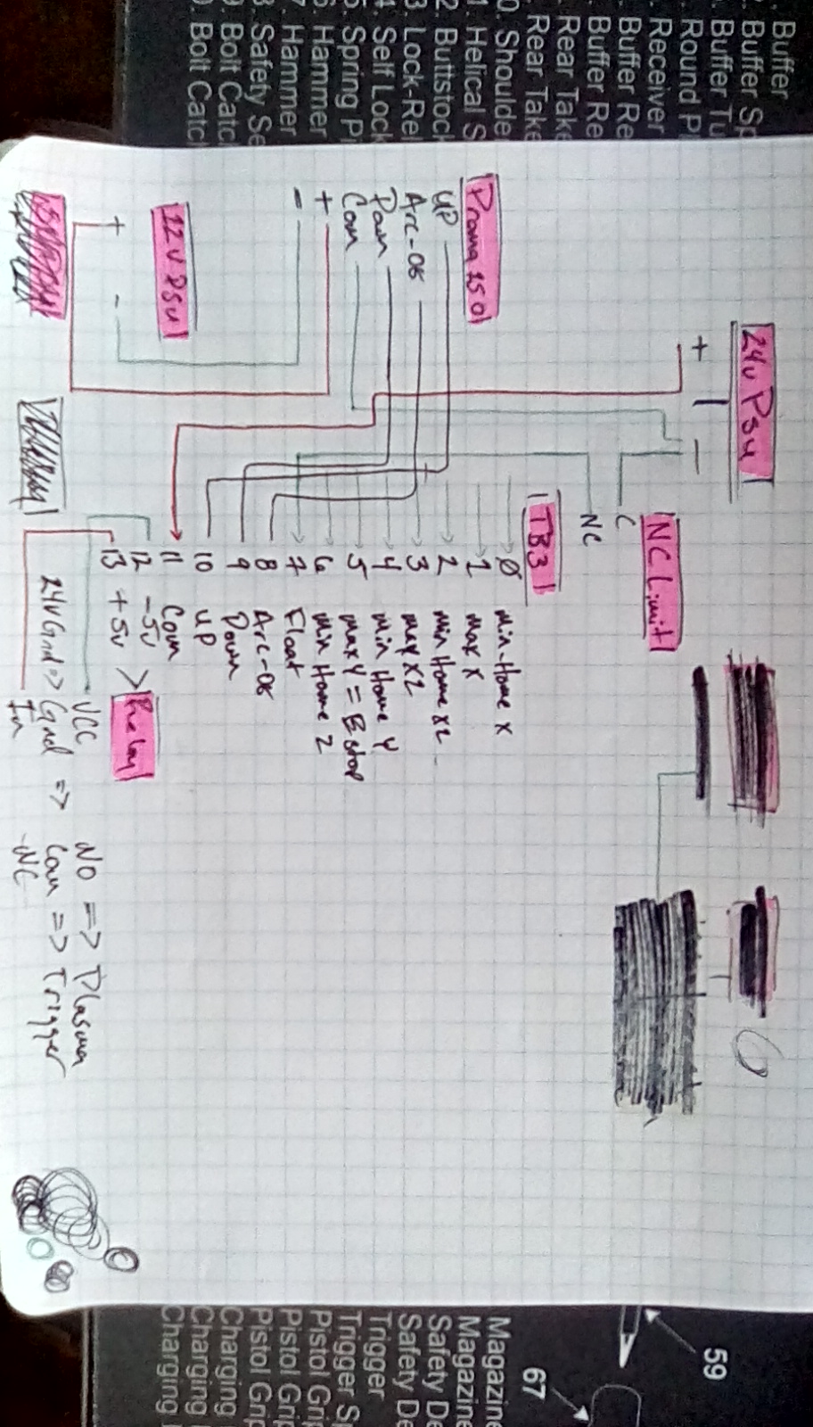

Please make a drawing, videos are really only good for illustrating motion plus they are hard to make notes on to reflect changes.

Pinouts ordered according to soft series. Pins 0-7 are all independen switches wired Normally Closed w/ -24v to Switch COM, and +24V to TB3 COM
Relay is wired directly to the Plasma's trigger circuit as expected.
I'm not worried about z homing, figured it would be nice is all; if it's not going to work I may use it as an estop.
