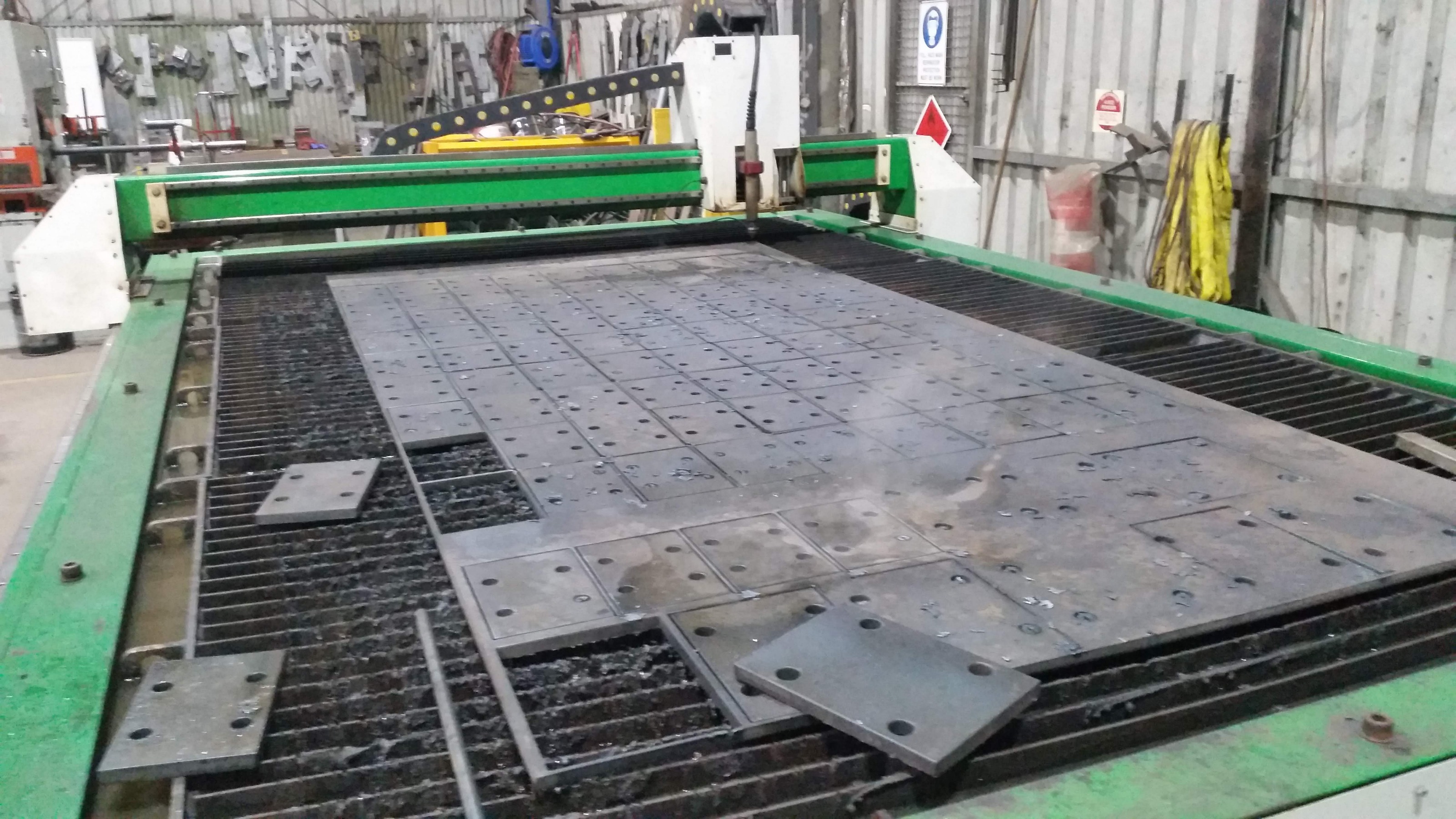

Ok so Ive cut my first productive sheet with the PlasmaC branch,
Everything worked out better than I thought,
My only thing I would change is after a cut the z axis moves to rapid height then for some reason moves up to the home position and then probes.
Why does it move upward from rapid height? I just feel this upward z axis movement is unnecessary and as far as I can tell does not achieve anything.

07 Jul 2019 10:30 - 07 Jul 2019 10:30 #138793 by phillc54
It probably does that because I have never actually seen it cut...
I think you are right, I shall have a look and see what I can do.

07 Jul 2019 23:43 #138827 by phillc54
I have just run a sim here and it doesn't show that behaviour. After an M5 if moves to safe height, rapids to next X/Y position, moves to probe height then probes.
Do you have a really high probe height, if not can you post a screenshot of your Config tab and the GCode several lines either side of an M5 between cuts.

08 Jul 2019 02:16 #138831 by thefabricator03
Replied by thefabricator03 on topic Another plasma component...
[quote="phillc54" post=138793
Yes I checked it and my probe height was 100 but the safe height was 20,
I changes the safe height now the Z returns to its home after a cut,e.g cutting a hole then it will retract fully to 150mm then rapid then probe.
I am cutting a sheet that has 486 parts and it is taking a long time with all of the z axis movement. Is there a way to limit the height it retract to? instead of having it return home every time.
I have a long Z axis, I use that height sometimes to cut holes and slots into RHS so I still need to be able to have my Z height at 150mm.

08 Jul 2019 02:23 #138832 by phillc54
Between cuts on the same job it will retract to the safe height, move to new X/Y pos, move to probe height then probe down.
It only returns to Z max at the end of the job.
So with the figures you quoted, at the end of each cut it would rapid up 20 above the material (safe height), move to the start of the next cut, rapid to 100 above the Z minimum limit (probe height) then probe down.

11 Jul 2019 02:43 #139046 by thefabricator03
Phil,
I am trying to get the z axis to move quicker, I understand that the up and down movements of the z axis are controlled by the velocity and acceleration in the ini.
Please see attached you tube for a example of what is happening,
I have the probe speed set at 900 and the max speed setting set at 900,
How can I get it to move to the next step of motion quicker? As in when it moves up to safe height then move to next x y position and then starts the probe move.

11 Jul 2019 02:51 - 11 Jul 2019 02:53 #139048 by phillc54
Yep, that is slow....
Max Speed is read directly from the ini file.
Setup Speed is the speed that al Z moves are done at except probing and THC.
Probe Speed is the speed for probing down.
THC moves can be up to Max Speed if required (automatically).
If your Max Speed is 900 then that is what the ini file is set at.
Edit 1: BTW I have a new version that won't move up to probe height if probe height is higher than safe height. I haven't pushed it yet.
Edit 2: can you post your ini file

11 Jul 2019 03:18 - 11 Jul 2019 03:24 #139049 by rodw
Replied by rodw on topic Another plasma component...
Stefan, Its possible that you have not got your velocity and acceleration configured right for plasma and external offsets. To understand this, picture a lathe with an external offset being applied by a mathematical formula to machine a lobe on a cam. So the lathe is blindly spinning around with the cut diameter set to a fixed diameter and the external offset moves the tool in and out to machine the cam. So we need to allocate some portion of the axis velocity and acceleration to external offsets or the tool can't move. Thats where the ini variable OFFSET_AV_RATIO comes in. Say we decide we need to allocate 20% of the vel and accel to the external offset. We set this equal to 0.2. The consequence of this is that your rmaximum vel and accel is only 80% of what it could be.
So with plasma we do a trick and we can only do this becasue the THC and jogging of the Z axis are 100% mutually exclusive.
What I worked out before the external offsets was released we could double our ini file settings for vel and accel and apply
OFFSET_AV_RATIO = 0.5
That way the maximum vel and accel will be available for both probing and THC.
So Its possible you have got the ratio set to 0.5 but have not doubled your VEL and Accel.
After much testing and cursing over missed steps I have my 2 x vel and accel numbers for a NEMA 23 stepper set at 120 and 1400 (which is really 60 and 700)

11 Jul 2019 05:13 #139060 by thefabricator03
Thanks for your help guys,
As what Rod posted I had both sets of Velocity and Acceleration set to the same number, I did not read the ini closely enough and did not realize I needed to double the first set of numbers.
It cutting much faster, I just need to set up the THC off before the end of cut in sheetcam because the torch is diving at the end of cut and tripping the probe limit switch.
