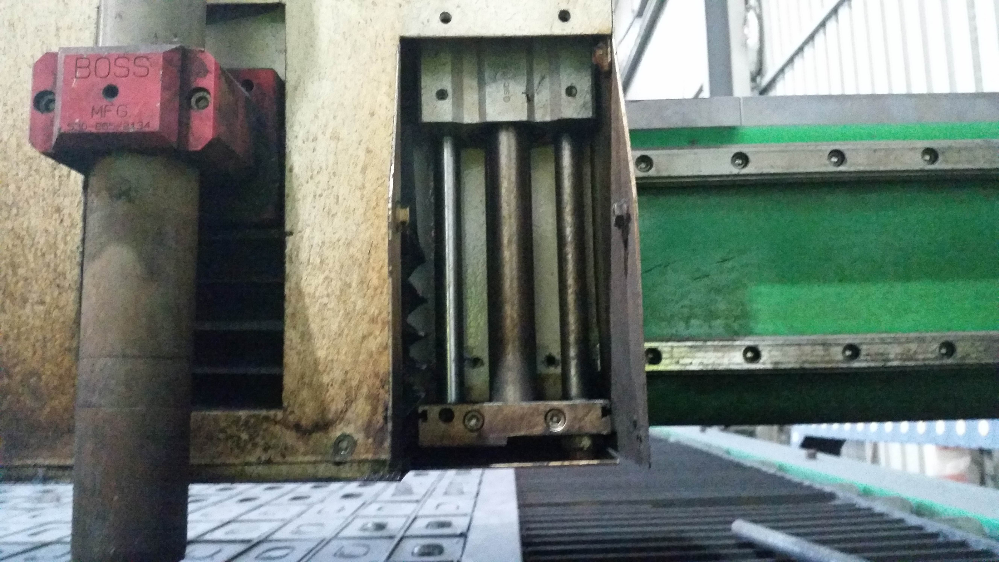

Just explaining my CAD file for a moment as it might be hard to see. The air ram I have has a threaded end on the cylinder so it screws into a bracket affixed to the backing plate. The HGR15 carriage is also attached to the same backing plate. The pen is held in a bracket attached to the end of the HGR15 which also accepts the air ram so when it fires, the ram shoots down instantaneously. The air ram air pressure determines how much down force is applied. The engraver probably runs at a more normal 90pis and just vibrates like crazy. So there is still no Z axis movement required.

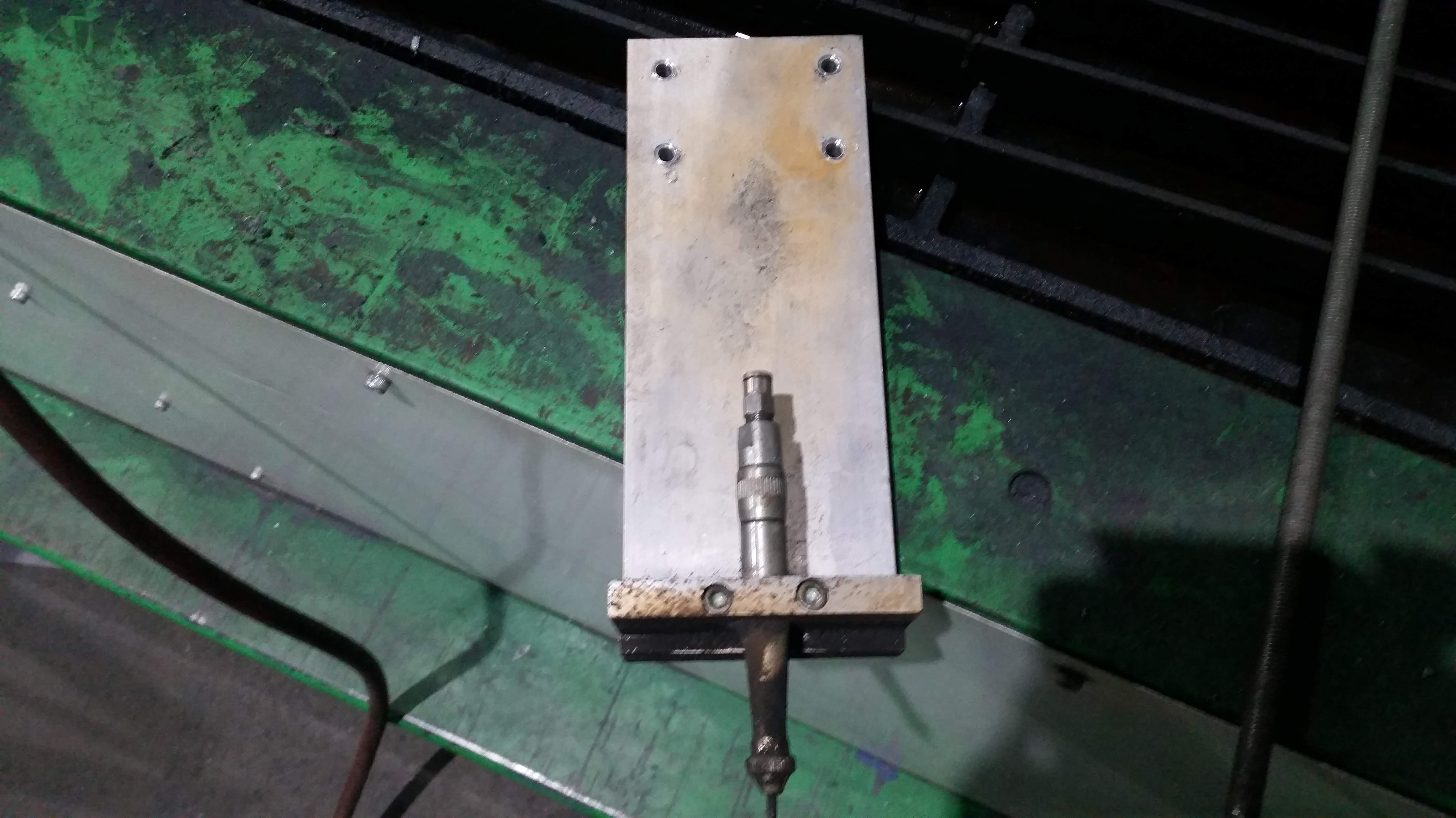

This is the air ram that moved the scribe up and down, Just a Pneumatic z axis,
The Chicago Pneumatic scribe mounted to a aluminum mounting plate.

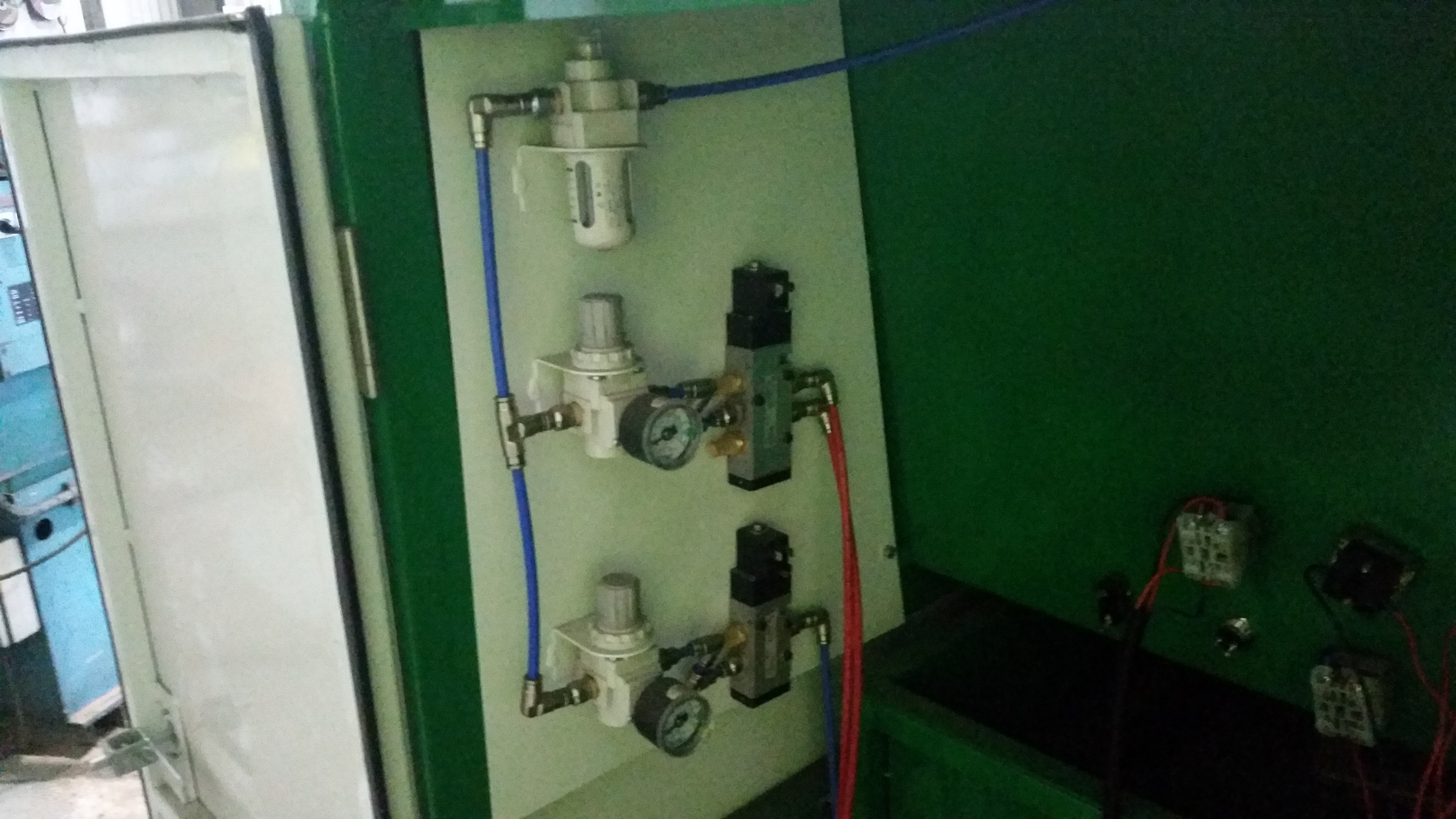

All of the hardware to make it work, Oiler first then pressure regulators and solenoids.
