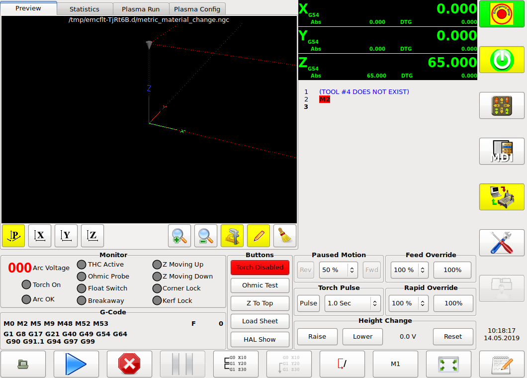

So thinking post processors here, does plasmac return any error codes if a tool is not found or doe it just timeout?
At the moment no, how about something like this on program load:
I also noticed the extra F words in the code you posted, I like the pic and the video.
Cheers, Phill.

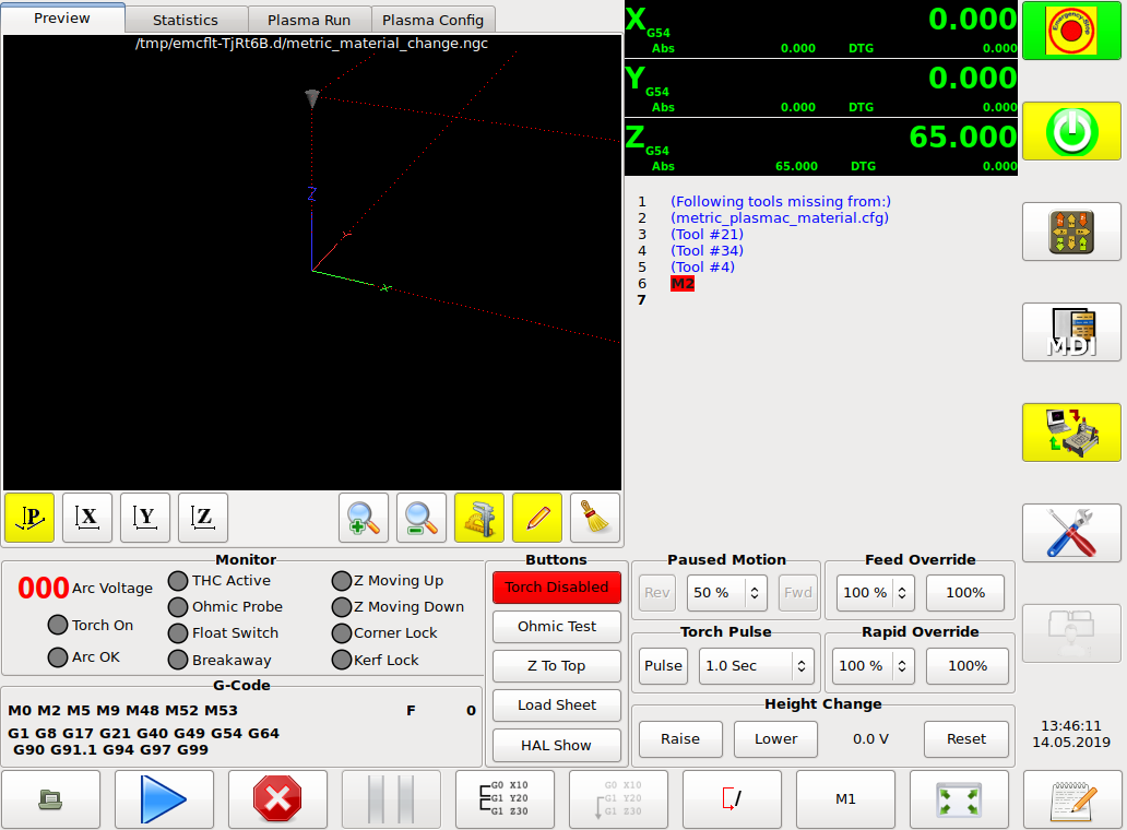

14 May 2019 03:49 - 14 May 2019 04:05 #133678 by phillc54
I think I prefer this way.
The gcode file is completely parsed before loading then it reports all tools that are not found and stops the program from loading.
It also makes for a cleaner gcode file as no code is required.
Warning: Spoiler!
Cheers, Phill.
Edit: replace the plasmac_gcode.py in you config file with this one to give it a try. You shouldn't need to restart LinuxCNC.
Last edit: 14 May 2019 04:05 by phillc54.

14 May 2019 04:05 #133681 by rodw
Replied by rodw on topic Another plasma component...
Cheers, Phill.

14 May 2019 04:07 #133682 by phillc54
I should have waited, I had just attached it for you to try here
Cheers, Phill.
