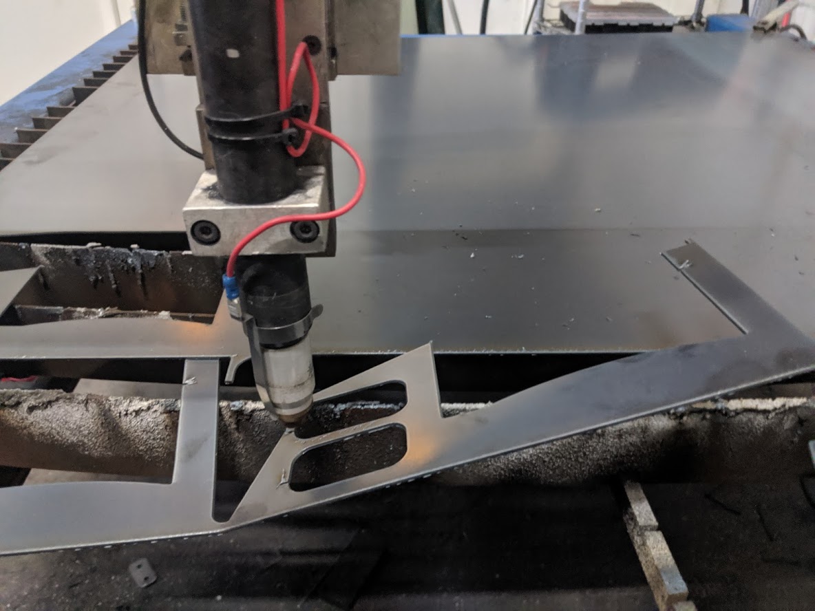

13 May 2019 06:54 #133623 by rodw
Replied by rodw on topic Another plasma component...
Sorry, I thought I was taking a video but here is just a sample of how good Plasmac's THC is in case there are any doubters.
Yes we cut the part out at the back at 2219mm per minute, standard THC settings with the material cocked up exactly as you see it there...
