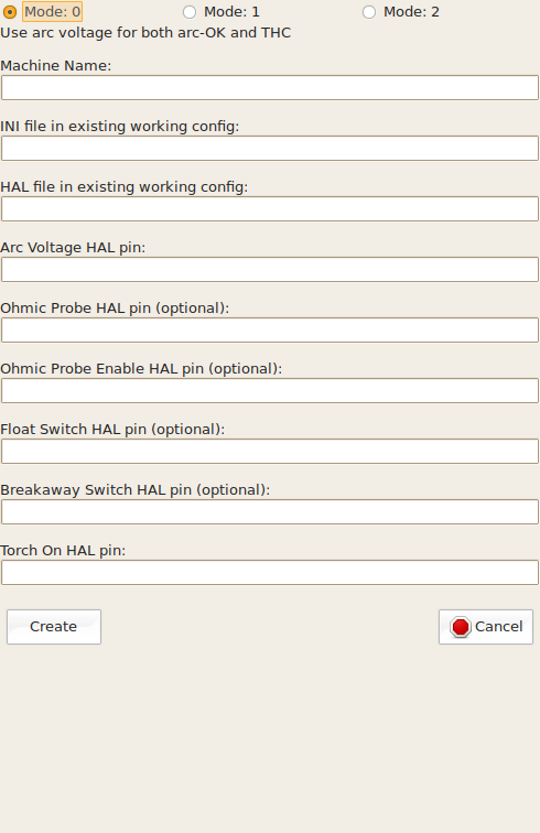

17 May 2019 09:18 - 18 May 2019 06:15 #134038
by phillc54
I have pushed an update, it is a configurator that will (or should) create a complete plasmac configuration.
It doesn't affect plasmac so if you have a working config then there is no need to update.
I have attached a copy if you would like to try it without updating.
Before running this application you need to have:
1. a working machine config.
2. a local clone of the plasmac repo.
Double click on configurator.py in the configs/sim/gmoccapy/plasmac directory and follow the prompts.
The configurator.py MUST remain in the configs/sim/gmoccapy/plasmac directory so it knows where to copy the plasmac files from.
It creates a sub directory in ~/linuxcnc/configs named {machine_name} and writes a {machine_name}.ini and {machine_name}.hal file in that directory.
I makes a backup copy of the original HAL and INI files in the above folder.
It creates a {machine_name}_connections.hal file for the connections between plasmac and the original config. This moves the connections/comments from plasmac.hal to allow it to be overwritten by an upgrade.It copies all the plasmac application files to the new directory.
It also leaves the original HAL and INI files untouched so they could be changed and the configurator could be run to rebuild the config.
It shows only the relevant HAL connections for the selected mode.
It can also be used to upgrade an existing config, although it probably shouldn't be used to update a config that wasn't built by the configurator.
Cheers, Phill.
