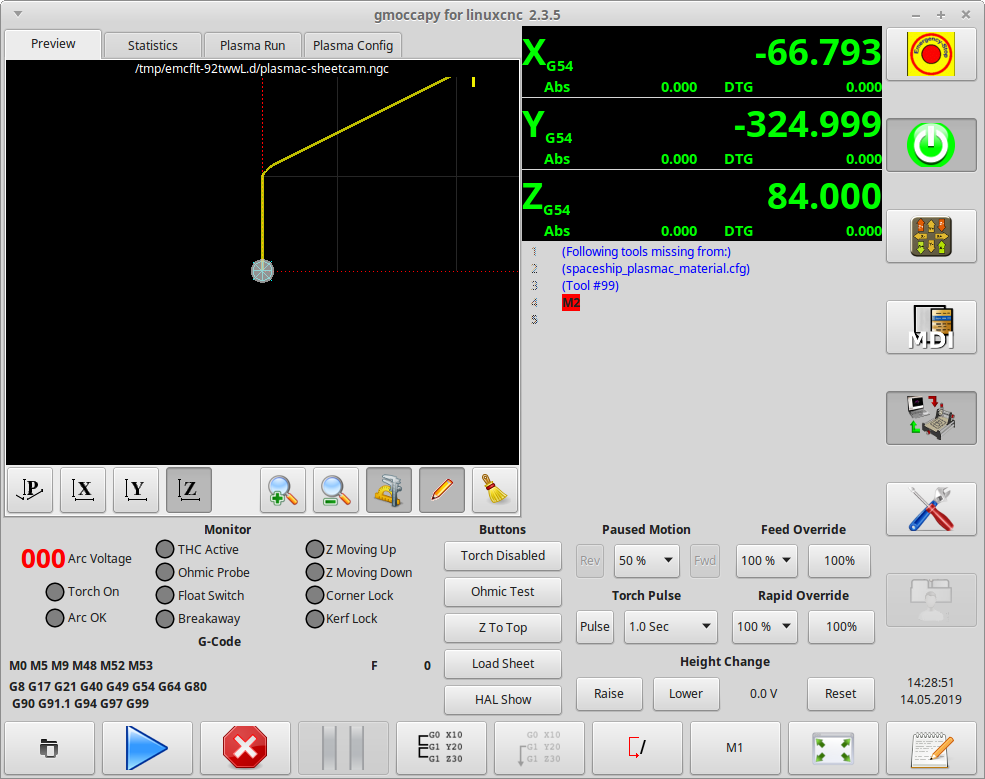

by phillc54
Rod,
Could you post the gcode file you were trying to load.

14 May 2019 04:30 #133685
No Need
You are not allowing for comments so probably should throw away anything after a ( or a ; to be more robust.)

14 May 2019 04:31 #133686
by phillc54
OK, replace line 24 with:
a,b = line.lower().strip().split('p',1)Please Log in or Create an account to join the conversation.

14 May 2019 05:07 #133688
Replied by rodw on topic Another plasma component...
Perfect thanks Phill, I had to put my comments back into the post!
For those following, I've attached a zip file containing the post, the output and a dxf file to practice with.
Make a new tool called CenterPunch, create a new layer called holes, move the holes to that layer. apply a drill operation with the CenterPunch tool. Make sure the min and max hole is big enough in that operation 12mm or 1/2" should do.
Then add a plasma tool on the remaining elements on the base layer and run the post processor
There are a couple of G1's and G0's on a line on their own. This is a Sheetcam thing and the files cut fine.

14 May 2019 06:09 #133694
by phillc54
I have pushed yet more updates, just trying to keep you guys on your toes...
You will need to run make after pulling these.
Report if material is not found, modified file:If you get an error, ensure this file is executable
Change kerf crossing calculations, modified files:
Disable IHS Skip after an error, modified file:
Cheers, Phill.

14 May 2019 06:54 - 14 May 2019 06:55 #133702
Phill, you forgot this in plasmac_gcode.py
But I have it going now!
#first, last = line.lower().strip().split('p')
first,last = line.lower().strip().split('p',1) But I have it going now!
