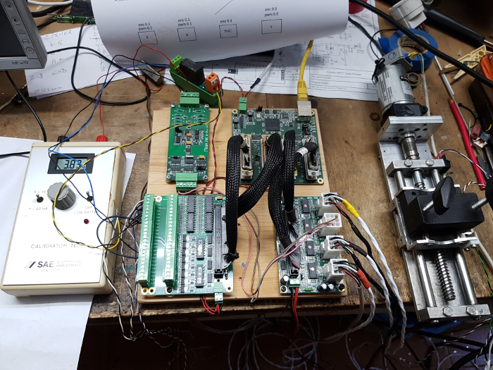

23 May 2019 07:16 #134668
by billykid
Replied by billykid on topic Another plasma component...
well now everything works .. I put a relay on torch-on that closes arc-ok and the entrance to the thcad so by adjusting the voltage the z axis goes up and down.
now I have to mount it on the small cnc with an inteco eagle 35 plasma without hf.
thank you
mauro
if you want to laugh, here is the photo of my test bench
thank you
mauro
