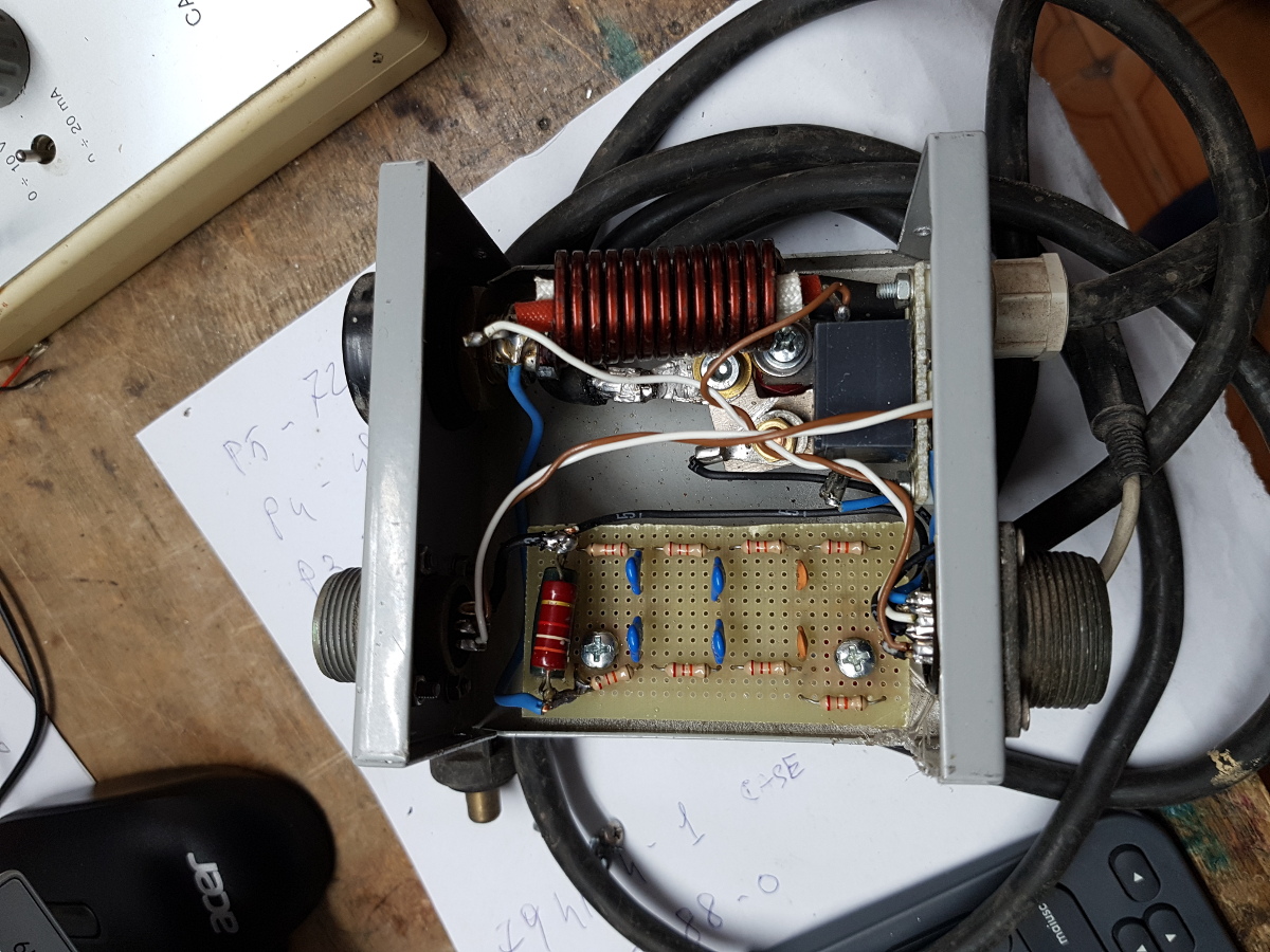

24 May 2019 08:05 - 24 May 2019 08:26 #134786 by billykid
Replied by billykid on topic Another plasma component...
but then it is the same as mine! about 700 x 600 mm
I'm doing it for fun now that I've stopped working :-)
my generator has the pneumatic torch as a trigger and not a problem, already used with linuxcnc and parallel port and a self-built analogue thc.
you will have to be careful with the high frequency, insert the torch cables into a shield sock.
for the signals without going inside the generator I made a small metal box with current sensor on branch + (ground) and the torch on relay and voltage divider, so the plasma remains usable even manually changing the torch with its original coupling.
