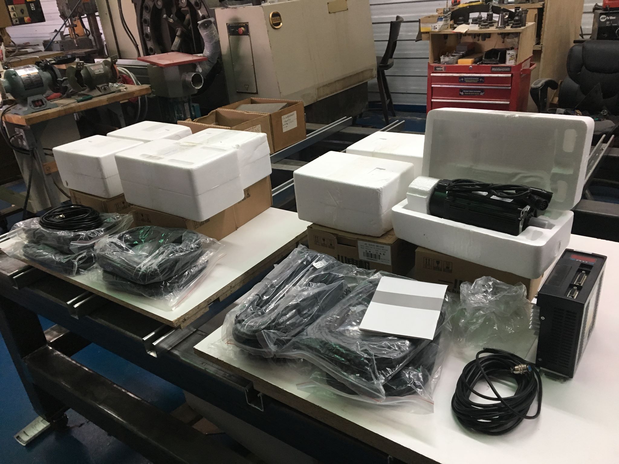

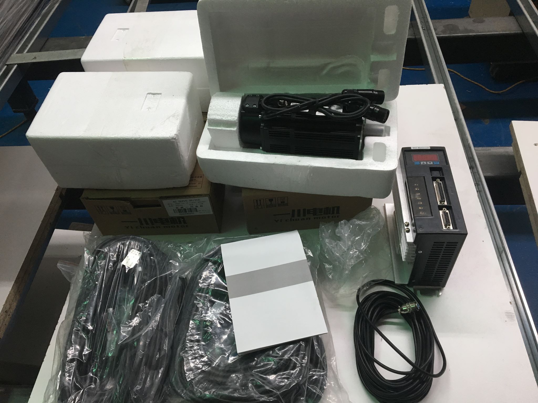

03 Jun 2019 20:23 #135793
by bevins
Replied by bevins on topic Bob's Plasmac Build
- thefabricator03
- Visitor
03 Jun 2019 21:40 #135800
by thefabricator03
Replied by thefabricator03 on topic Bob's Plasmac Build
What brand are those AC servos?
They look similar to what I have been looking at from China.
