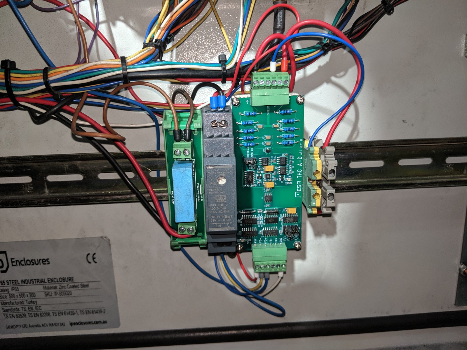

But hang on, how were we going to add an extra THCAD to a 7i76e that only has one encoder input? Well an encoder input has an A input, a B input and an Index input. The THCAD requires an Encoder A input. I asked Peter about this and he said he had been thinking about making new firmware that included two more encoder A inputs on the B and Index pins. I reminded him he had already done half of the job because he'd placed the encodea A input on the B input for me after I smoked a THCAD and the input it was attached to. So sure enough by the time I got around to wiring some stuff up in a temporary fashion, Mesa had released new firmware for the 7i76e and the 7i92 with 3 encoder A inputs. These bit files are available for download from the Mesa website and their file names end in "pl.bit"
So the first attempt was a bit of a failure so we regrouped and with a bit of coaching from PCW, we came up with a workable circuit which is outlined in a PDF file attached here. I settled on a 390k scaling resistor which gave a full scale of 24.5 volts on the THCAD-5. I deliberately set this a bit higher than the 24 volt power supply I used and figured if we saw a full scale voltage, the arc was on.

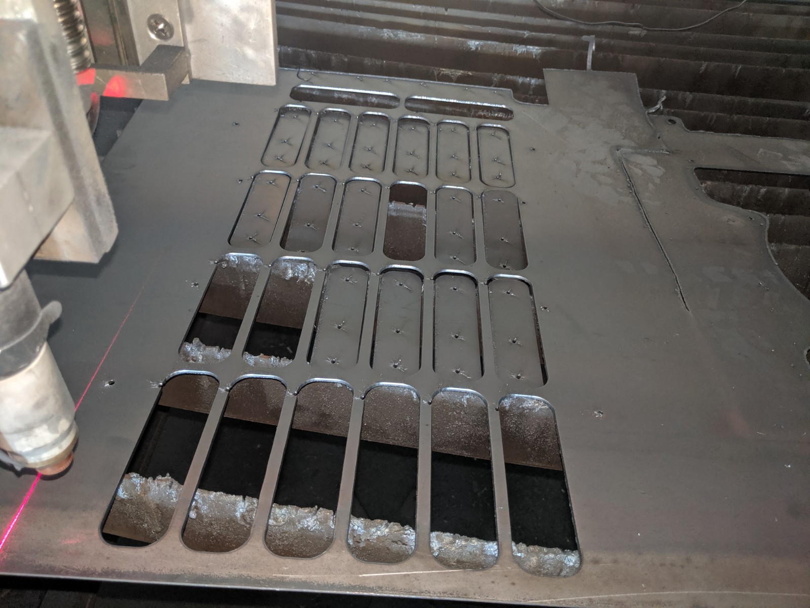

So at this point with wires hanging everywhere and the power supply plugged into a separate power point, I decided it was time to give it ago on a test job with 110 pierces
And it worked! I could even see when the arc was cutting! The time Plasmac took lifting the torch up in hte final part of the probe seemed to be much faster. I think this must say that the THCAD is triggering the probe much faster than a laggy relay.

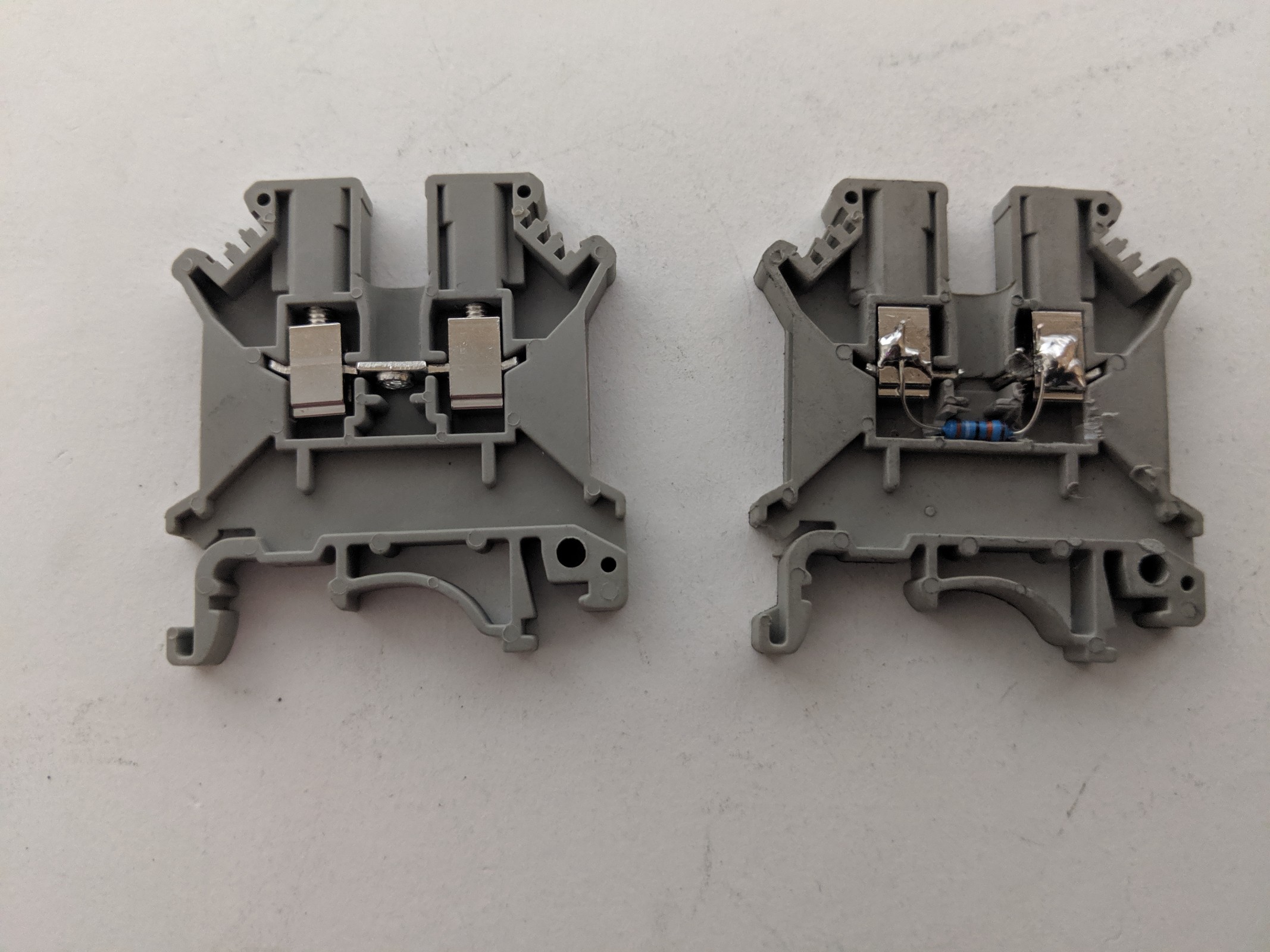

I decided to mount the scaling resistor in a DIN rail terminal block which made things fairly neat.

So to be 100% clear an "isolated" psu means what exactly? Does that mean don't use the same 24v psu I'm using for the rest of my electronics?
What are the pros/cons of using the optional relay? Finally, any reason you have the relay on the AC side of the psu rather than something on the DC side, maintain isolation?

I have wired mine up but not set it up yet,
The isolated PSU means using a single PSU just for the Ohmic circuit.
Rod has mentioned to me in a email that the optional relay was not necessary after some testing he did.

More over, where is the second thcad?
