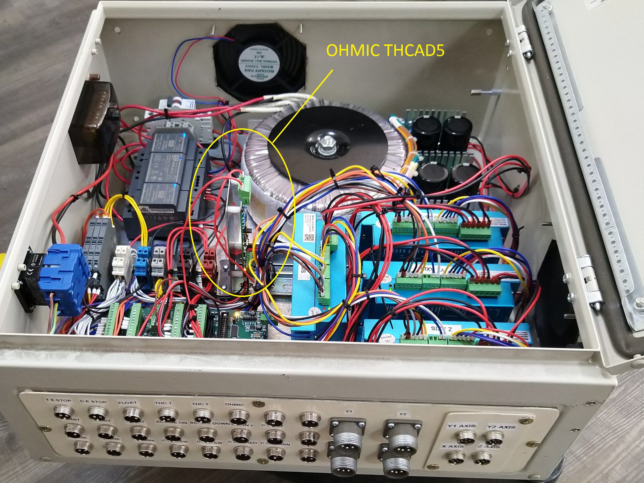

I mounted mine in my control cabinet vertically,
Replied by thefabricator03 on topic Hypersensing with THCAD - better way to do ohmic sensing
More over, where is the second thcad?

We cut 2 sheets of 2mm steel last week and everything worked pretty perfect. Sometimes the torch would get a splash of water and sense the material far too high, but it is just a matter of hitting pause and restarting so Plasmac's error recovery kicks in and sorts it out. Once or twice water got up the nozzle and the probe came on when it shouldn't. That is the purpose of the ohmic test button (to diagnose this condition). Eventually, I worked out the easiest way to fix this was to turn on the torch air flow on the plasma machine console to dry it out and then hit resume in plasmac. My Thermal Dynamics has a manual air pressure regulator which is set with the air flowing. I'm not sure if others have this feature but Plasmac has the answer as you can use the torch pulse function to achieve the same thing.
Replied by rodw on topic Hypersensing with THCAD - better way to do ohmic sensing
On my machine, the real arc voltage THCAD is buried elsewhere in the control box beside the 7i76e The one in the photo is mounted on the door via a DIN rail just for hypersensing so the photo shows everything you need as per the circuit diagram.More over, where is the second thcad?
