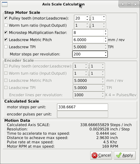

I started from scratch on the computer and resinstalled linuxcnc, updated to the master branch. The first go I had followed someone else's instructions. As I said before, the movement would get choppy or sputter as it would wait to change directions. After the reinstall following the plasmac guide, the movement is now smooth as silk...and no sputtering (I don't know the technical jargon).
Now I'm just trying to get the X-axis to move the correct distance. I'm confused, as although I selected 'inches', in the pncconf it asks for thread pitch in mm/rev (I have a 20 tooth pulley, 3mm pitch). I'm assuming that in the block titled "Leadscrew Metric Pitch ... " this is where you tell it how far it should move with my pulley and belt?

Start Linuxcnc, home the machine, measure the distance, press F5 to get the MDI tab, enter a known value and measure again, back to 0 on the MDI. While you are doing this, use the "calibration" from the machine menu, there you can enter the scale values and test in real time, without the need to restart Linuxcnc. When you are done, click on OK and save to file.

What microstepping are you using, what type of motion, what size pulley's, etc ?

I think my trouble (due to being unfamiliar with this at all) is that no reference material actually shows how to do this on a Mesa card in master branch, for example most things I see are stepconf instructionals running on 2.7.14, which is very different than what I'm seeing.
Anyway, here is the info:
1/8 microstepping
Motion...do you mean belt drive and using belt as rack? If so, yes that's it. 20T pulley, GT3 belt 3mm pitch on X and Y1/Y2, and leadscrew on Z (8mm leadscrew, 2mm pitch Tr8*8-2p)
Pat
1/8 microstepping

Directly driving a 20 tooth pulley from the motor ?
That will make 60mm for every rotation of the motor and that is to much.
So that will be 200 steps of the motor per revolution times 8 for microstepping equals to 1600 step pulse per revolution.
Since you get 60mm of movement per revolution, the scale should be 1600/60, or how many steps are needed for 1 unit of movement, in this case 1mm.
26.666 is the scale.
Here are the docs, choose the version you are using.
linuxcnc.org/documents/

Between the time I last responded and you posted again, I was tinkering around with it in pncconf. Looks like it needs the pully teeth count entered in a field at the top (in the calculator). I entered some raw math numbers I came up with earlier, and it was actually moving within about .25in of where it should have been. So close!
I went back and entered the scaling you came up with and tested it. It was way out for some reason. I went back and tweaked the pitch numbers and now it's right on the money (2in test movements in pncconf). I absolutely don't understand how it got there, but it falls in with what you told me before...make it work!
