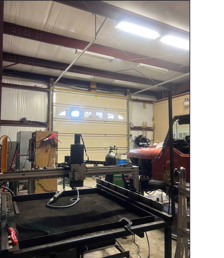

01 Aug 2023 15:38 - 01 Aug 2023 15:40 #276709
by dvn4life1972
Replied by dvn4life1972 on topic My Newb Plasma Table Attempted Build
Hope everyone had been doing well! Been off here for a while, a bunch of life stuff happening, blah blah etc etc. Made a few 'upgrades' to the table recently. Also moved into a shop space where I have everything under one roof, including living quarters. I've been making simple artistic metal sign kind of stuff, and to my surprise that's actually a viable business around here. So before the table was not completely welded. Half of the joints to be welded were completed, just enough to get it up and running. Fast forward a couple of years later and I suspect some of my intermittent program stop errors had to do with table slop. Fortunately after some mearuments, found it to still be square and true. So I welded it all up and it's super rigid, pretty much no wiggle any more. Also modified the feet to be more solid, which seems to have helped with some slop/sway during rapids of 1200ipm.Relocated the electronics box to a more protected area under the water pan. Speaking of the pan, cleaned that out for the first time. Lot of weight removed from the table haha. Fixed a super slow leak in the drain while I was in there. Next round of upgrades will be to integrate the ohmic sensing (thcad-5). I've had the board and whatnot for a couple of years now, it's about time I got to using that stuff.
Last edit: 01 Aug 2023 15:40 by dvn4life1972.
