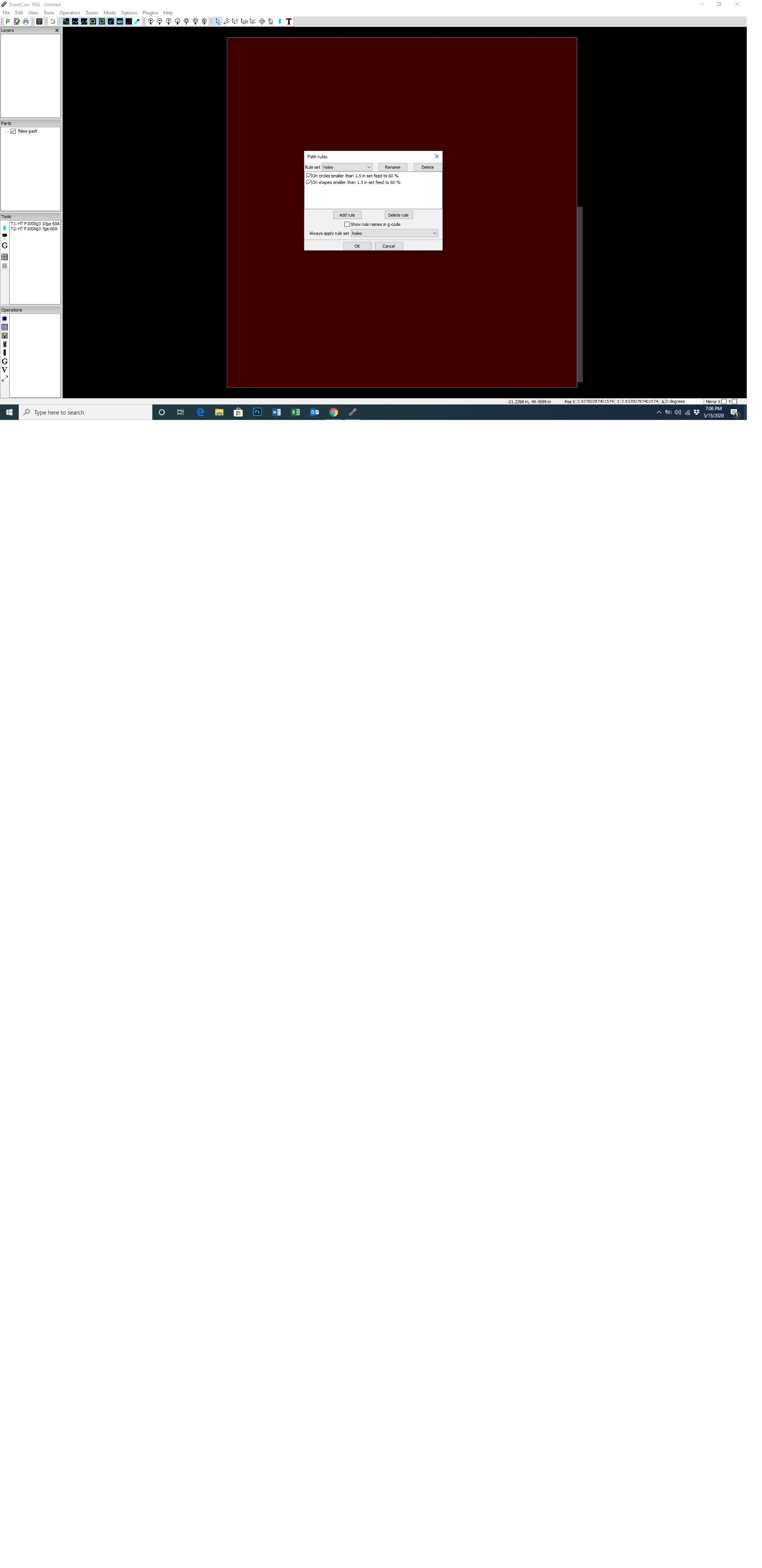

Do you have Use Auto Volts enabled?
There is no slowdown code in that file, you should see something like:
M67 E3 Q60 (reduce feed rate to 60%)
M67 E3 Q0 (restore feed rate to 100%)
...Please Log in or Create an account to join the conversation.

No, Auto Volts is good.
You don't have any code snippets it the tool file. If you double click on "On circles smaller than...." you should get a dialog with a Start Code and End Code that relat to a code snippet.
The are samples here:
forum.linuxcnc.org/plasmac/38438-plasmac-post-processors#158270
You could add that to the end of your tool file and rename the tool numbers.
Can you zip your machine config and post it.

I can't see anything obvious. Tom says he has strange issues if he uses negative values in the Z axis and joint. I have been unable to duplicate it here and "theoretically" there should be no issue but it may be worth changing yours so it is positive as below:
I hope my math is correct...
Did you work out the code snippet stuff?

Back on topic, it seems your Z axis is loosing position while working, can you try setting a lower probe speed, please ?
And those cuts look nice.
Replied by tommylight on topic My Newb Plasma Table Attempted Build
The issues i was having with Z stemmed form high velocity, as sometimes the axis would move past the limits set in ini, error and report, advise to fix limits and restart Linuxcnc, Any attempt to move any axis after this would bring another prompt saying "starting form beyond limits" but will not move any axis without restating Linuxcnc. Had the same issues with other axis while tuning stuff........... Tom says he has strange issues if he uses negative values in the Z axis and joint.

It only does this when THC is enabled. When THC is disabled it never does. I can try it, willing to try anything to make it work right.
Replied by dvn4life1972 on topic My Newb Plasma Table Attempted Build
