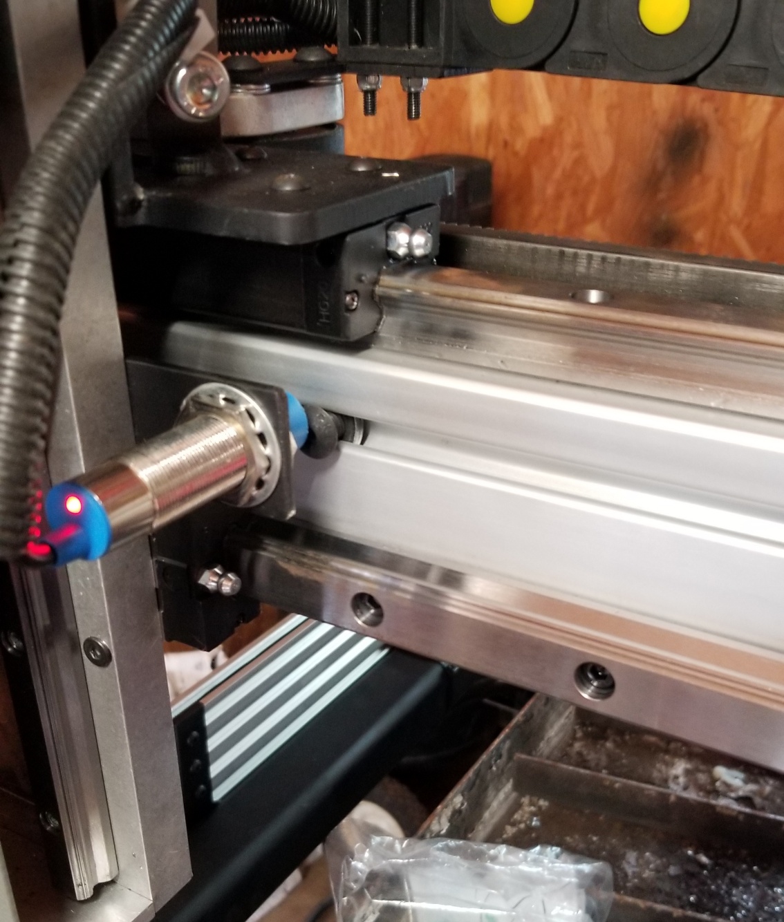

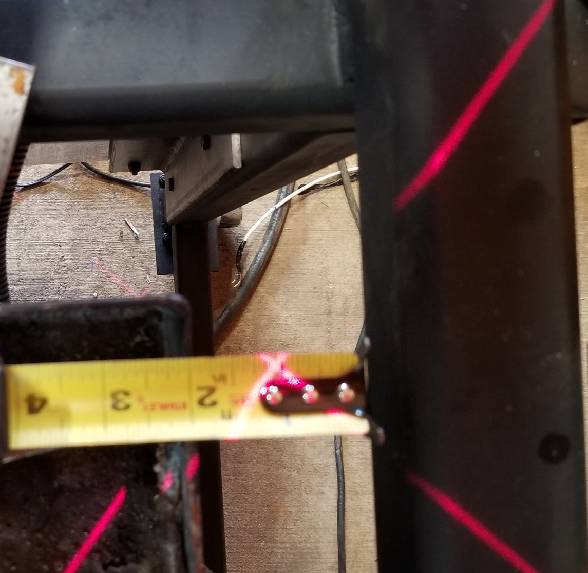

Finally have the cable chains mounted where I think I want them to be, and ran the wiring. I used these screw terminal connectors before and didn't seem to have issues, so I'll reuse them. The gantry and main carriage for the Z is mounted significantly higher this time, so hopefully that aids longevity with various parts.
I bought the laser crosshairs a couple of months ago. At that time it didn't occur to me to use them for getting my proximity sensors (for homing/limits) set pretty close to where I want, but it seems like a decent secondary use for them.
