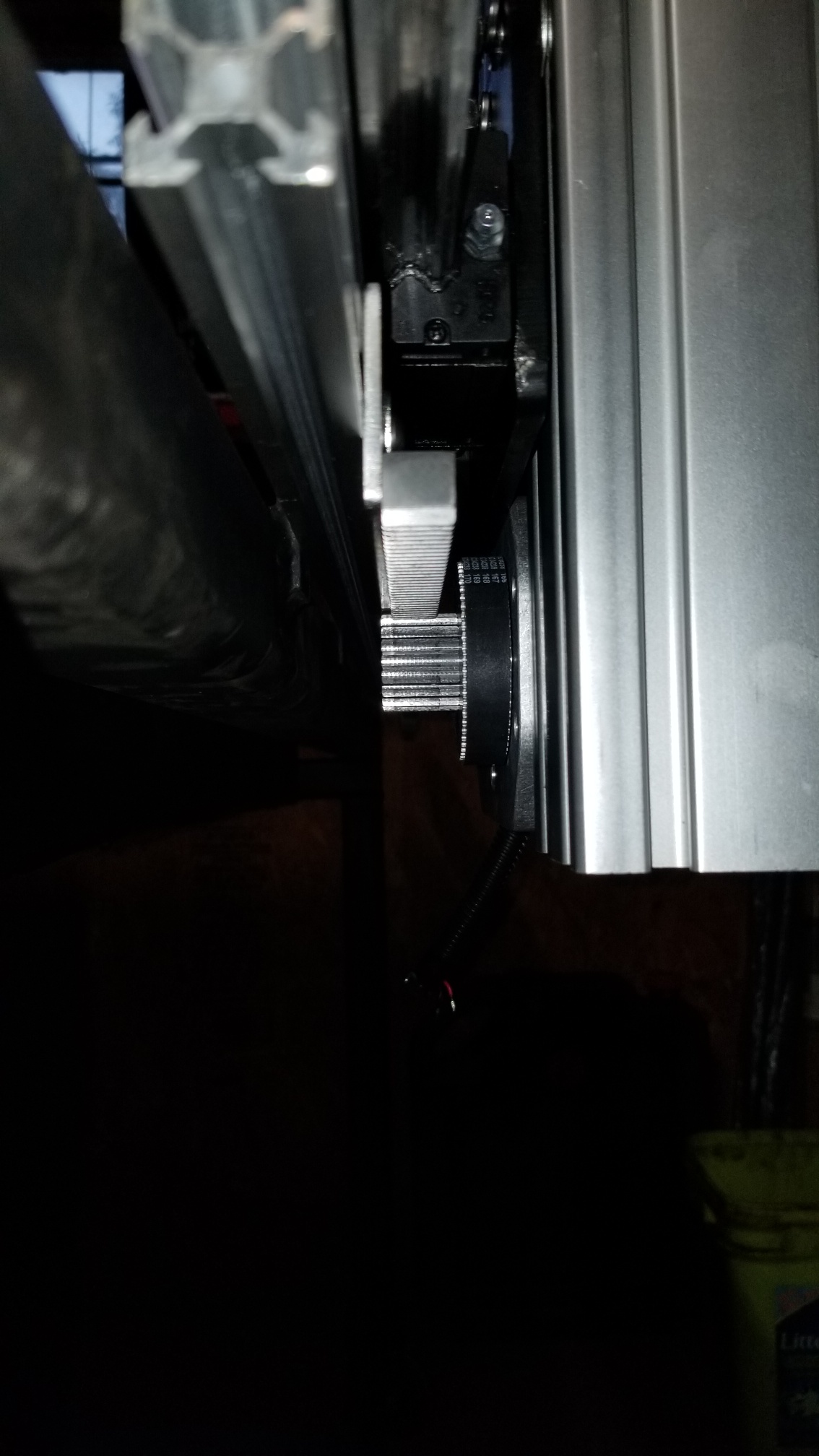

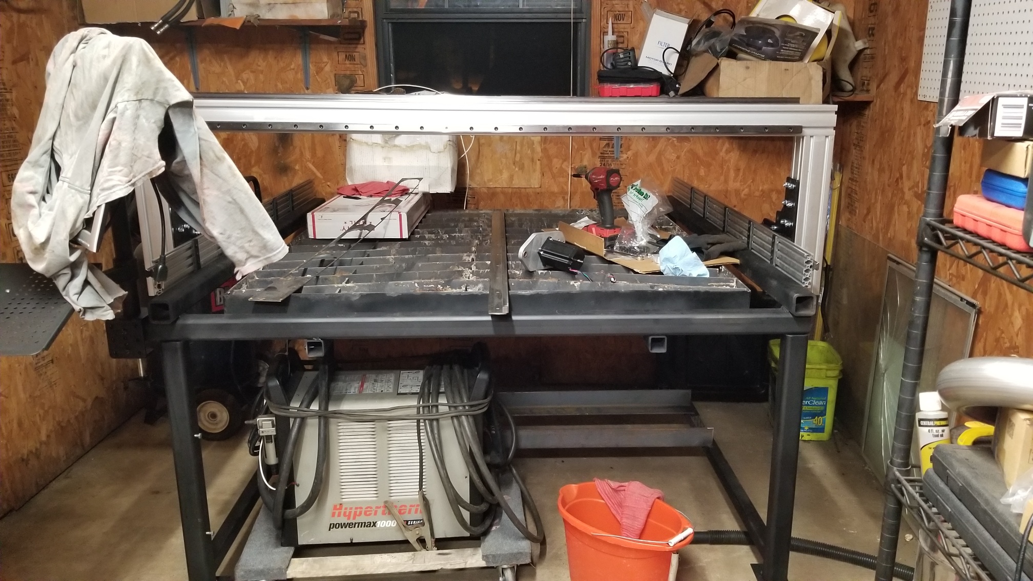

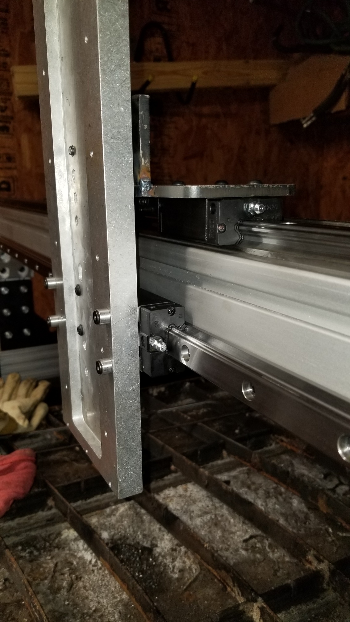

Finished both of the Y axis rails with the reduction drives. I just placed the gantry extrusion on top of the risers to get an idea of what it might look like. The risers are height adjustable and are not set to the correct height yet.
Tomorrow will be gantry day and hopefully I'll get the Z axis on it too.

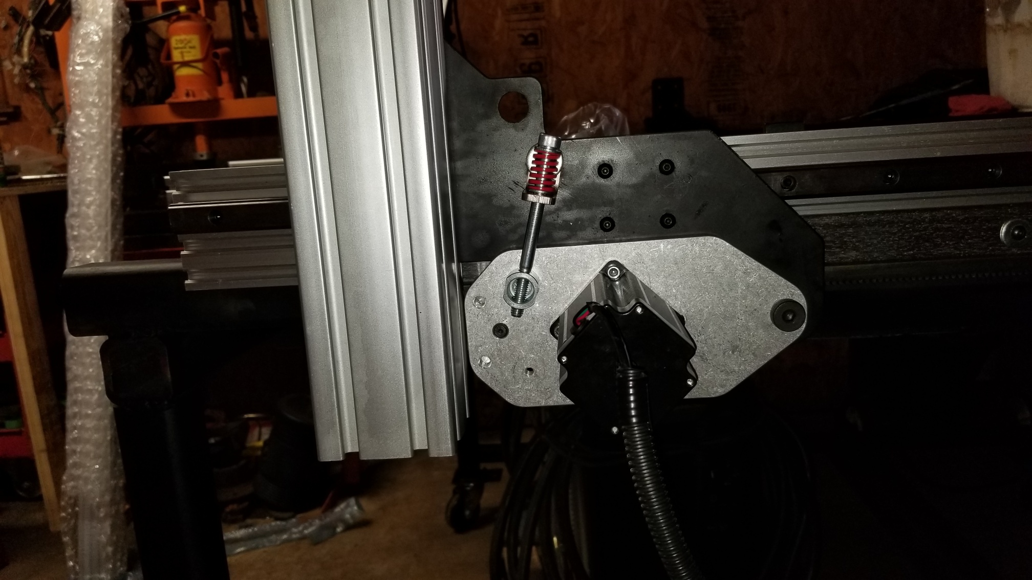

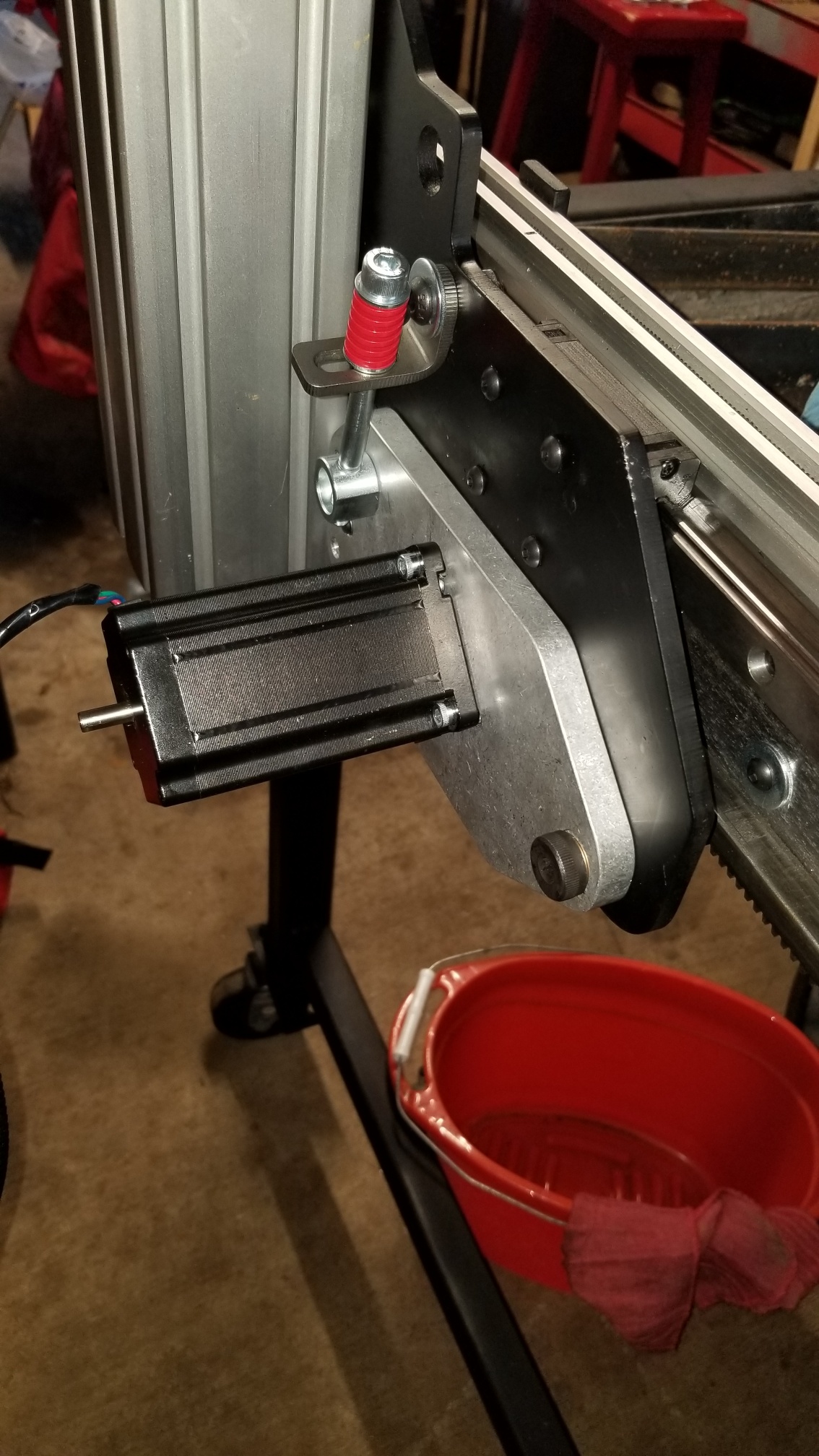

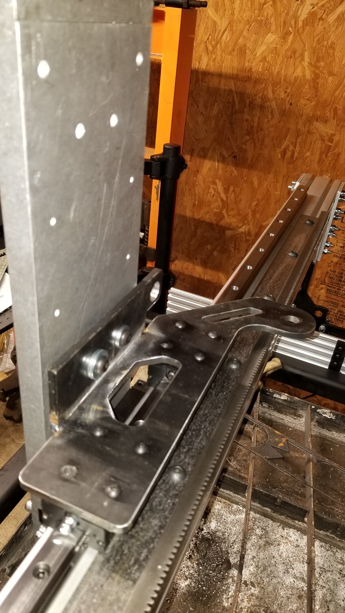

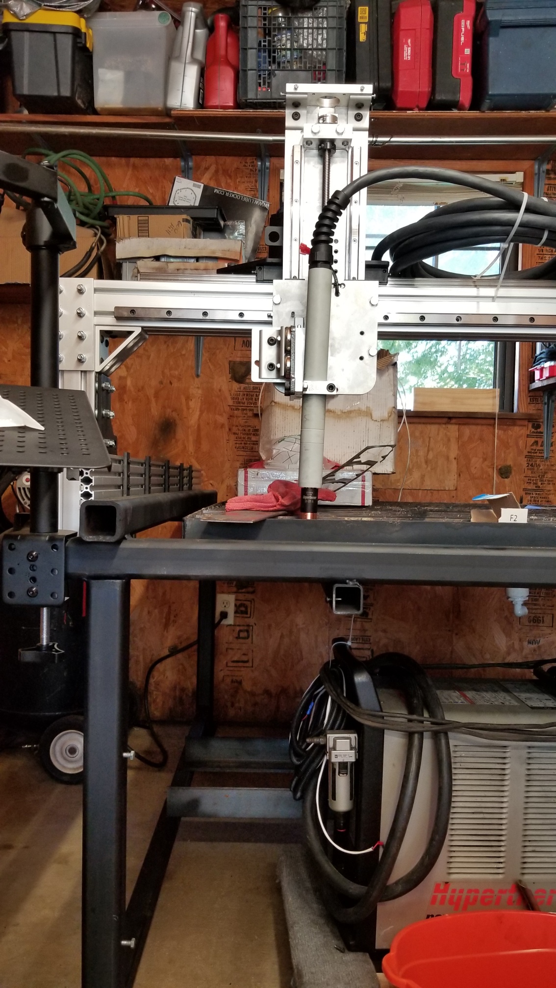

Got the gantry mounted up proper, and the carriage for the X axis sorted with the Z mounting. Just a touch of paint on the carriage and then I'll get the gantry and Z mounted permanently. It's a bit high, but it will be fine. Gives me a bit of space for an air scribe in the future.

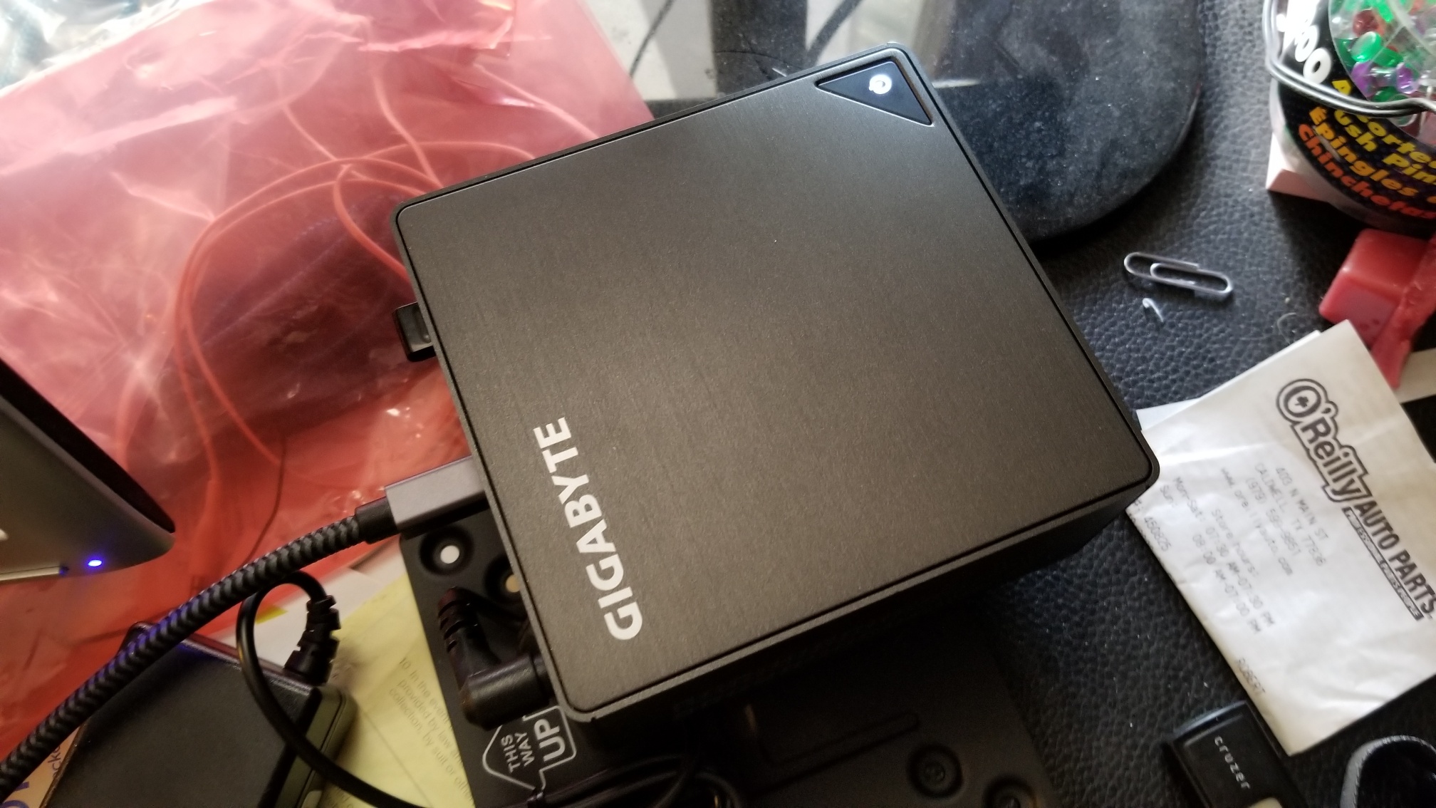

Also got the BRIX PC out and installed mint. Still have to install linuxcnc after I get the RT kernel in there, but it's coming along.

Hi
Of topic
If i see on your last image how the torch is fixed with one clamp.. I would expect that to change mechanicaly when there is sidewise load from the cable.
Mike
Of topic
Mike

In the picture the torch is tilted. That is because the clamp is not tightened, I just placed the torch in it to get an idea of how much would be below the mount. The cable will be routed differently and secured so it moves with the Z axis. Also, the torch mount is a magnetic breakaway setup.

Thats all clear to me, but dont you think it will bend a bit and gives slight offsets. I thought to use two clamps..

I only use a similar single clamp but there is no way it will move as its a precision fit even before the clamp is tightened. The biggest issue I found was avoiding any wobble from the magnetic breakaway.

The clamp on mine is very good as well. The magnets are very strong, without the torch mounted it's a real struggle to get the mount to break free. With the machine torch on it the leverage from the length would make it release a bit easier.
