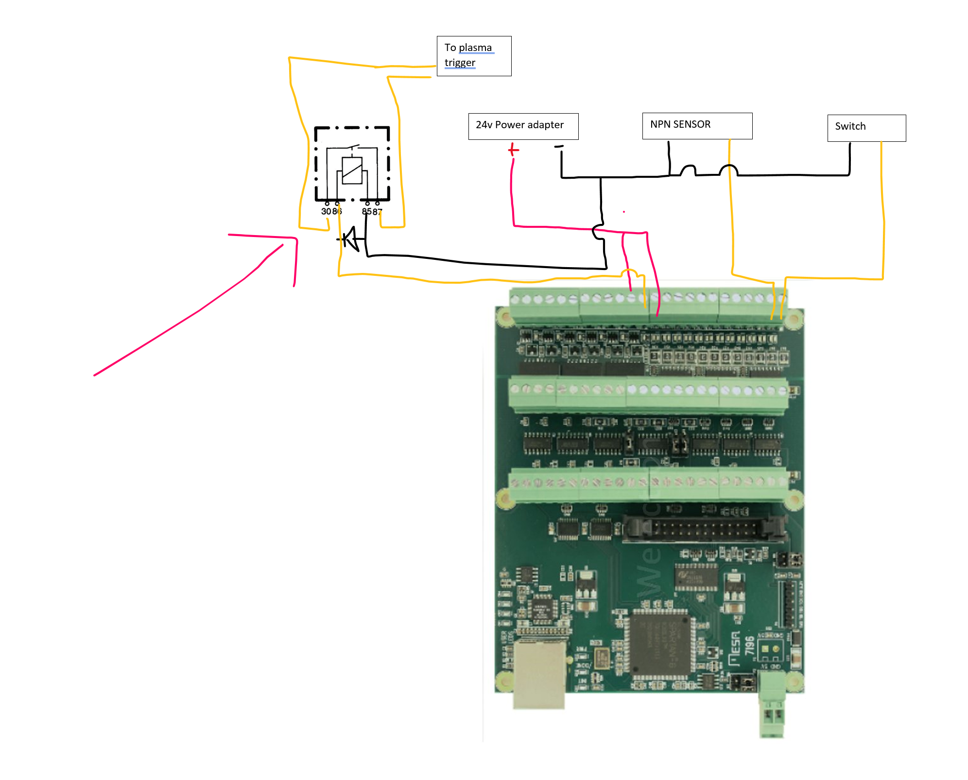

I have finally got the wiring to work! Here is a link of the first movement from configurating the axis.

Now to the next problem. With my wiring for the NPN sensors (with resistor) i need to invert the input signals (now they are triggered when no object is in front om the sensor). In the configuration for Linuxcnc it seems that i can´t invert them there.
Is it under the HAL file i will do the inverting?

Yes in .hal file add
-not
to any input pin you want inverted.
