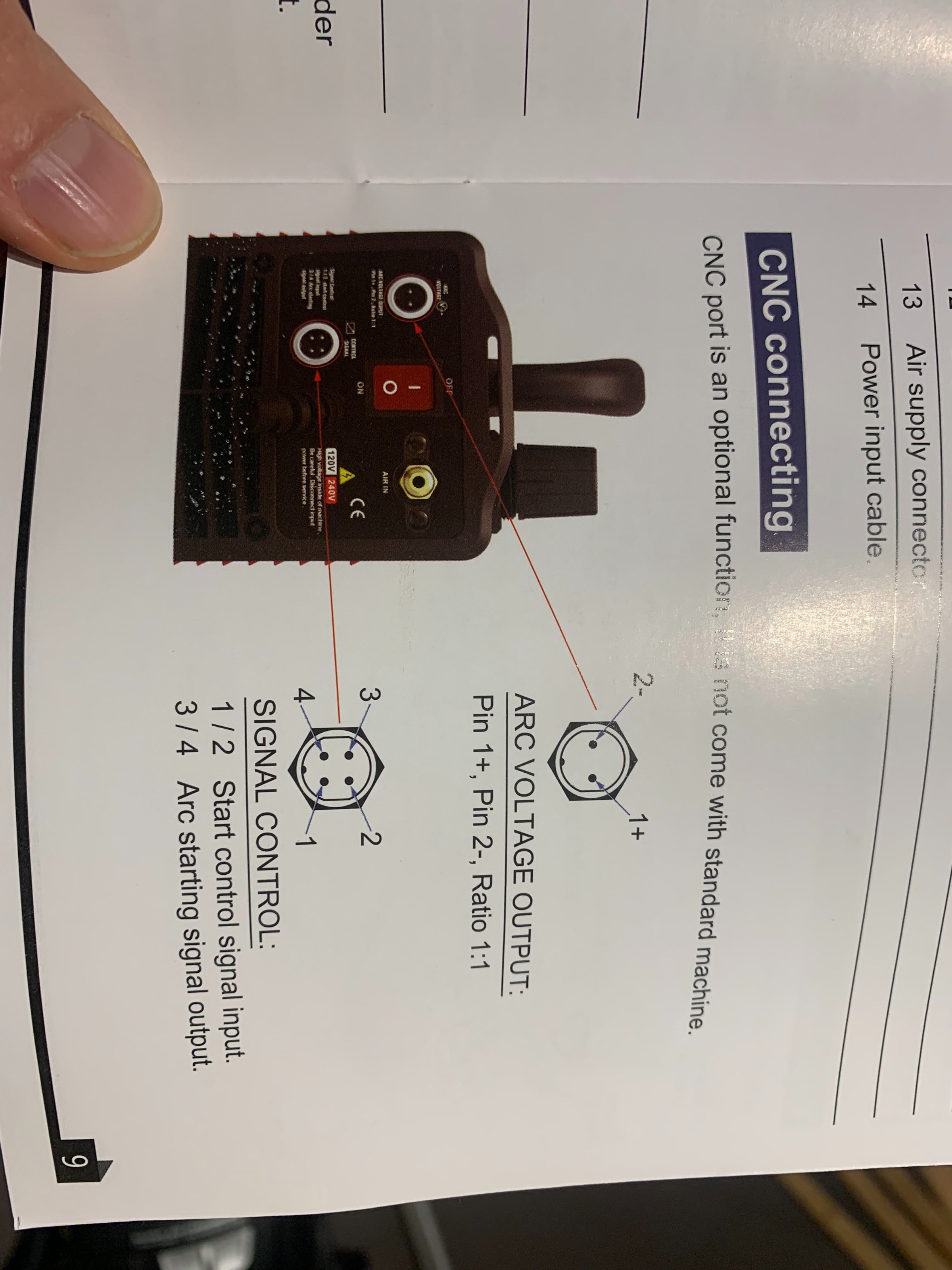

Hi! I have bought a new plasma (Herocut 55x) now with pilot arc and should use that instead of the HF-start machine that i have used.
Can the THCAD-10 card work without any modifications to this card?
In the attached picture i have questiions how i should connect the lower plug. On my old plasma i just have a relay that drives connects/disconnects the torch button. Now four cables?
Can i add the THCAD card inside the main unit or should i avoid that and put it separatly.
I see that i need to read up how to connect the THCAD card. i don't yet understand these ports and how they work.
FOUT+ Frequency out +
FOUT- Frequency out -
FREF+ Reference frequency
FREF- Reference frequency

You don't need FREF so if you use 4 pair CAT5. I would wire it:
one pair +5V (use pair for lower voltage drop)
two pair GND (use 2 pairs for lower voltage drop)
one pair FOUT+ and FOUT-

Thanks! Do you know how the arc starting signal from the output works? Sould i wire it some where or is that unnecessary when using THCAD?
