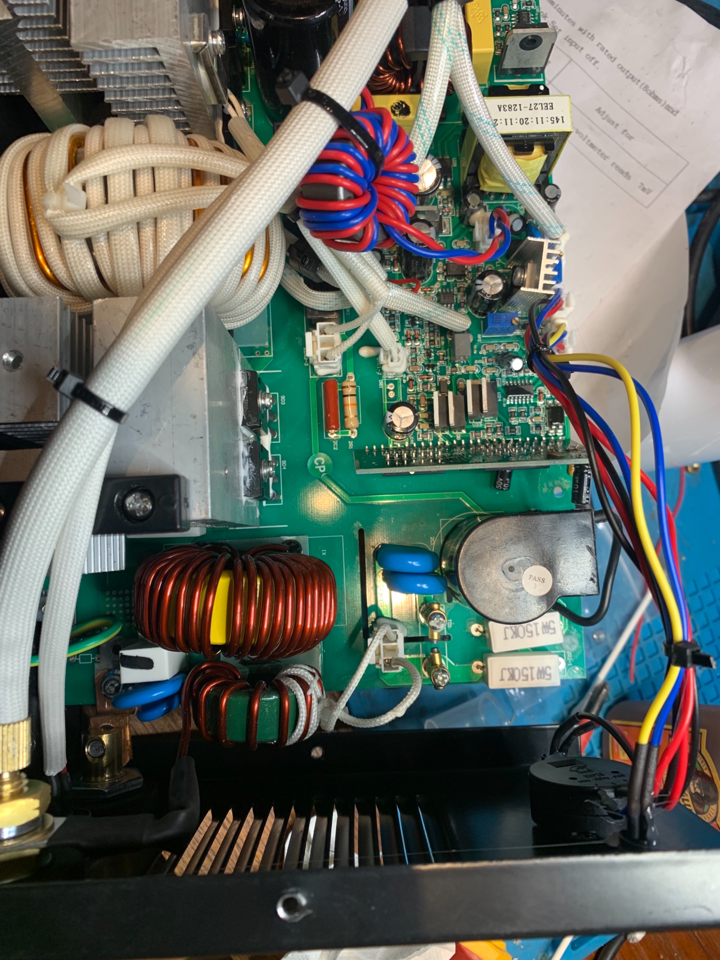

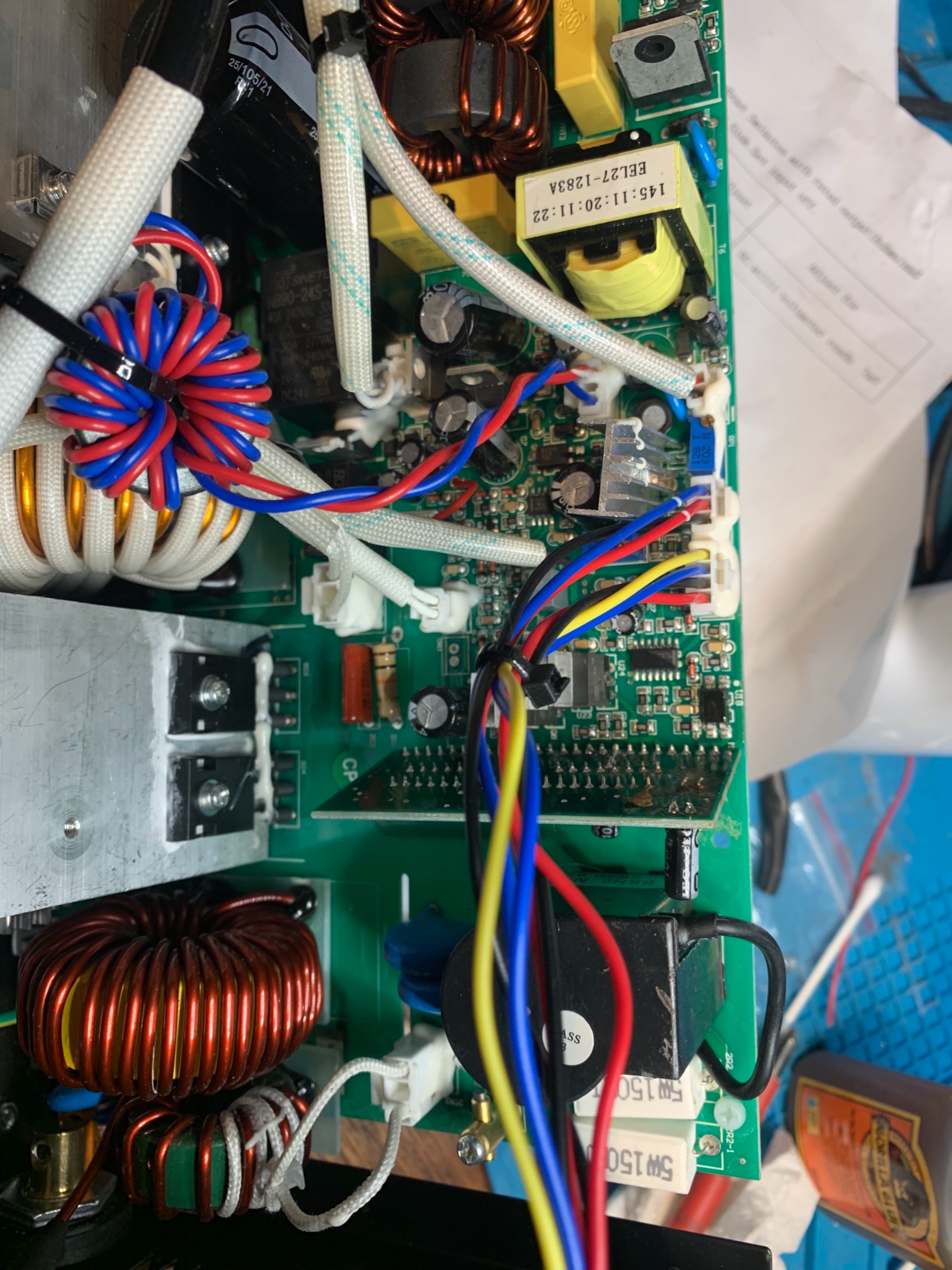

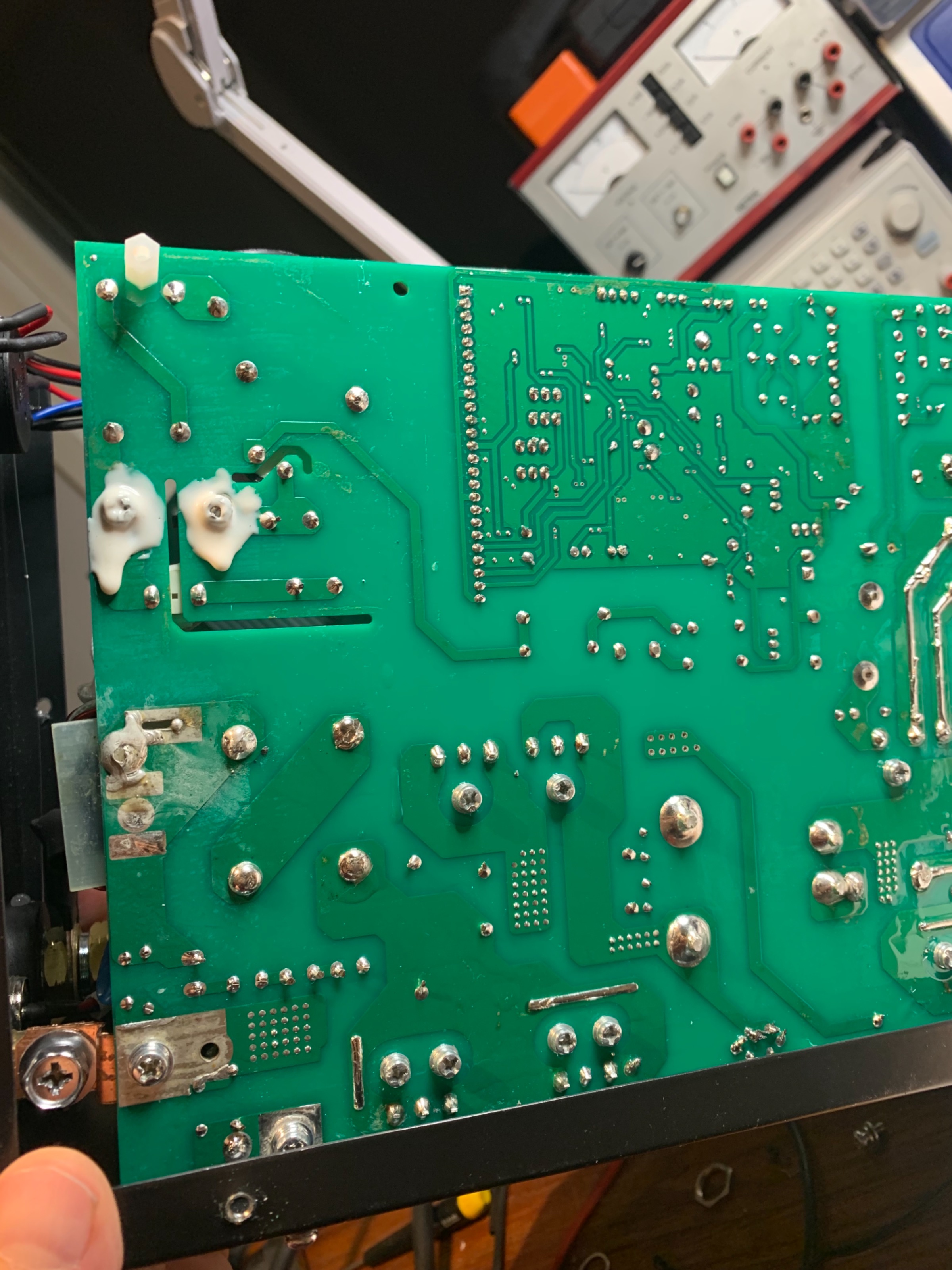

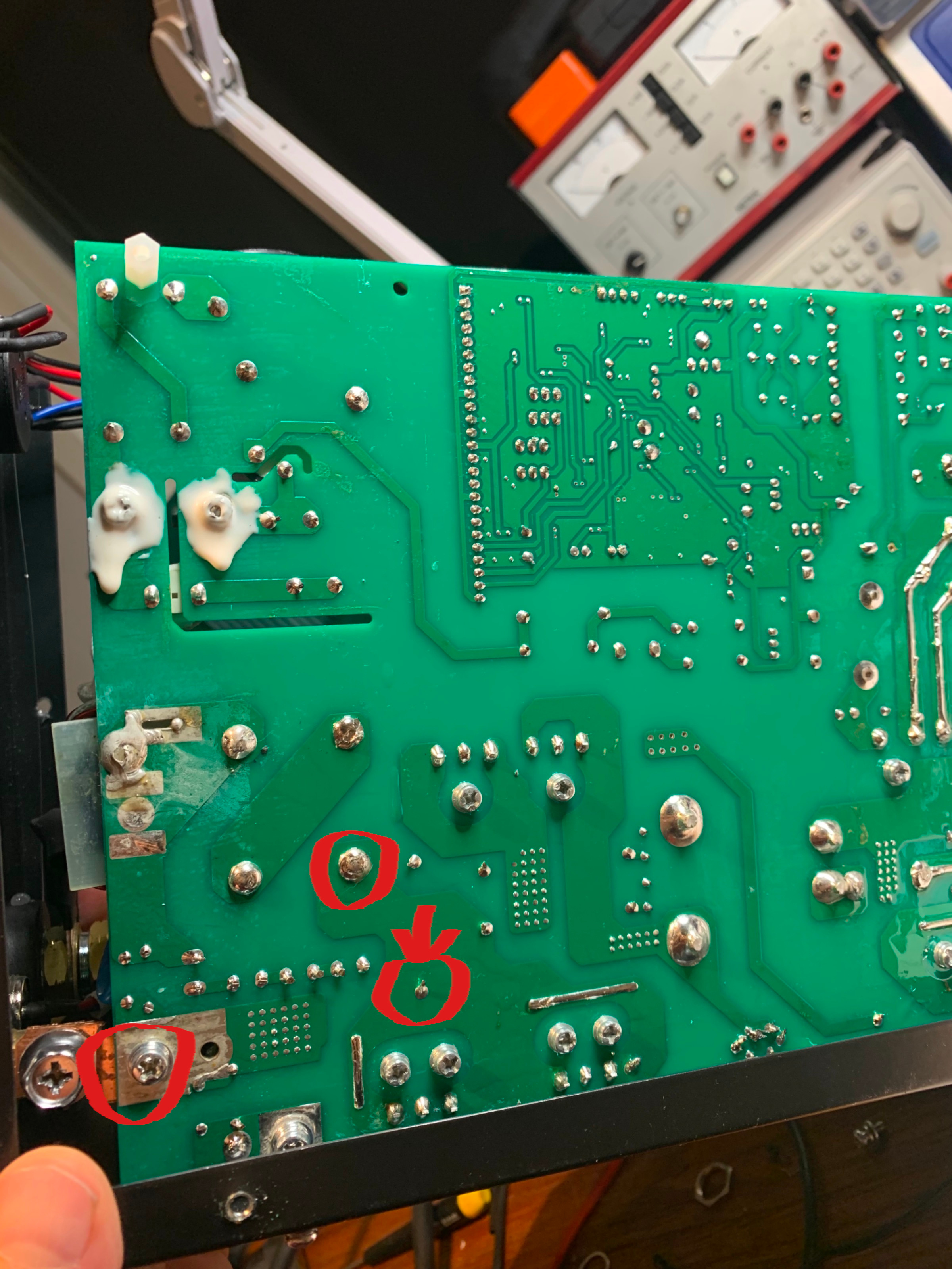

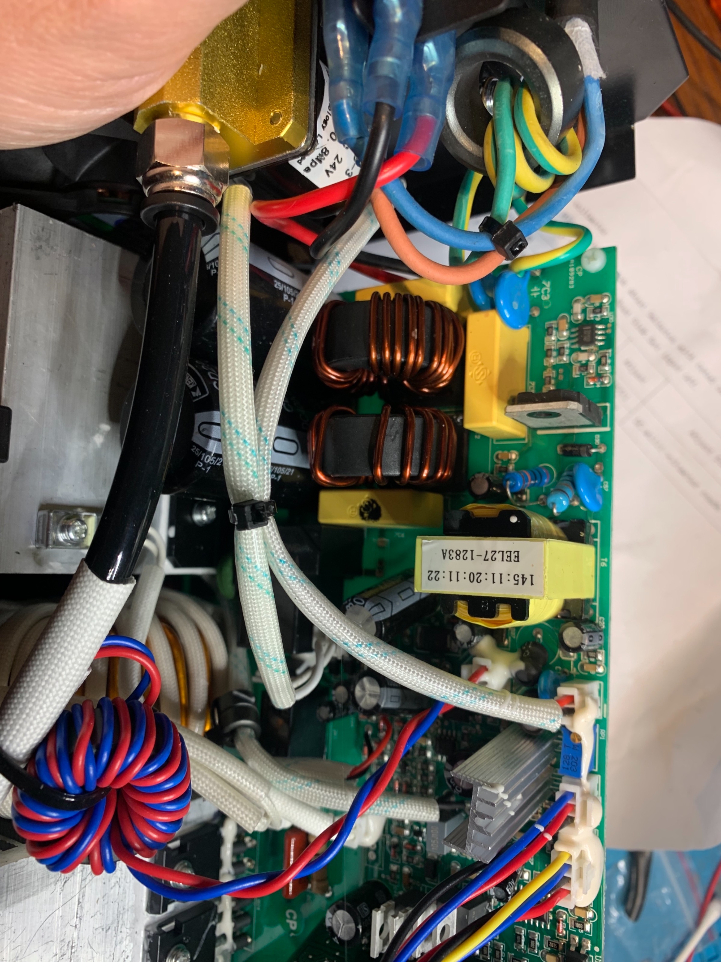

What do you think about wiring a THC on this plasma? Is it possible? Should the thc be after the inductors? I think i marked the output of the mosfets, but i guess that the inductor will smooth out the voltage rippel?

- Posts: 21958
- Thank you received: 7478
07 Oct 2021 10:43 #222442
Replied by tommylight on topic My foldable plasma table

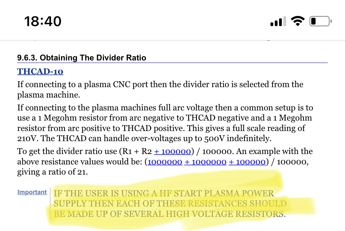

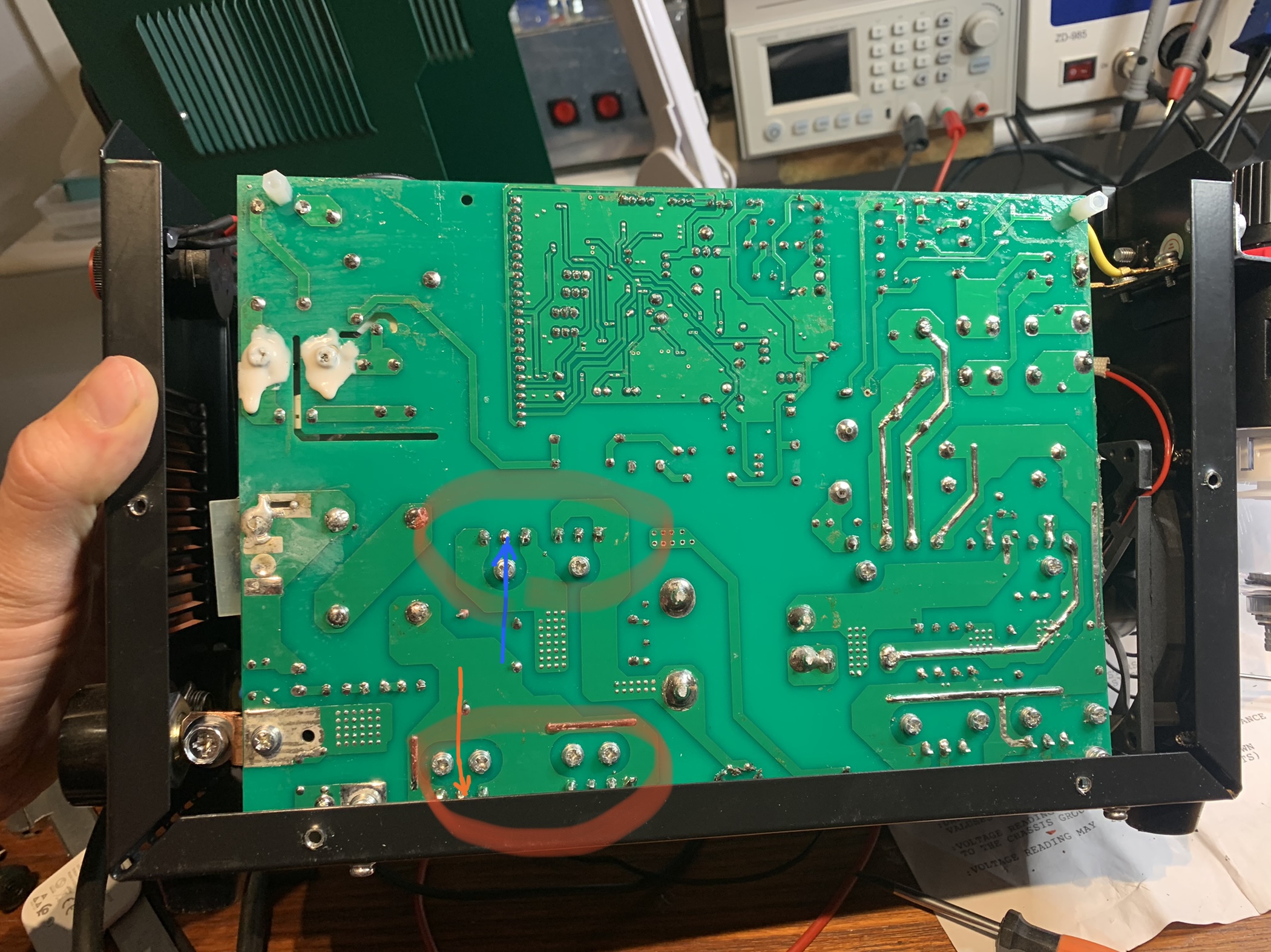

Interesting! I will try to make a video of the area. Do you have any more information of the connection of the resistors? Will order the THCAD card soner then i thought ;D *edit; ordered*

07 Oct 2021 14:27 #222458
Solder a piece of wire to one pin of the resistor and isolate it, the other pin solder to the plasma board.
Same for both resistors.
Testing procedure:
-After wiring THCAD, remove the connector that goes to the electronics box, leave just the connection to plasma, start plasma manually while cutting some scrap material = if no smoke, move on,
-Have the torch in mid air and fire it for 3 seconds, not cutting just leave it on and off several times = no smoke, move on,
-Have the torch nozzle touching a scrap plate and fire the torch, beware this will destroy the nozzle so use an old one for this, do this 2 to 5 times = no smoke, move on,
-Attach the other connector to the THCAD with electronics OFF, repeat the above tests just once or twice each = no smoke, move on,
-Power on the electronics, enable the drives, open a gcode file and run the machine, while the machine is running repeat the above tests once or twice each = no smoke, everything is OK.
Testing procedure:
