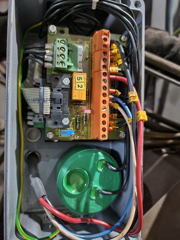

I am looking at retrofitting an year 2000 esab suprarex gantry with linux cnx and mesa boards. The old dc servos are still on the machine, I am trying to decide if i should use the or upgrade to ac servos. What control options will I have with the existing servos using mesa hardware? I am not familiar with this dc servo setup, i have built previous machines using ethir ac servos or steppers. Any help welcome!

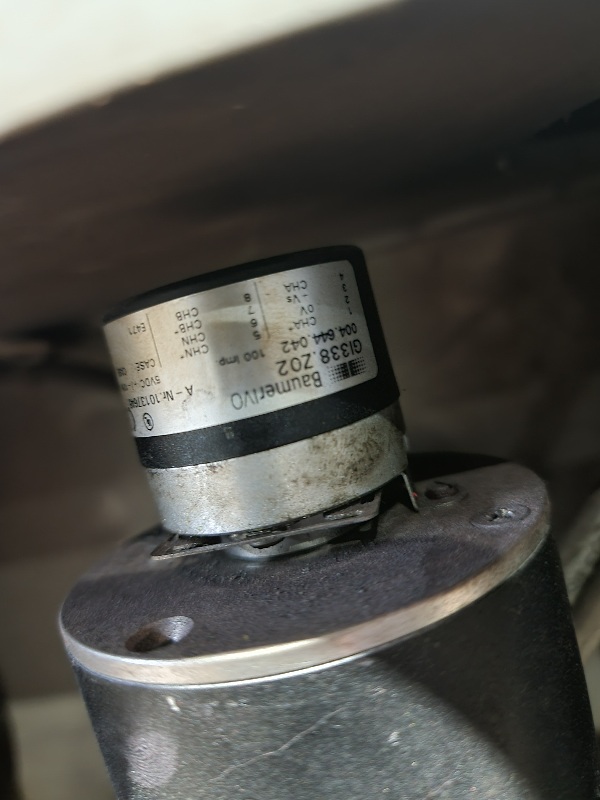

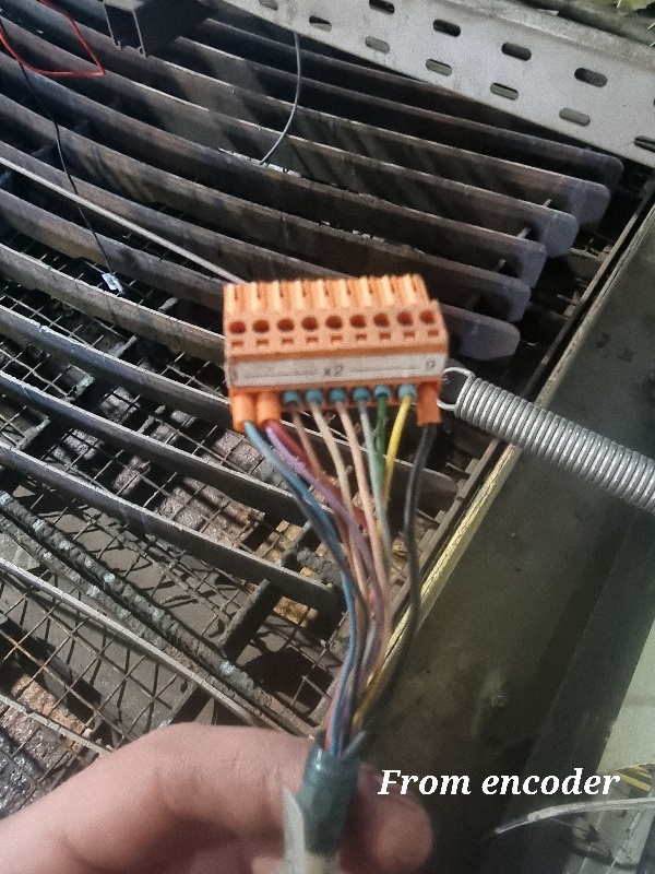

i use the 7i40hv for similar motors on my little cnc. i saw that the differential encoder has to be okay

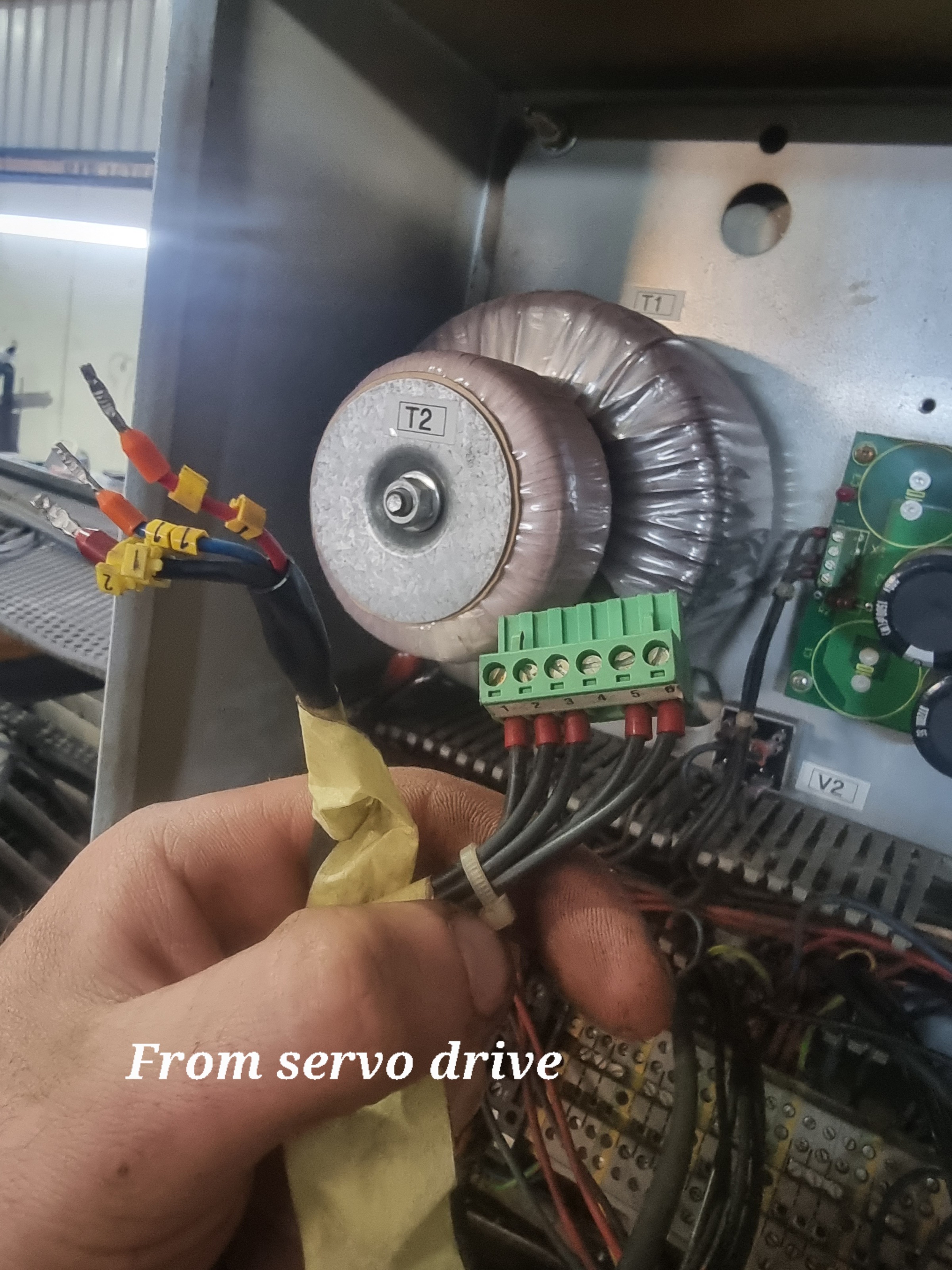

Do you still have the original DC servo controllers ?

You could also look at the Pico PPMC (which requires a parallel port, though used as a communications bus rather than bit-banging pins)
The answer will depend on whether you still have the DC servo drives, though.

Picture with those green round things, that is the servo drive.

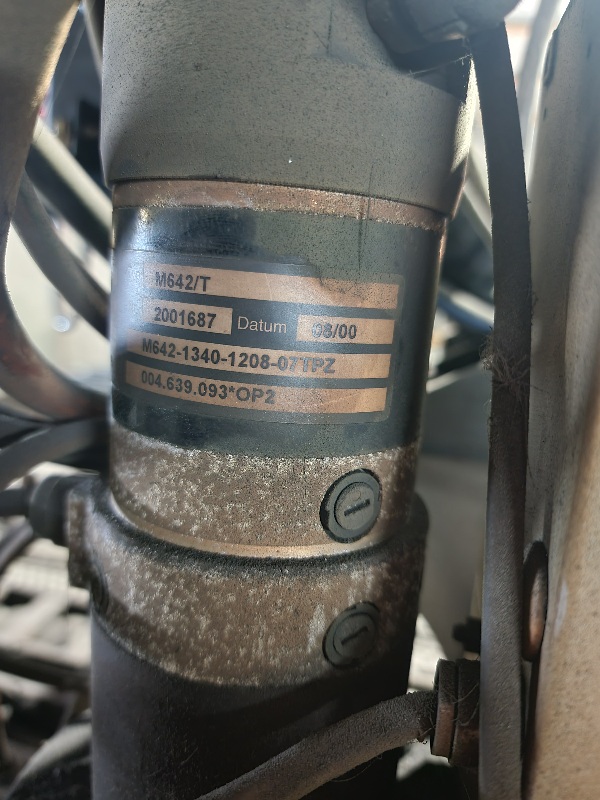

I guess that they are analogue-voltage controlled velocity-mode servos? I am confused by the second photo, is that stacked motors or a very large tachometer?

Ah, yes. I overlooked that.Picture with those green round things, that is the servo drive.
I guess the question then becomes whether they work or not.

So the tacho and encoder look huge on them. Outer diameter difference between motor and tacho/encoder lid is about 2 CM.
Replied by tommylight on topic Dc servo motor control
Yes they are.I guess that they are analogue-voltage controlled velocity-mode servos?
Those are very small motors!I am confused by the second photo, is that stacked motors or a very large tachometer?
