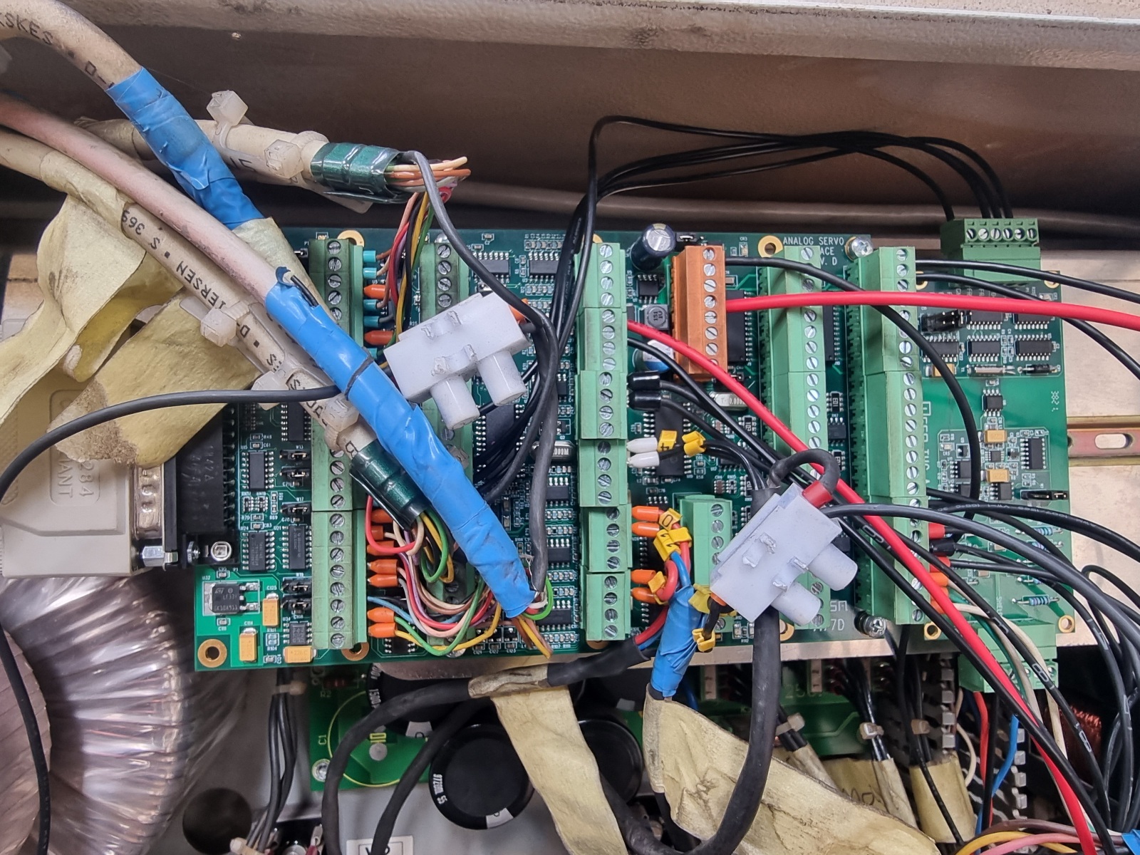

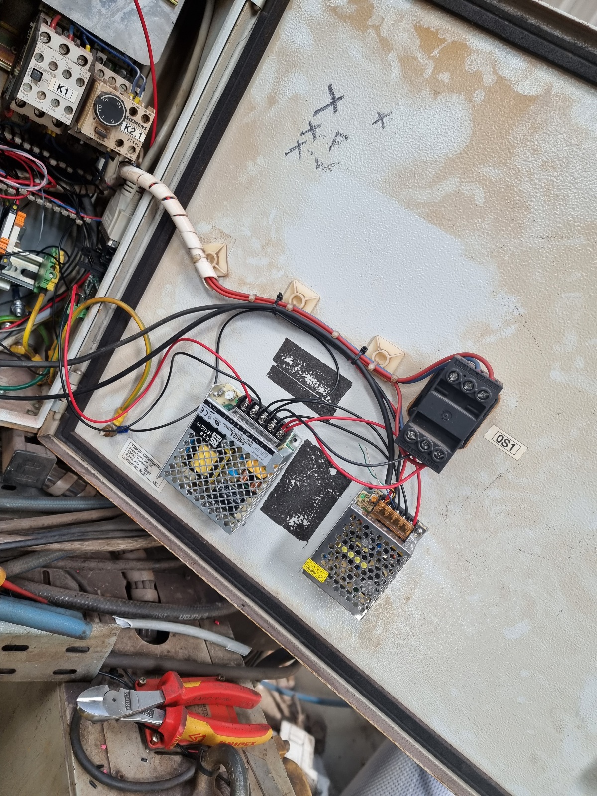

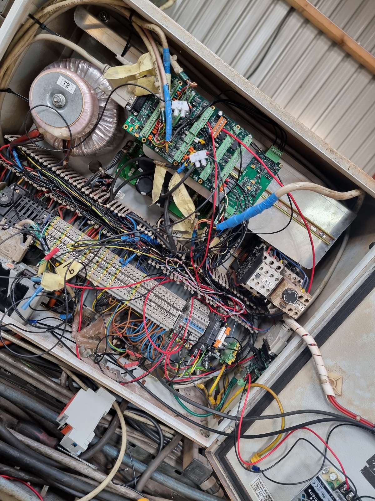

13 Apr 2022 12:10 #240140
by Joeymcc
very messy at rhe moment, i have removed the ohmic sens9r by the time i had too the pictures, it was a cnc4pc one as in link
Sensor
My ohmic sense wire runs into a box above the torch and then is took down with a multicore cable to the main panel, perhaps i should have it separate.
Replied by Joeymcc on topic Dc servo motor control
Sensor
- Posts: 21997
- Thank you received: 7488
13 Apr 2022 15:39 #240152
Replied by tommylight on topic Dc servo motor control
First picture, daisy chained ground is a no no, grounds for both power supplies must be connected to the screw on the door.
Second and third picture ... oh hell, the Mesa should have been installed where the monitor was in the control box, if at all possible move it there, together with the PC, power box is not a good place to have low voltage signaling.
THCAD should be mounted on the back of the plasma cutter, shielded cable wired to mesa and shield tied to one of the screws in the control box.
The cable for the new drive analog control must be shielded, shield grounded together with other analog drive shields.
There is a 220V cable in the control box, add a 3 socket power strip to it for the PC and monitor.

14 Apr 2022 00:41 #240199
by Joeymcc
I will sort out the daisy chain. The z axis drive is now in the power box also (bottom left) I ended up chaning to a parker oem670t drive, it tuned in good, i can still change to sheilded wires for the drive.
I will try moving the thcad board.
If needed I can remount and use old computer box, however my problem is damage to the components, not interference, before problem occured cutting preformance was fine. Problem occured while arc was starting. Previous to this the ohmic sensor was going crazy. One thing I had done which could possibly have caused problems was I wired ohmic sensor to the ground point on the gantry, not to the table, the lead from the gantry to the table and ground rod end up at the far away end of the table (8m, 4 vaccum bins linked with eath cable and bolts) to where i was cutting. I was using quite a high peirce height. Perhaps the arc has found a path through the ohmic wire from the torch cap and back to the electronics that way. I have now run the ohmic ground to the table.
- Posts: 21997
14 Apr 2022 09:10 #240220
Remove ohmic sensing completely, make the machine work properly, then try ohmic if you think you might need it.
And i do mean "remove" not just disable in hal, remove all the wires, power supply, everything.
And you are correct, with plasma, the arc start will mess up things, cutting is ok.
Damage to components is caused by that interference, most probably, so denial and insisting on "it was OK" will not fix it..... however my problem is damage to the components, not interference,
