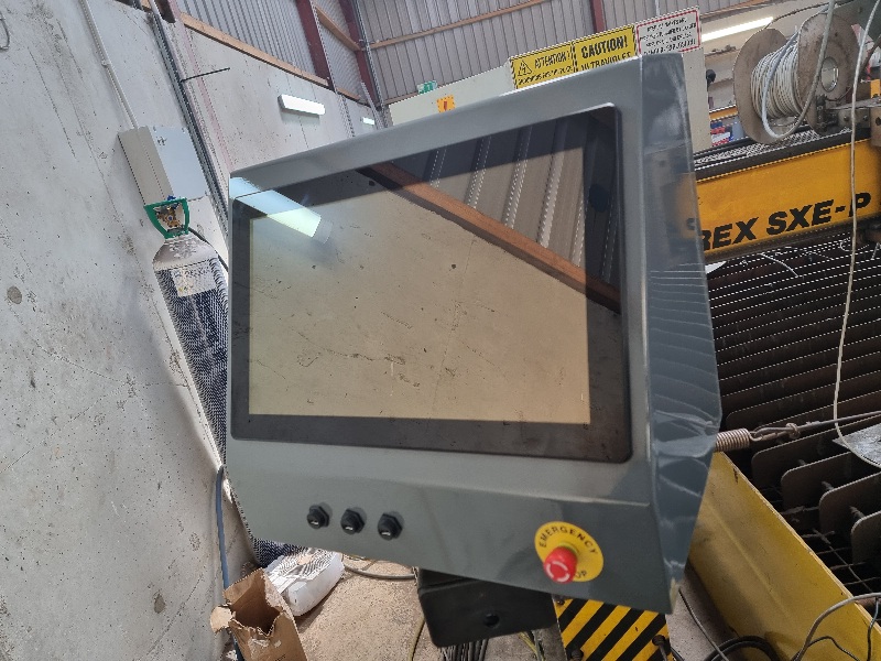

Some more work done, just waiting on a new 7i77 as I ruined 2 outputs, for some reason it will not let me use the 6th analogue output, it was still spare, the pnc config added a new line in the hal file which did not appear with any of the other AN outputs, and whenni remove it it still does not work. Anyway new 7i77 should be here soon.
I have ended up going for a float switch, the ballscrew of the Z-axis drops after away from the carriage after the torch rest on the sheet, so I used it for sensor pickup.
New box, screen installed
Need a Shorter cable to avoid coiling or an adapter to put the 7i92 onto the 7i77 as Tommy suggested. I used a supply separate to the esab 24vdc for I/O, I used a relay to control servo enable. All other I/O is separate to esab dc supply. This was maybe not needed.

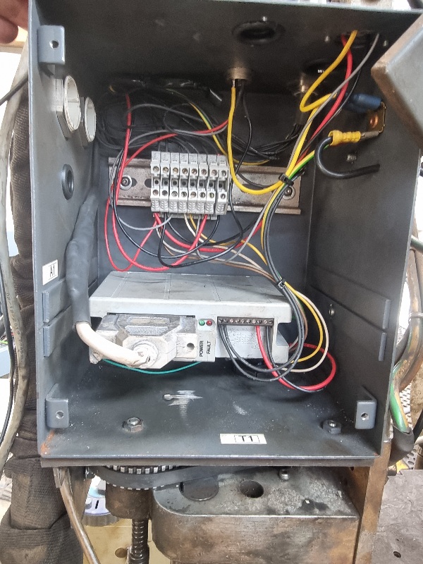

Z axis box with drive, old connectors on top were reused for float and collision sensors. Z up and z down are just original switches.

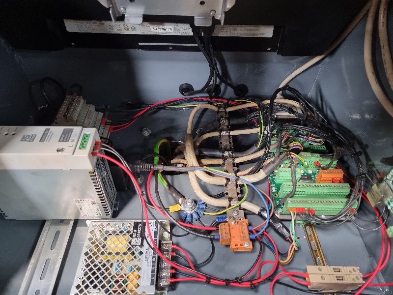

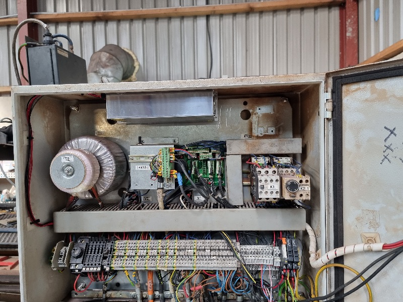

The only additions to the power box are the 48vdc psu at the top for z axis motor and the termination conectors and ss relays on the bottom right. A cleaner/easier/better way to do this would have been if I could source a 120vdc drive and use the spare drive power output from the esab card, but this works fine and I had a 48v psu spare.
