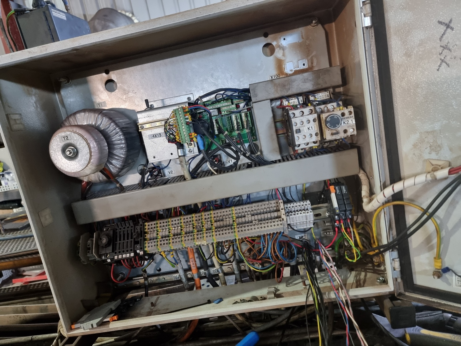

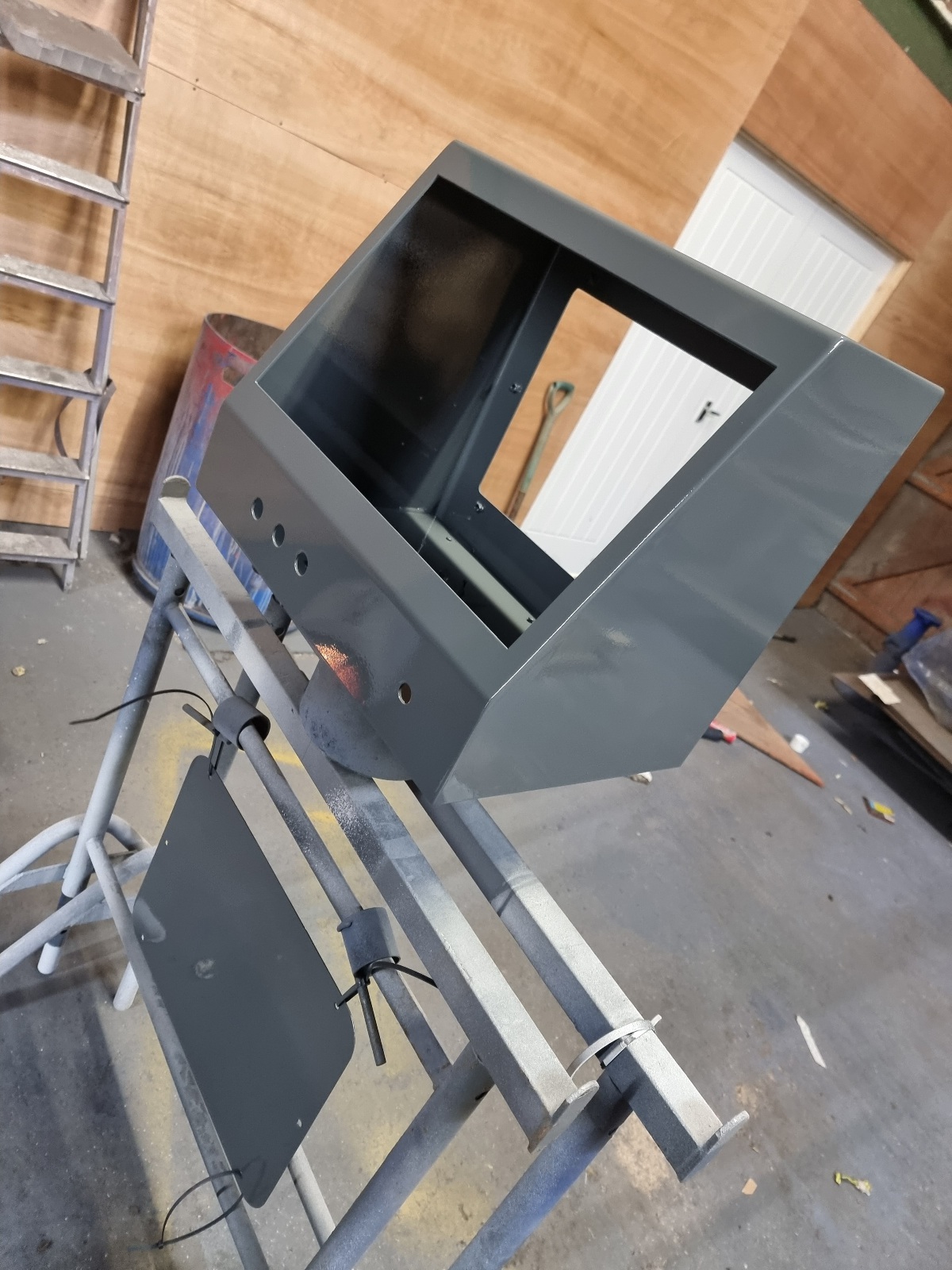

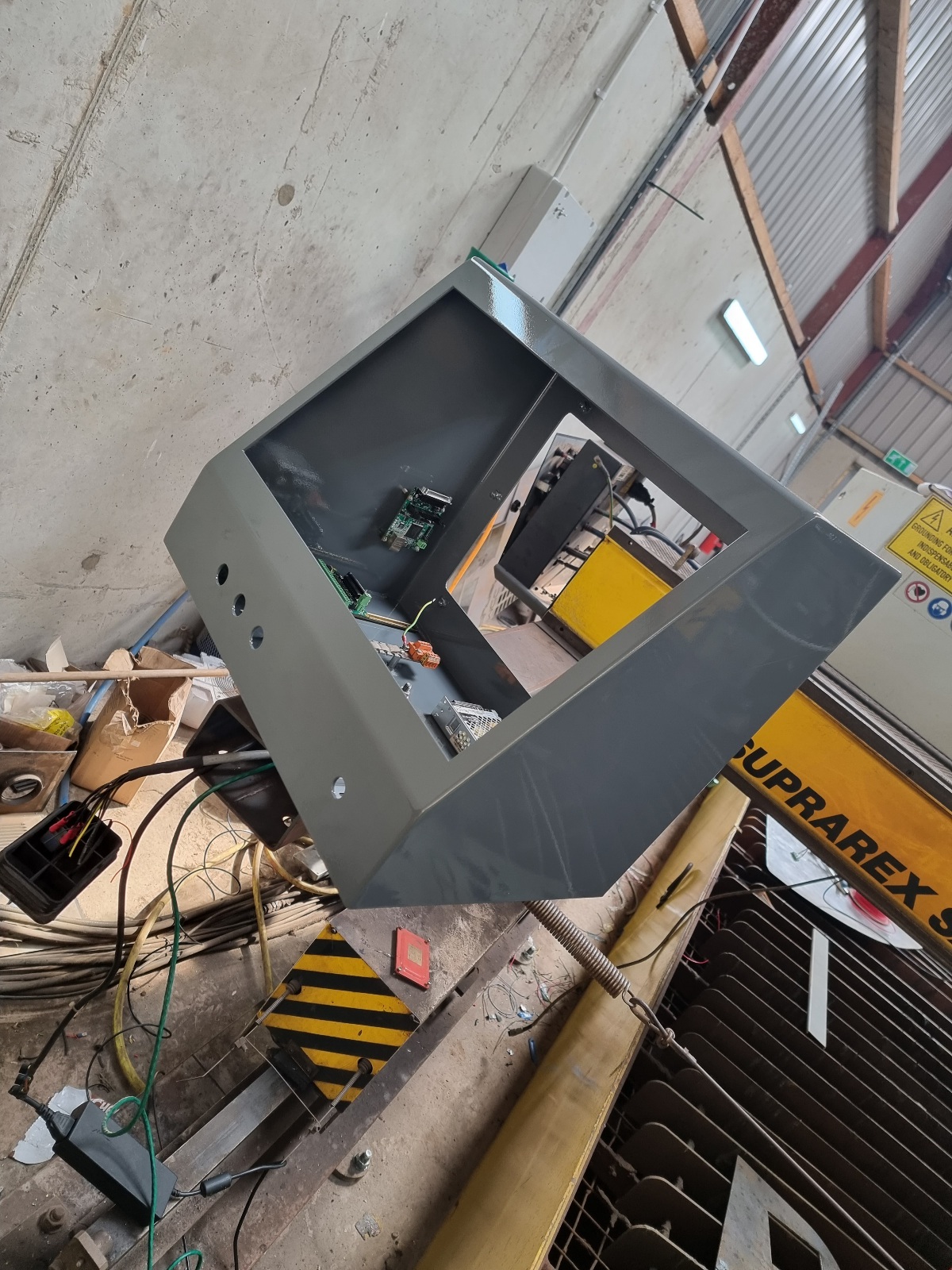

Tommy, I will do what i should have done from the start,

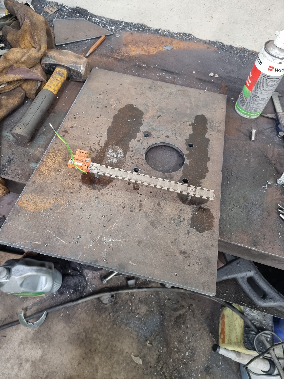

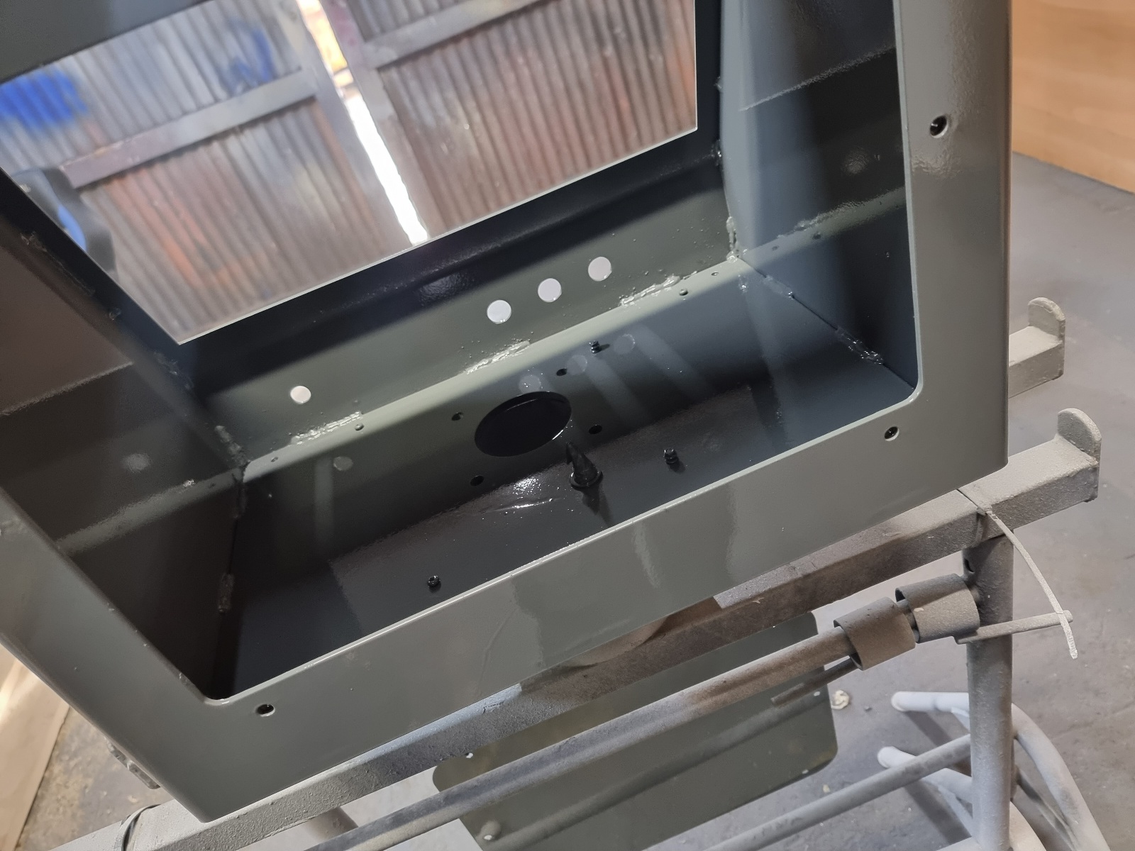

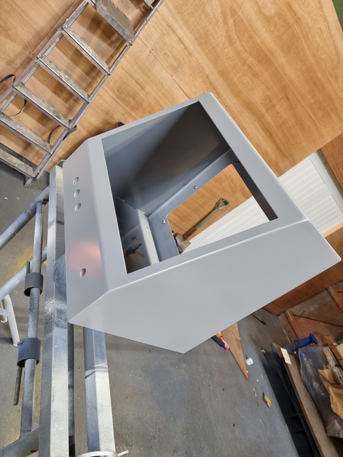

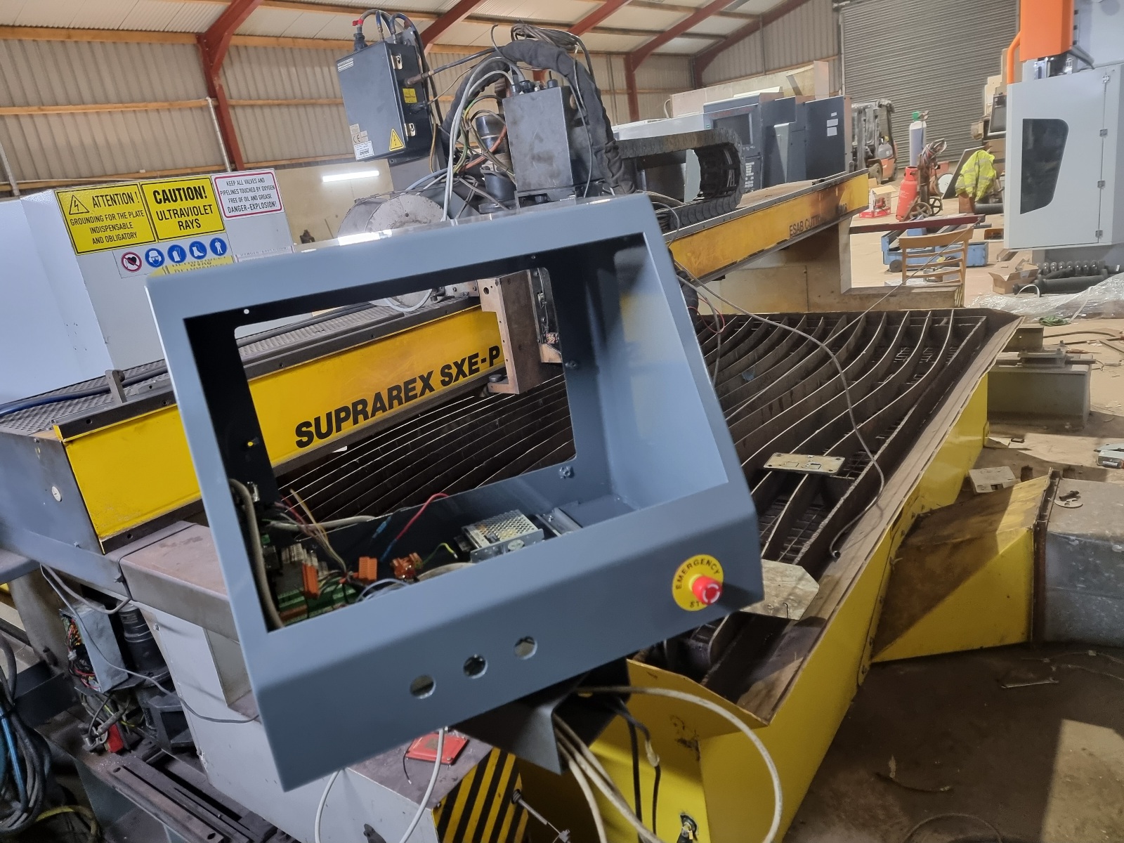

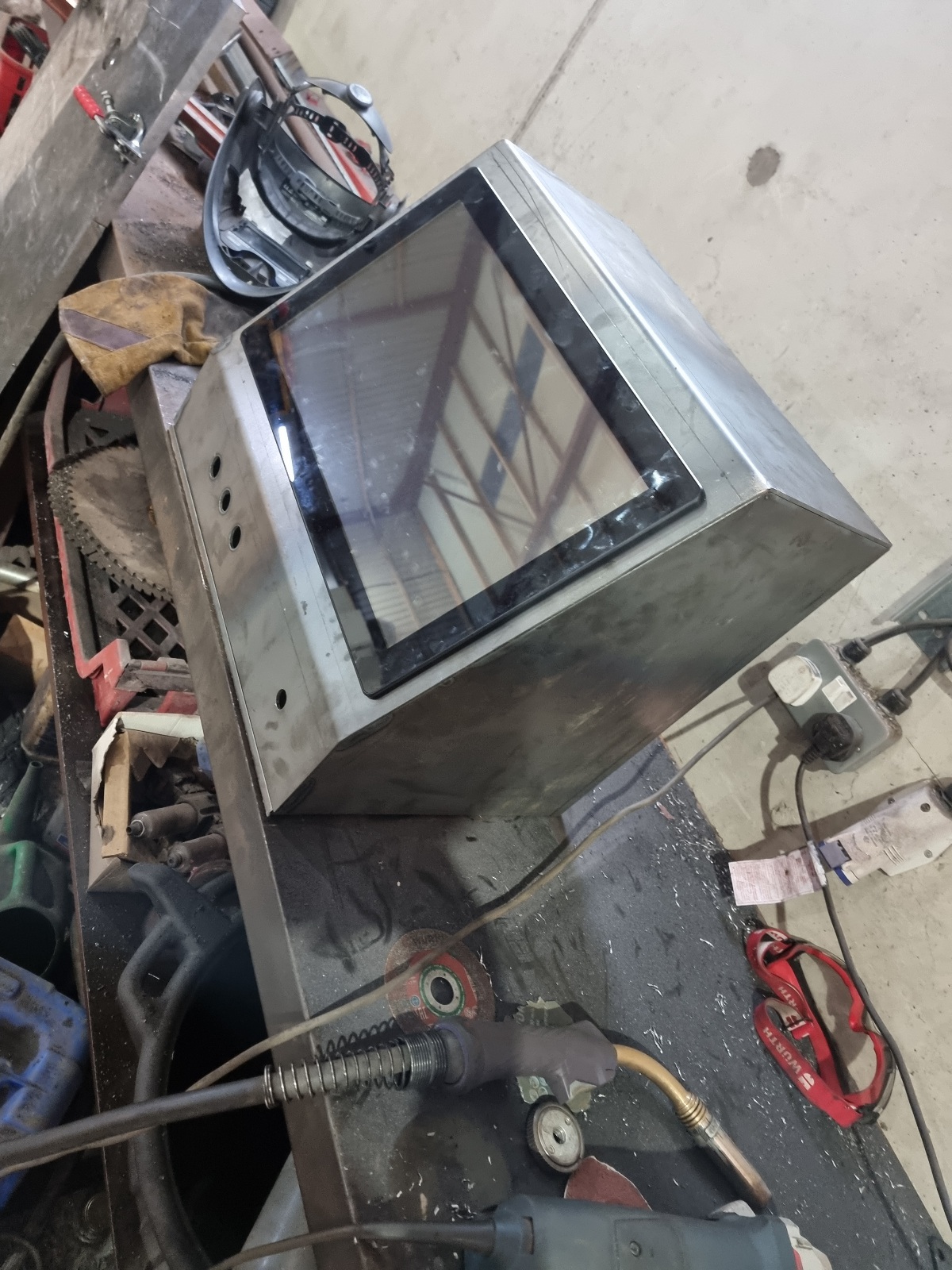

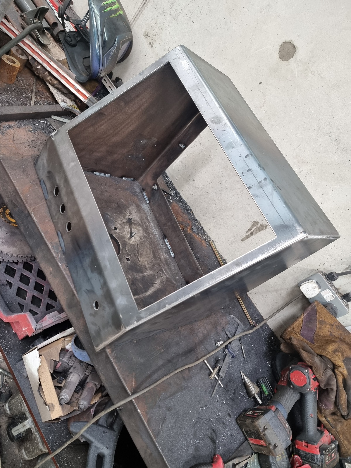

my touchscreen computer would not fit in the old cabinet, so I mounted it on its own where the old control was and tried mounting the mesa equiptment in the power box.
I will fabricate a new control box that my computer will slot into, and mount mesa boards there. I will use the grounding bar also that was in old control box. Luckily i have not cut the encoder cables or the homing sensor cables and still have the analogue signal cable from the old control, so relocation should bot be too bad.
You said at the start to use the old control box! Yes this would have been much easier! I guess esab done this for good reason. I wish I had just got a different computer. However at this stage fabrication of a new box will be the best solution and give me the computer i want. I have completely underestimated the damage that the interference could do, the HF start seems to be the issue, I got away so easy with little 45xp before that I got lazy.
I have a few solid state relays for i/o, would these be ok on the power box din rail with sheilded cable from the mesa?
I also have a 3 switches on the z axis, z-, z+ and collision, all physical switches, what would the best way be to isolate these from the mesa? Or will shielded cable be sufficient?
Ah well, at least I have some more knowledge for diagnostics in the future, and will hopefully end up with a moee reliable machine...

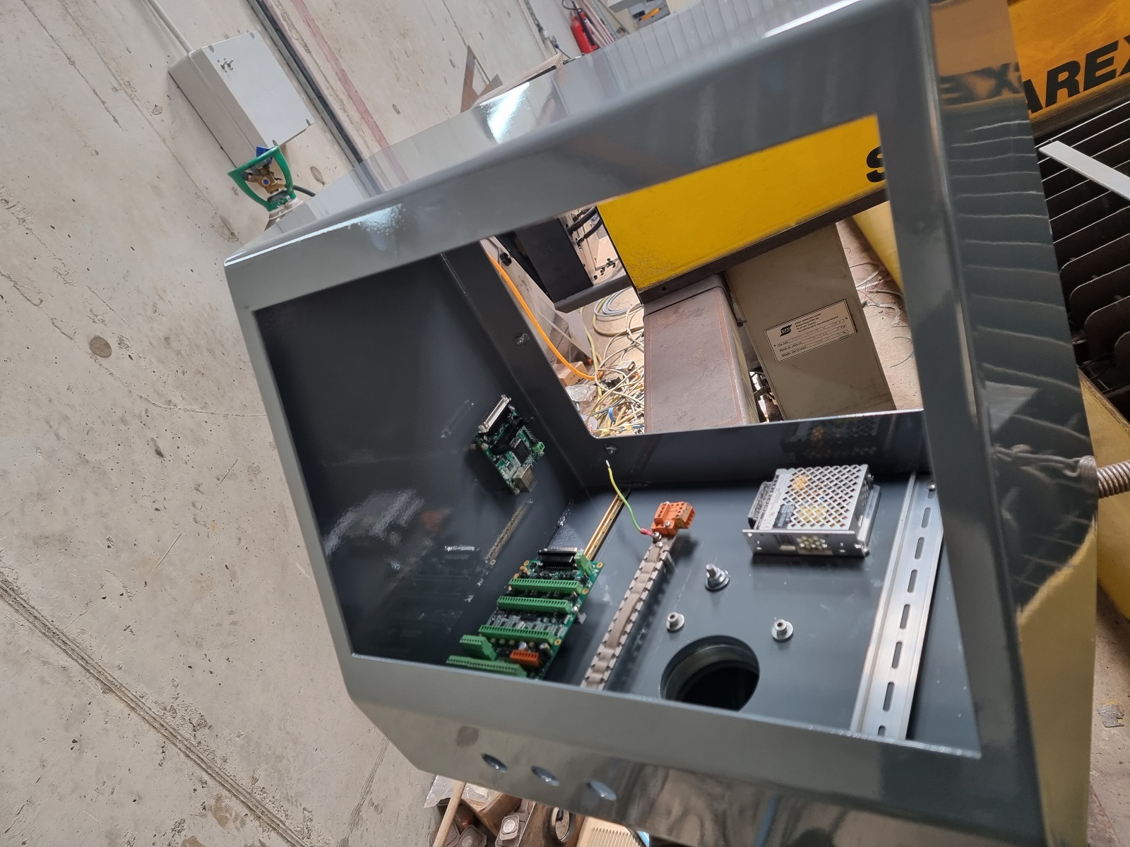

Is that a Mesa 7i92M ?
if yes, that can be plugged directly into the Mesa 7i76 or 7i77.

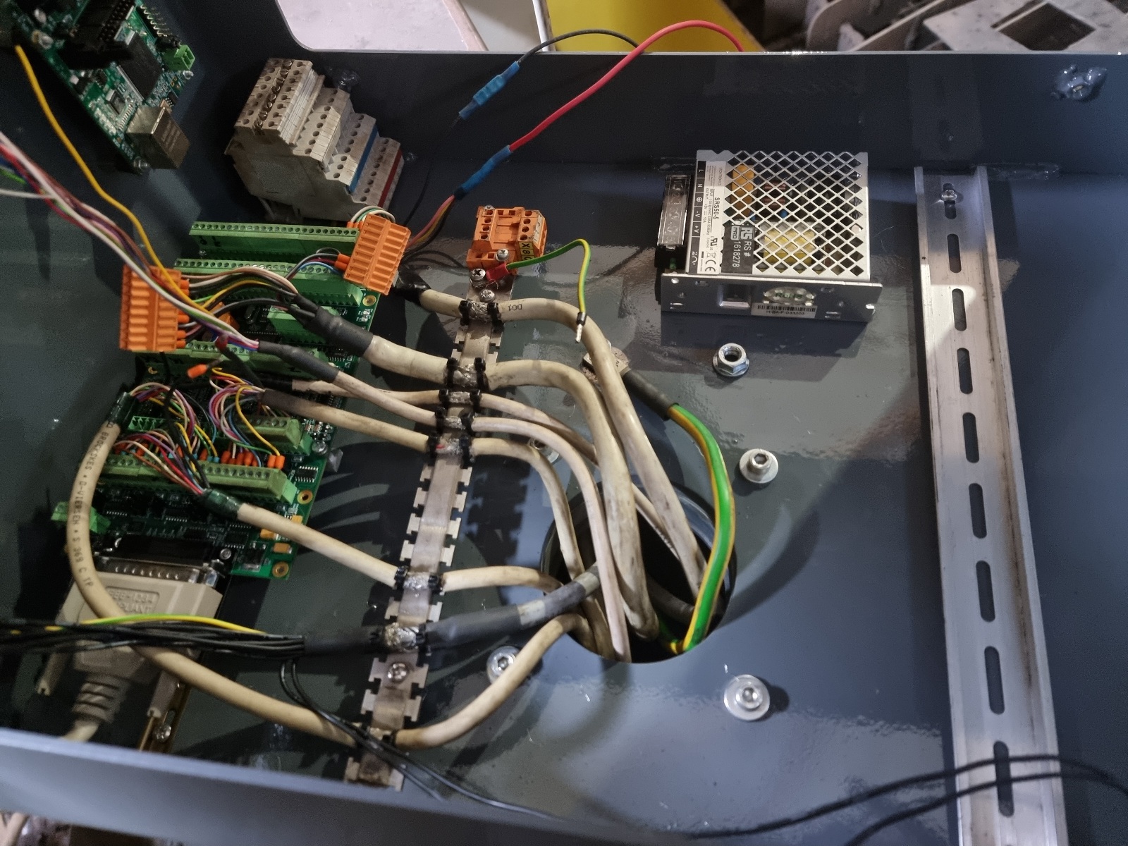

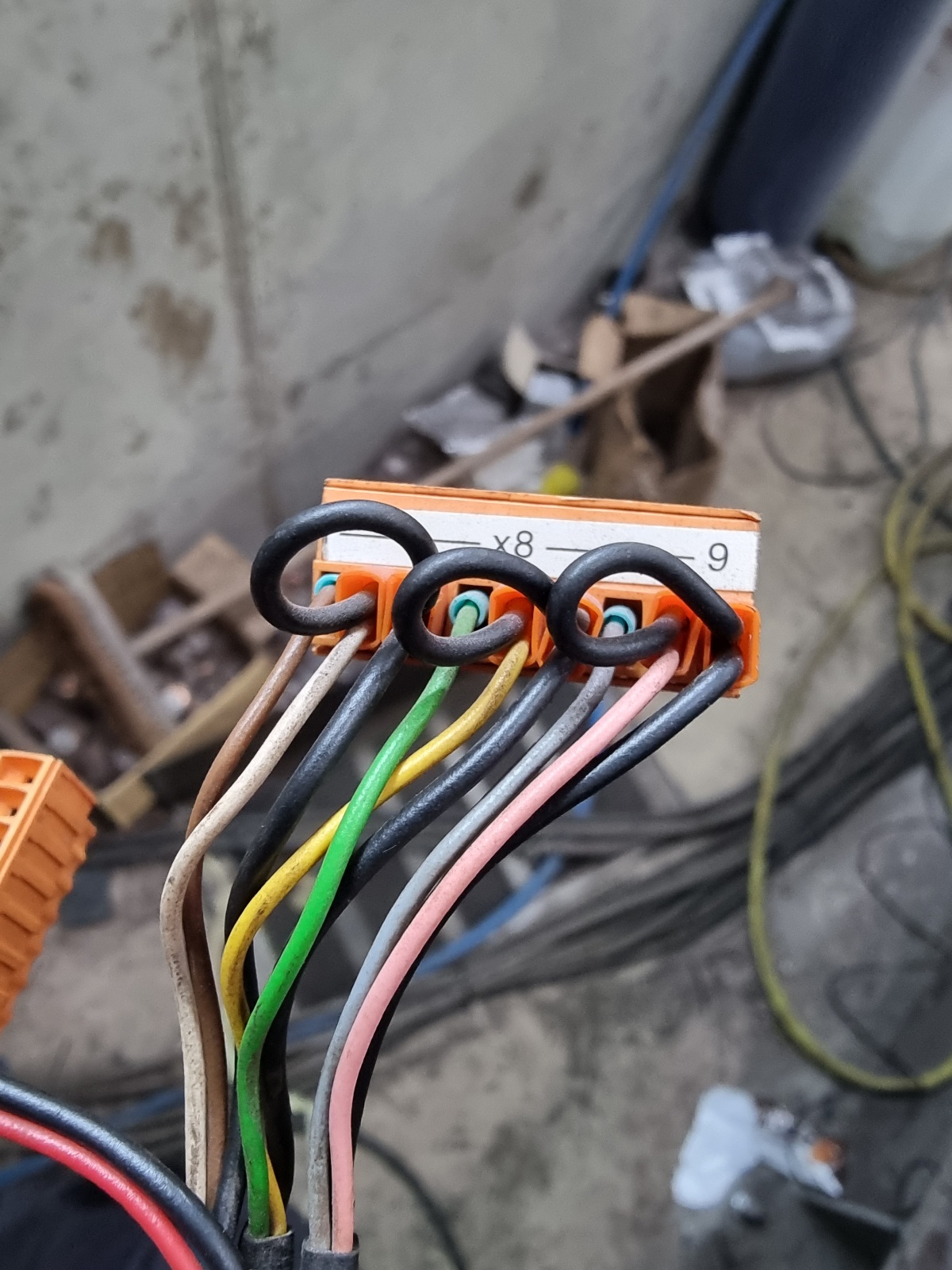

Yes it is a 7i92, I could do that with a male-male adaptor, both have female plugs.
When installing the old esab cable for the -10+10V analogue signal I have noticed 2 things:
1. I Had pins the wrong way around. I had signal ground and the -+10v Incorrect!!
2. On the esab wiring the 0v signal pins and the shield are connected, , this is not what I would have expected, I thought that the shield would have went to ground bar and signal ground would be separate. Is it best to connect the signal ground along with the shield?

- Posts: 21997
- Thank you received: 7488
18 Apr 2022 00:09 #240524
Replied by tommylight on topic Dc servo motor control
Much better!
As for the analog signals being tied to ground, i am sure i separated them, but i am also sure i did not mention that to anyone i helped with the retrofit, so it should work both ways, granted you have good grounding in the shop.
