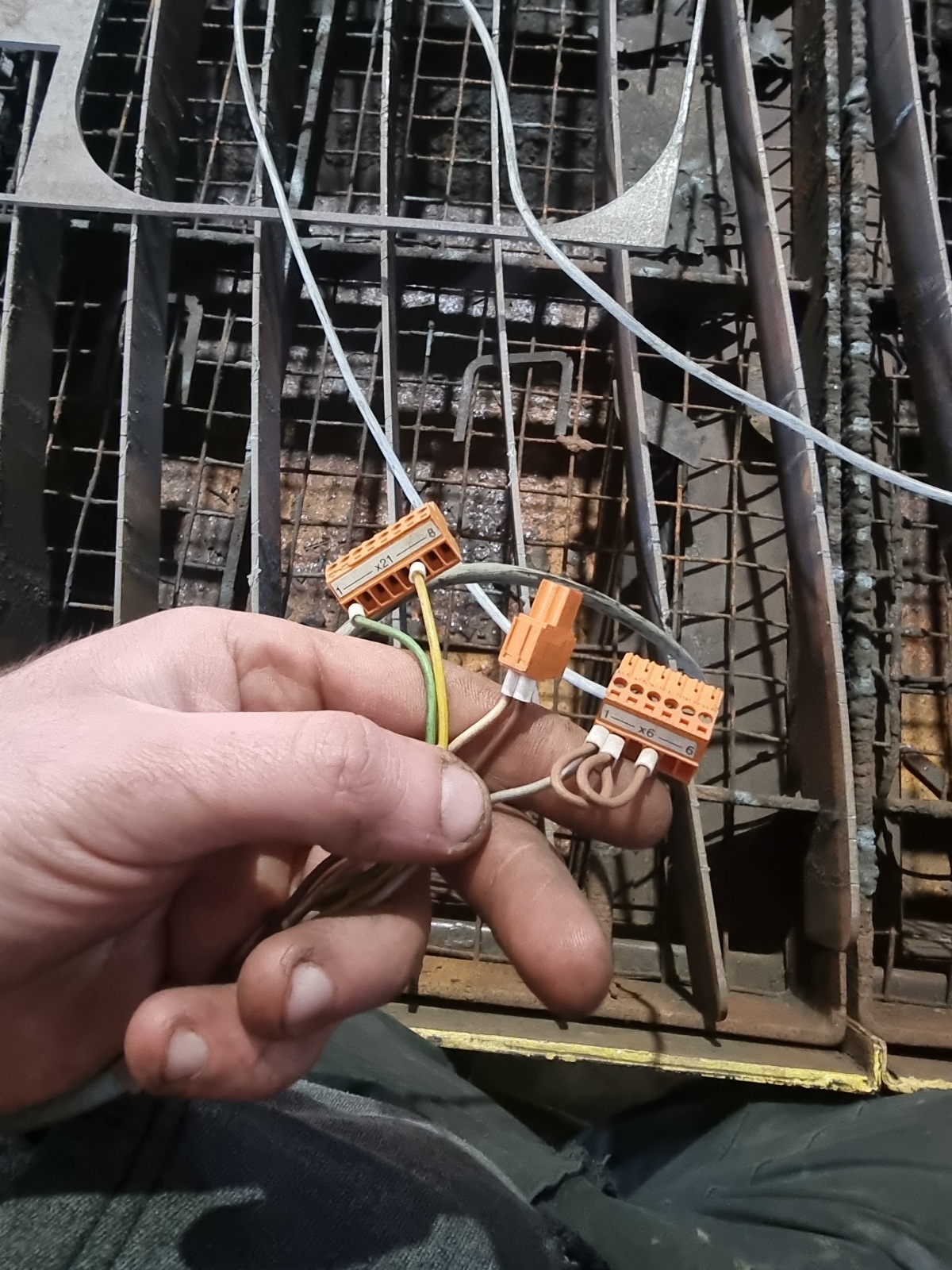

First picture DO NOT remove those connectors, do not touch anything on the power box.
Read the linked topics, there is everything there in detail.
Power box, right upper side, does it have 1 or 2 big relays, K1 and K2, or just K1 ?

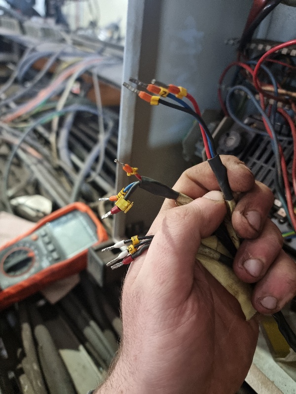

It is the dc drives which I will struggle with, my understanding is the the encoders will feed back to my mesa, however the drives themselves have the 3 smaller wires each which all go into the single vertical connector that sits on a raised steel folded section above the board which the 3 separate axis connectors with the heavier gauge wire plug into. Im guessing by the caps on the board and the heavy gauge these are for powering the motors, what are the other 3 wires for? Are there motor enable signals?

Do not touch the drives, do not touch anything in the power box, only the control box wiring.
There should be 3 wires for the drives that will be wired to Mesa 7i77 or 7i97 analog outputs, there is another "enable" wire on another connector that has to be wired to the Mesa field outputs as it needs 24V, and there are the sensor wires to be connected to Mesa field inputs, and the encoders to mesa encoder inputs for each axis.
You will also need to add OR change the Z axis motor/drive, the original one was controlled via RS232 so there is no easy way of using it. Find another analog servo drive and add an encoder to the existing Z motor, or get a set of motor/drive. A stepper motor and drive can be used but it will require flashing the Mesa 7i77 or using a parallel port. The one i helped retrofit in France got a new stepper and ANALOG stepper drive made by Lam Technologies.

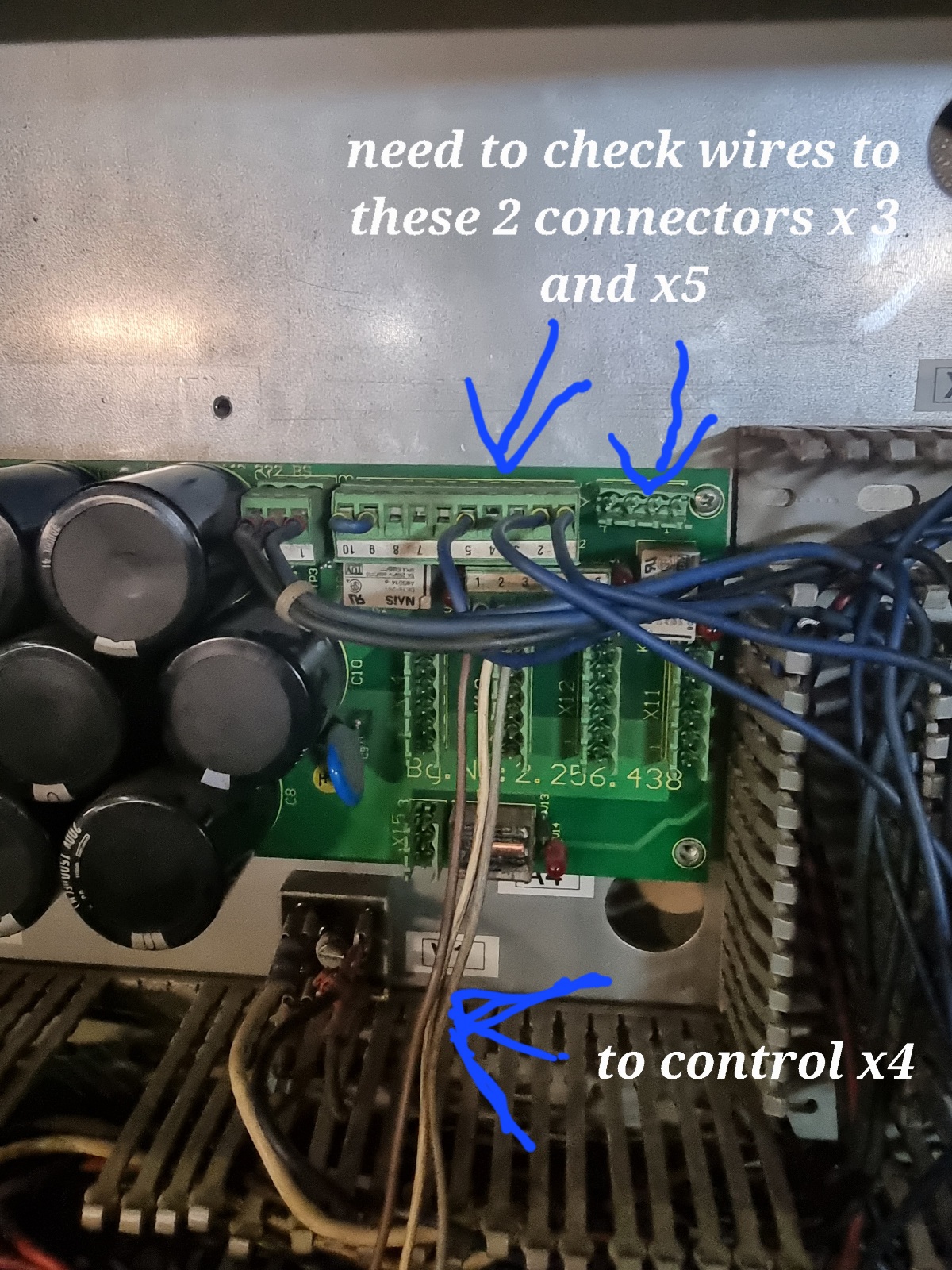

I think the 3 set of 3 wires pictured must be for the motor control, one is to sheild. The go back through a 12 pin connector and to the controlI had started to disassemble the box before I read you posts, I had removed blue wires to connectors X3 and X5 on the boards, 2 came from estop circuit and another blue has also been left hanging from the K1 contactor from terminal L3. If i had schematic i could make sure i have the 3 wires back correctly. The wires of course are ones with on markings!there is a 6 pin connector from the servo power supply board with 3 wires connected to in going back to the control, these go along with the air pressure switch wires, are these to pull on servo power?

Phew! user Esaber posted up electrical diagram, his is the same! Great!
