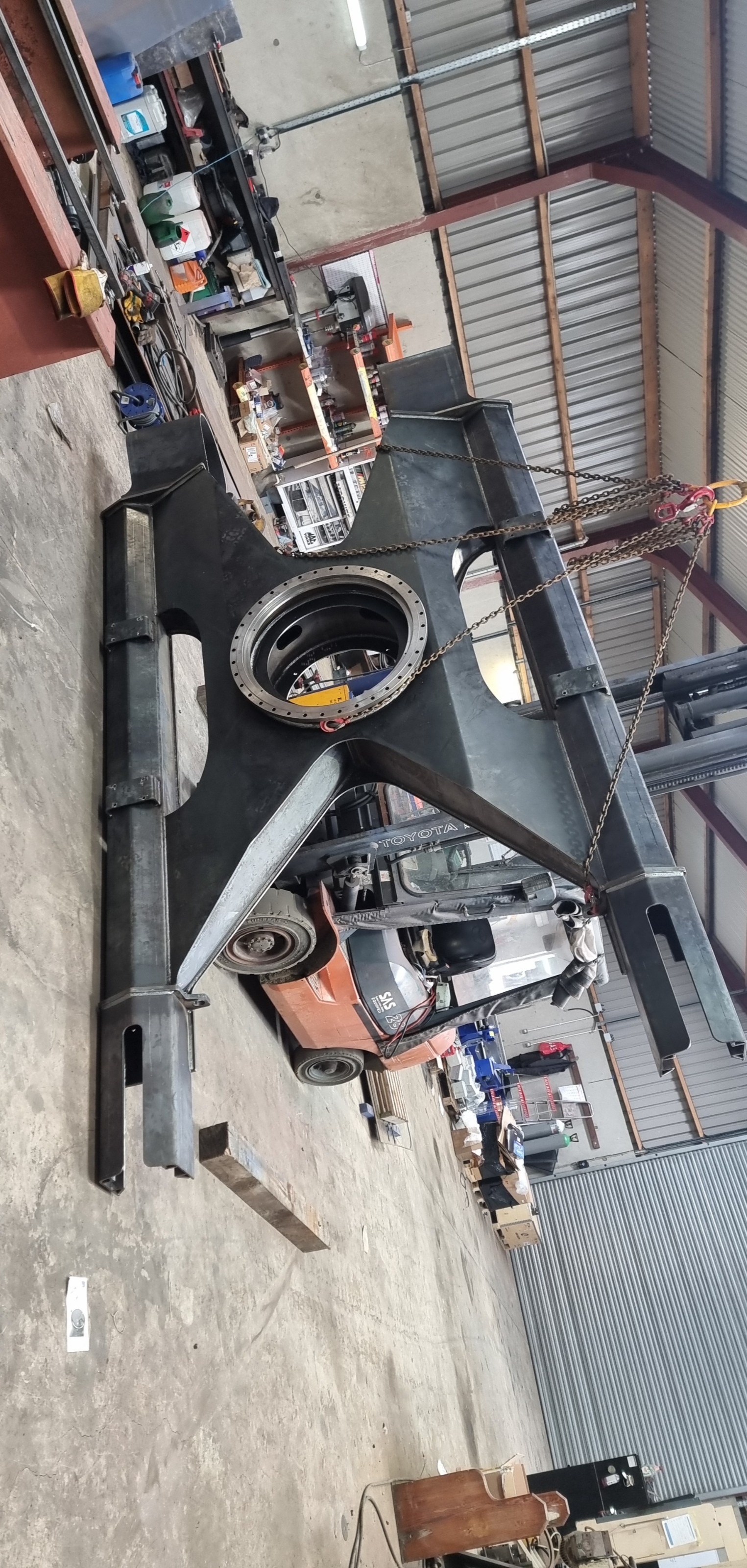

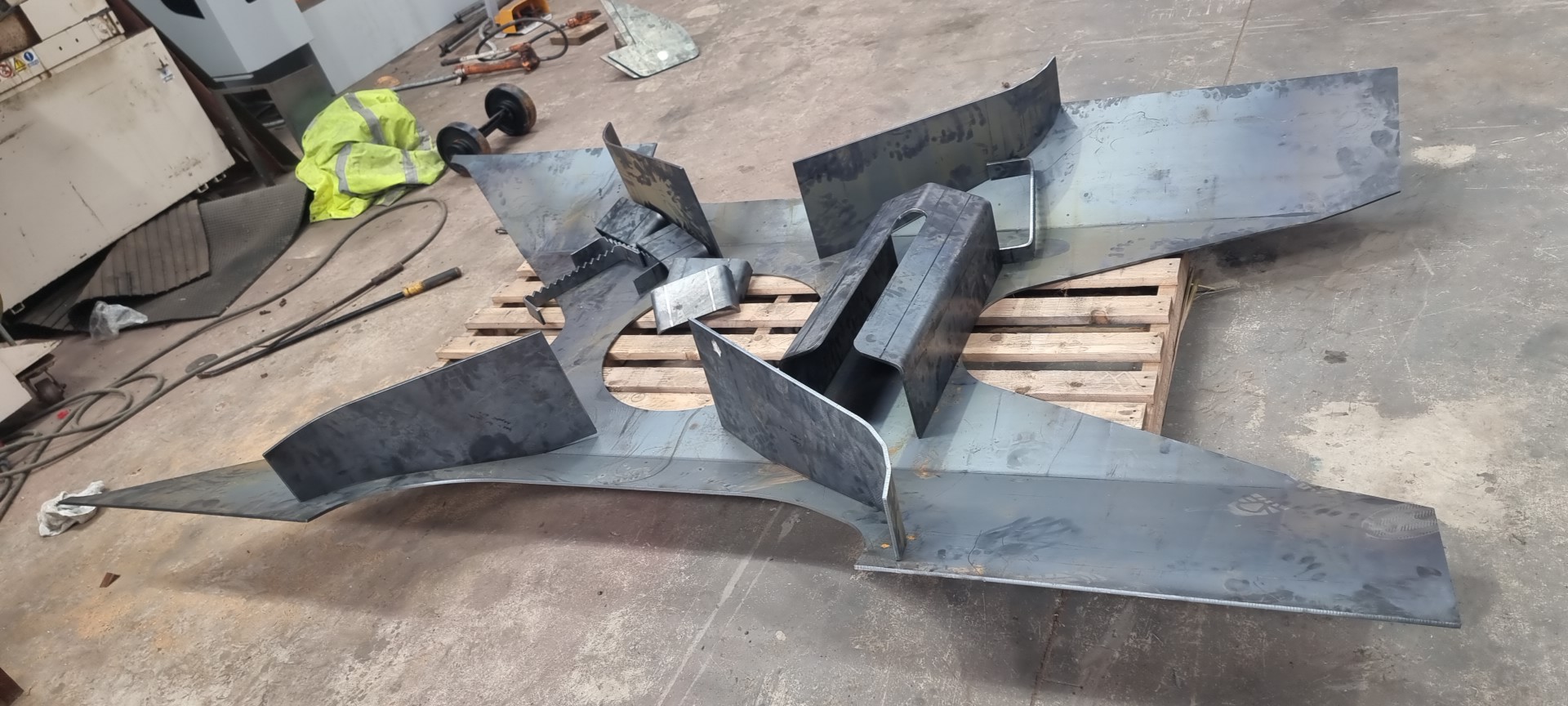

One of the first jobs, very happy. Done some 25mm plate also, performed very well.
- Posts: 21997
- Thank you received: 7488
12 Jul 2022 21:22 #247187
Replied by tommylight on topic Dc servo motor control
Is that the door to X men mansion?
Very nice, indeed.
Very nice, indeed.
