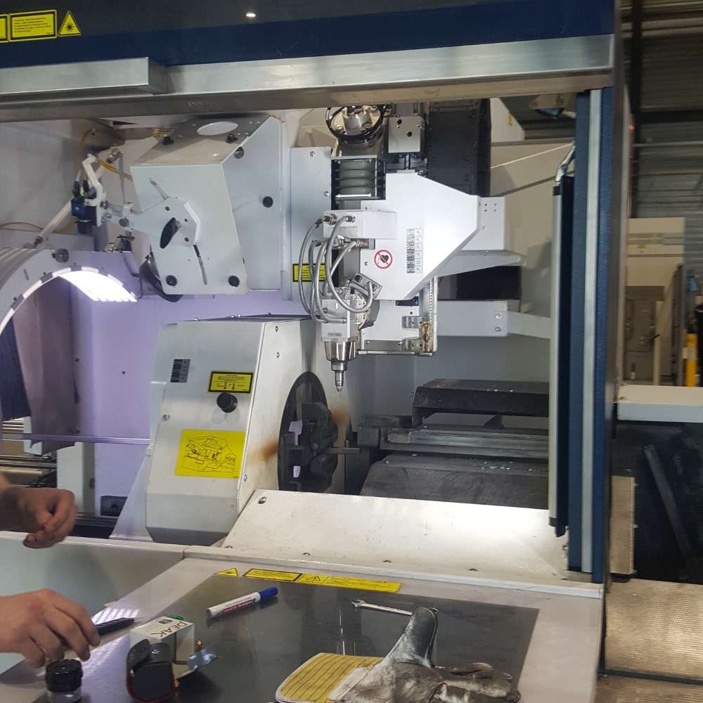

05 Jun 2019 15:42 - 05 Jun 2019 16:42 #135950 by Grotius
Replied by Grotius on topic Post Processor for LinuxCNC and PlasmaC
@Phill,
You do NOT need a cam program to use plasmac, I don't have one. All the samples are hand coded with the exception of the wrench which I think was originally done for my mill with dxftogcode.
Maybe you know i am trying to programming a dxf to gcode in c.
I started the c project with GTK and OpenGL and switched the project to QT c++ some time ago.
I just have made some progress to display some lines within QT. It's a stand alone program that can be called inside or outside of linuxcnc to generate parts from a dxf drawing.
My advise is to keep left a spare button in your PlasmaC Gmoccapy program wich has a image like CAM to startup a external cam program. Best way is to modernize the Gmocappy source code to call a external program using a screen button.
The python code for calling a external program via system takes about one line, so very easy to do.
@Rod,
In theory this should work just by changing the feed rate as the cornerlock feature of plasmac should kick in without the need to disable the THC from G code.
The sheetcam code widget's are really handy to use for small circles or shapes that need's presice accuracy. The standard is, that holes will result much nicer and will look nicer when cutting about 75% of contour cutting speed.
Me personally never used cornerlock or kerf crossing for plasma with all respect.
I think it's only usefull to use kerf crossing and cornerlock when switching a laser source into a plasma source on a german Trump laser. They are much more reactive.
For the future of Linuxcnc plasma we need a automated dxf layer based strategy, just like the code snippets provided in sheetcam.
Every layer has a option for speed or kerf or power etc.
And we need cam program's to provide a command line input option for linux system command. That will improve the power a lot.
Imagine that you don't have to start up a cam program. All system input's are done by linuxcnc. Output is direct ngc code.
This can be called a universal program standard without actually displaying the specific program, it run's in background. Only providing the code we want to achieve.
So manybe i have a different look at the future of cam related program's. This idea has evolved trough experience with linuxcnc.
The fear point of Cam provider's is the GPL2 licence. Draftsight 2019 update is very good, and non free for windows users, why?
It's only because Freecad become's more and more powerfull. Autodesk is afraid to loose the dominant position (microsoft position) trouhh very good open source cad program's. In the end everything will be open source. But we need to fear the GPL3 licences.
www.gnu.org/licenses/gpl-3.0.nl.html
en.wikipedia.org/wiki/Ubuntu
So we can distribute linuxcnc with Ubuntu wihout any problem or with LinuxMint, also a open source distribution.
Last edit: 05 Jun 2019 16:42 by Grotius.
