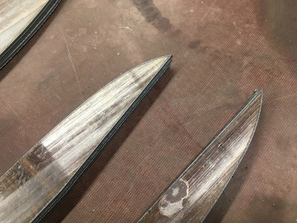

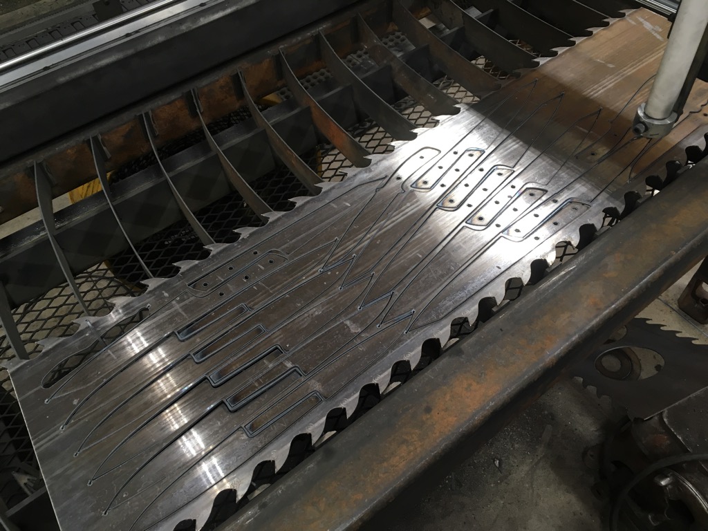

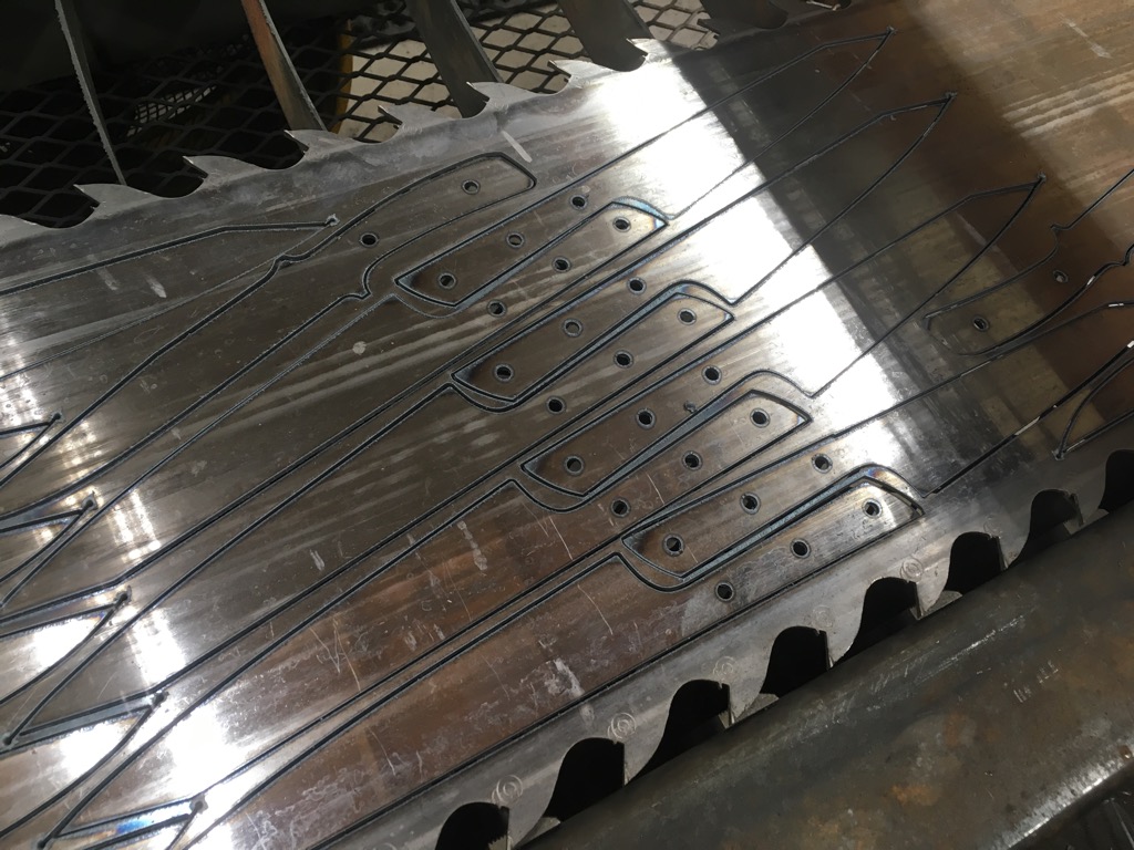

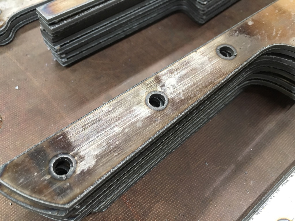

I guess my question is,
why is sheetcam posting 3 diffrent feed rates. I would think we would only need the one feedrate that gets updated from plasmac. The fixed feedrates that sheetcam puts in there where messing me up. Especially the F3.937 as it was moving so slow that the arc voltage would shoot way high and then then torch would dive into the table when it hit the F100.0
My thought is plasmac should set the feedrates and if the machine can’t do that feedrates it set then corner locking is on. It’s kinda frustrating having to have a feed rate in the gcode that matches the feed rate set in plasmac in order for corner locking to work. Being new to this I’m still veryhands on and adjusting voltage/speed on the fly to find what I really like.
Last night I was cutting these and had to enable M1 so I could switch THC off when it did the small holes. It would be nice if I could just have a tool for these holes that had the THC disabled.

11 Jun 2019 02:58 #136533 by JTknives
Replied by JTknives on topic Post Processor for LinuxCNC and PlasmaC
I looked in sheetcam and I have that f3.nnn called out as plunge speed . And above it I have 100in/sec cut speed. So that is why it was plunging so slow and arcing out. I kinda worked around the problem of diving down while cutting holes. My temp solution was to set THC delay just long enough for it to complete the hole befor it turns it on.
11 Jun 2019 03:17 #136536 by tommylight
Replied by tommylight on topic Post Processor for LinuxCNC and PlasmaC
In that case you can edit the post processor to output a more reasonable feed speed.
