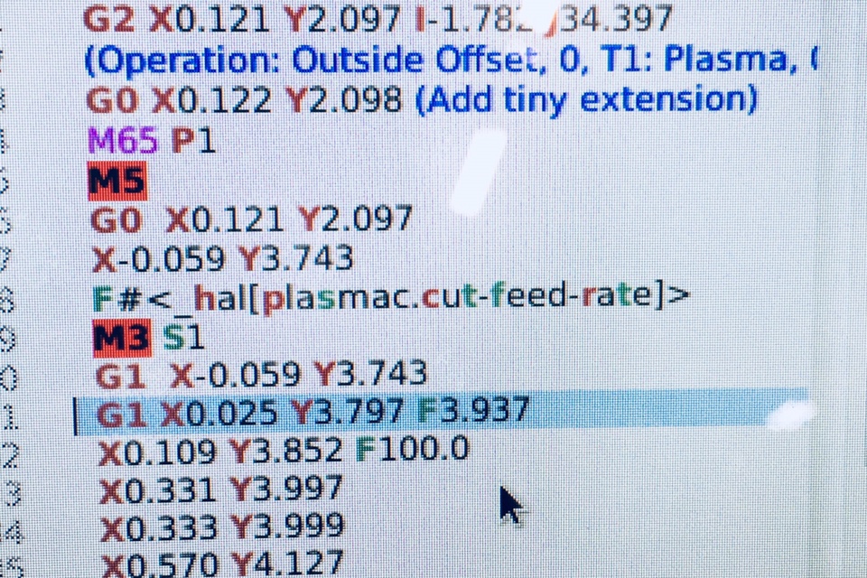

- JTknives
- Posts: 243
- Thank you received: 32
10 Jun 2019 08:29 #136449
by JTknives
Replied by JTknives on topic Post Processor for LinuxCNC and PlasmaC
- Posts: 12118
- Thank you received: 4138
10 Jun 2019 08:47 #136451
Replied by rodw on topic Post Processor for LinuxCNC and PlasmaC
Thats actually expected behaviour as its retrieving the feed rate defined in Plasmac.
Its a bit different for you because you don't have cut charts but if you had some already set up in sheetcam, Phill provided a materialverter script that will export the sheetcam tools to plasmac format.
All you have to do is make sure the plasmac and sheetcam tool numbers agree and keep the settings in plasmac.
Also, create a tool called "CENTERPUNCH". Then if you have holes you just want to mark hole centres for subsequent drilling, you can create a new layer in sheetcam and move your holes to that layer. Then do a drill operation with the centerpunch tool on that layer and it will spot them for you. It is pretty cool watching plasmac swap the tools and updating the GUI on auto pilot!
- phillc54
- Posts: 5711
- Thank you received: 2100
10 Jun 2019 10:54 - 10 Jun 2019 10:56 #136454
by phillc54
Replied by phillc54 on topic Post Processor for LinuxCNC and PlasmaC
If you define a F word like the F 3.937 then linuxcnc will use that as the feed rate. I don't think they should be there.
Cheers, Phill.
Cheers, Phill.
