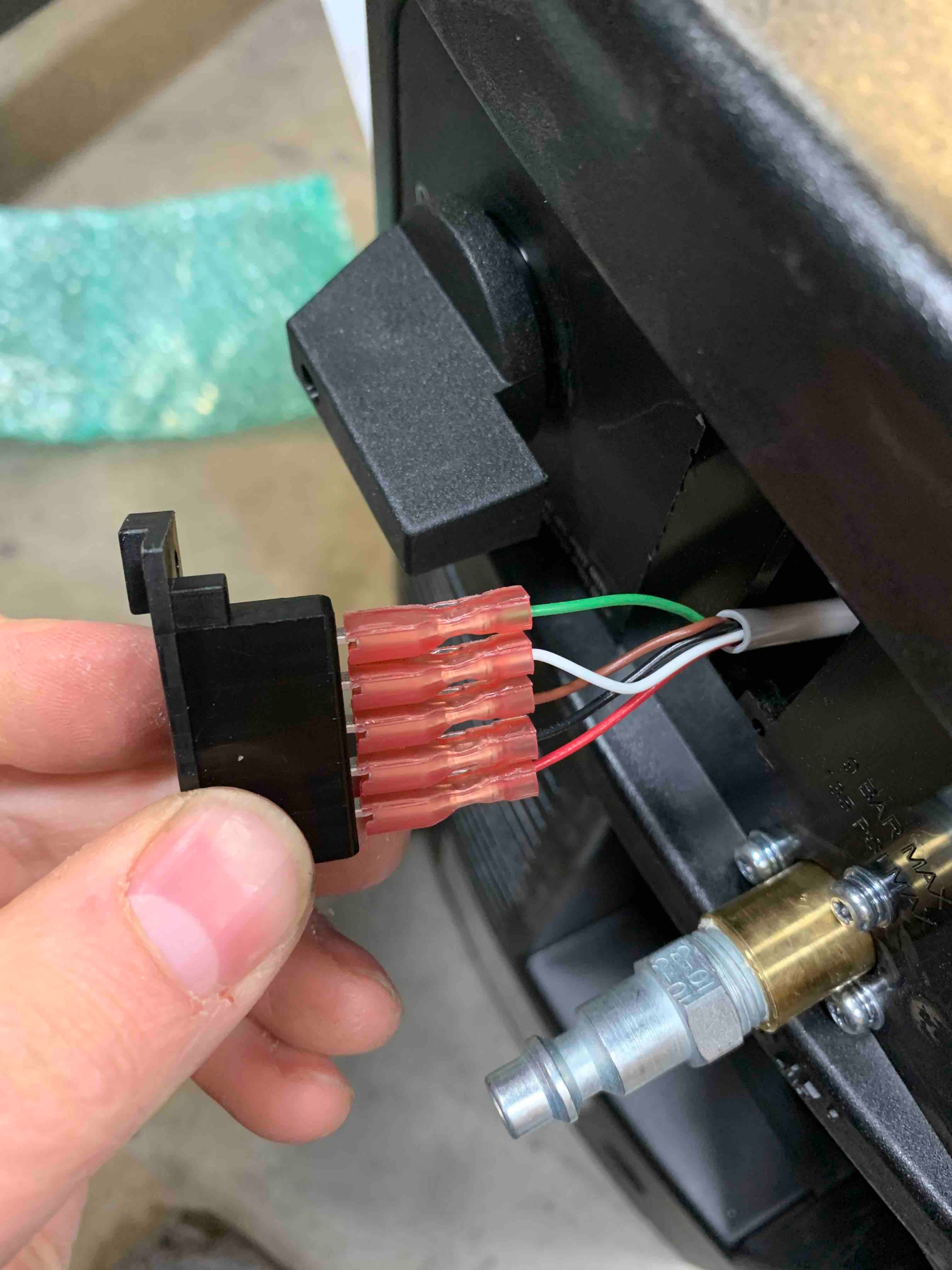

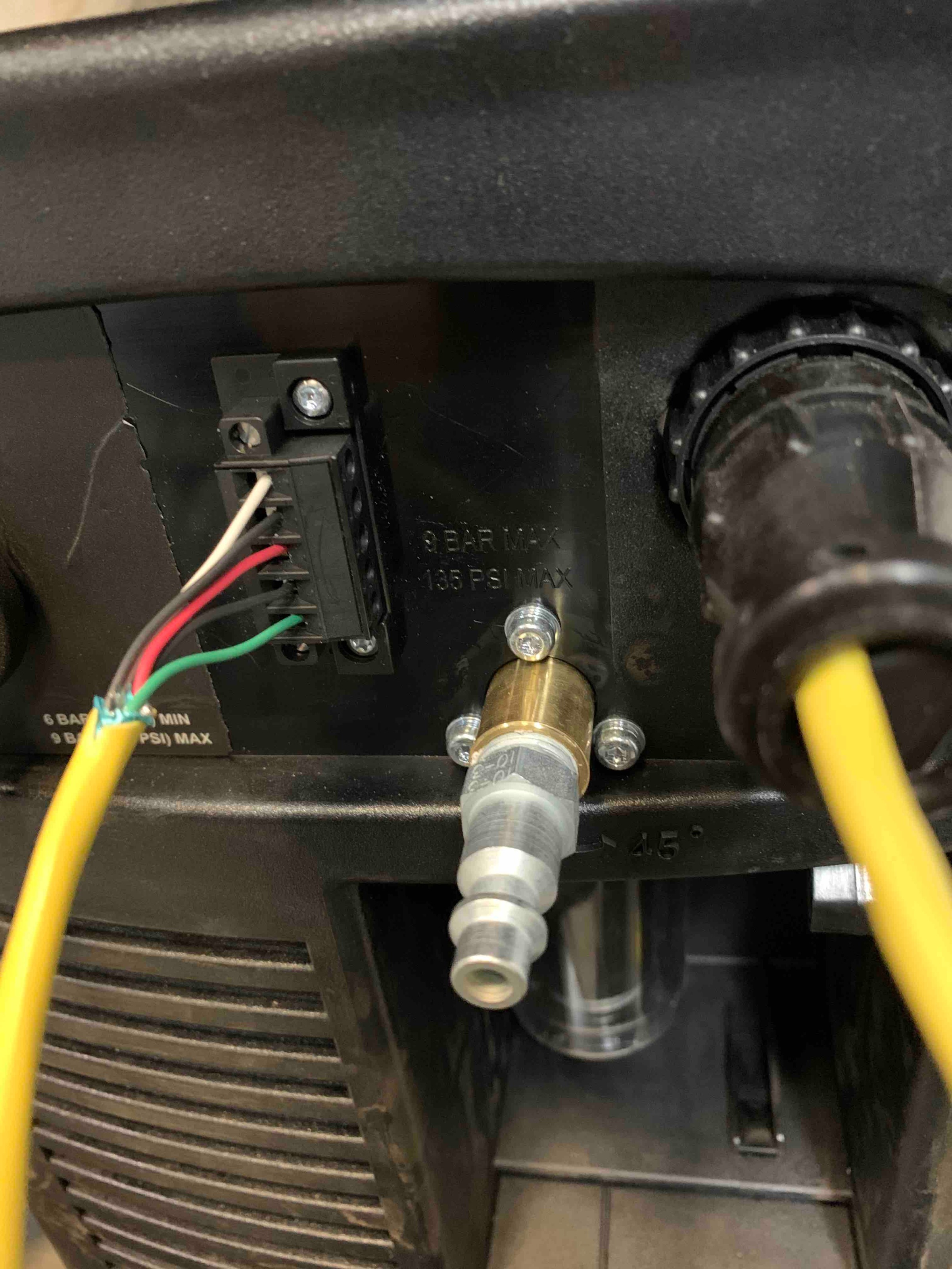

17 Apr 2020 17:53 #164285
by snowgoer540
Replied by snowgoer540 on topic RS485 For Hypertherms
so, I just noticed that the diagram for the location of pin 1 on the hypertherm in the user guide is different than what I see at my machine.
Pics attached. I couldnt find anything on hypertherm's end to verify.
Inside is with the connector pulled out of the machine. it's actually upside down in this pic (green is at the bottom). Also, I never messed with these, it's how it came pre wired from the factory.
outside obv shows my setup, with ground in pin 5 (at the bottom).
