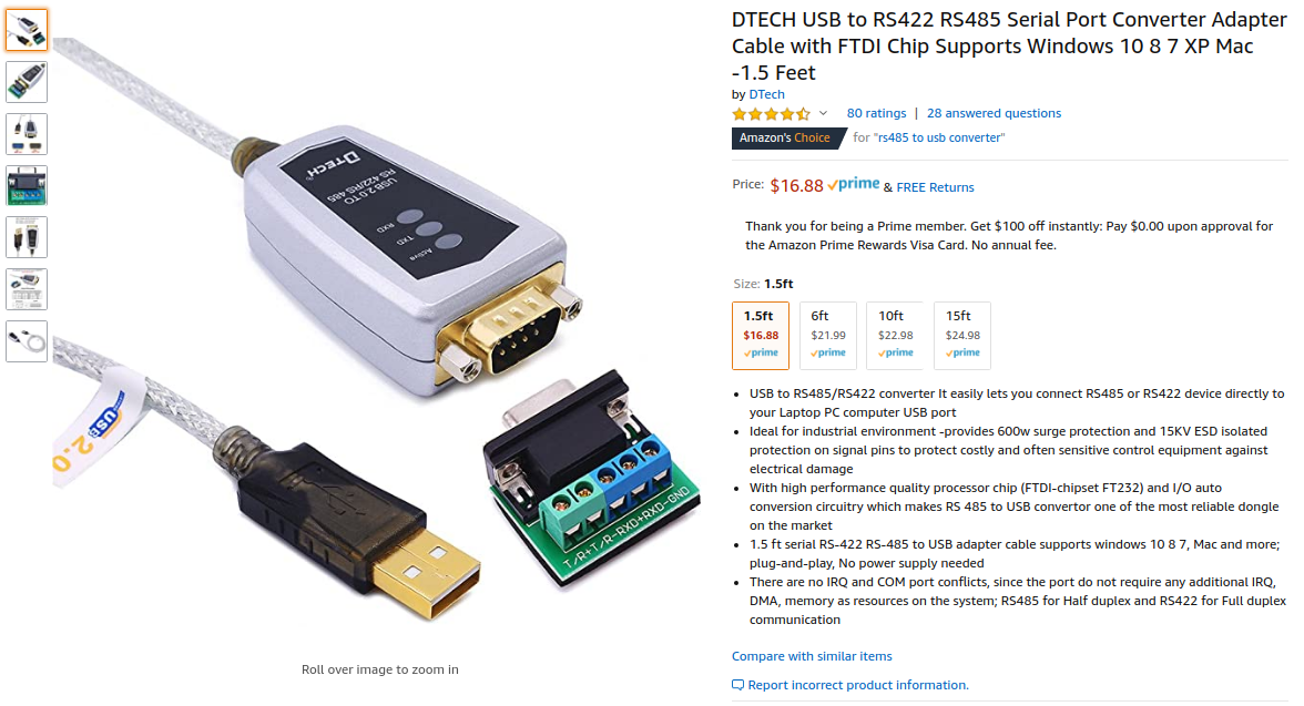

Update: I bought
this one
to test USB to RS-485. It should be here tomorrow, I'll test over the weekend as well, and report back. I chose this brand because it's what my RS-232 to RS-485 converter is, and that works perfect.

03 Jul 2020 18:56 #173535
by snowgoer540
Easy testing today. USB to RS485 showed up, hooked it up, ran Phill's pmx_test.py, selected the correct port, connected with no issues, everything works as it should. I would highly recommend we add this to the appendix for people who dont want to play with serial cards (which were more expensive and required a converter, etc.).
Screenshot of what I bought:
Replied by snowgoer540 on topic RS485 For Hypertherms
Update: I bought this one to test USB to RS-485. It should be here tomorrow, I'll test over the weekend as well, and report back. I chose this brand because it's what my RS-232 to RS-485 converter is, and that works perfect.
