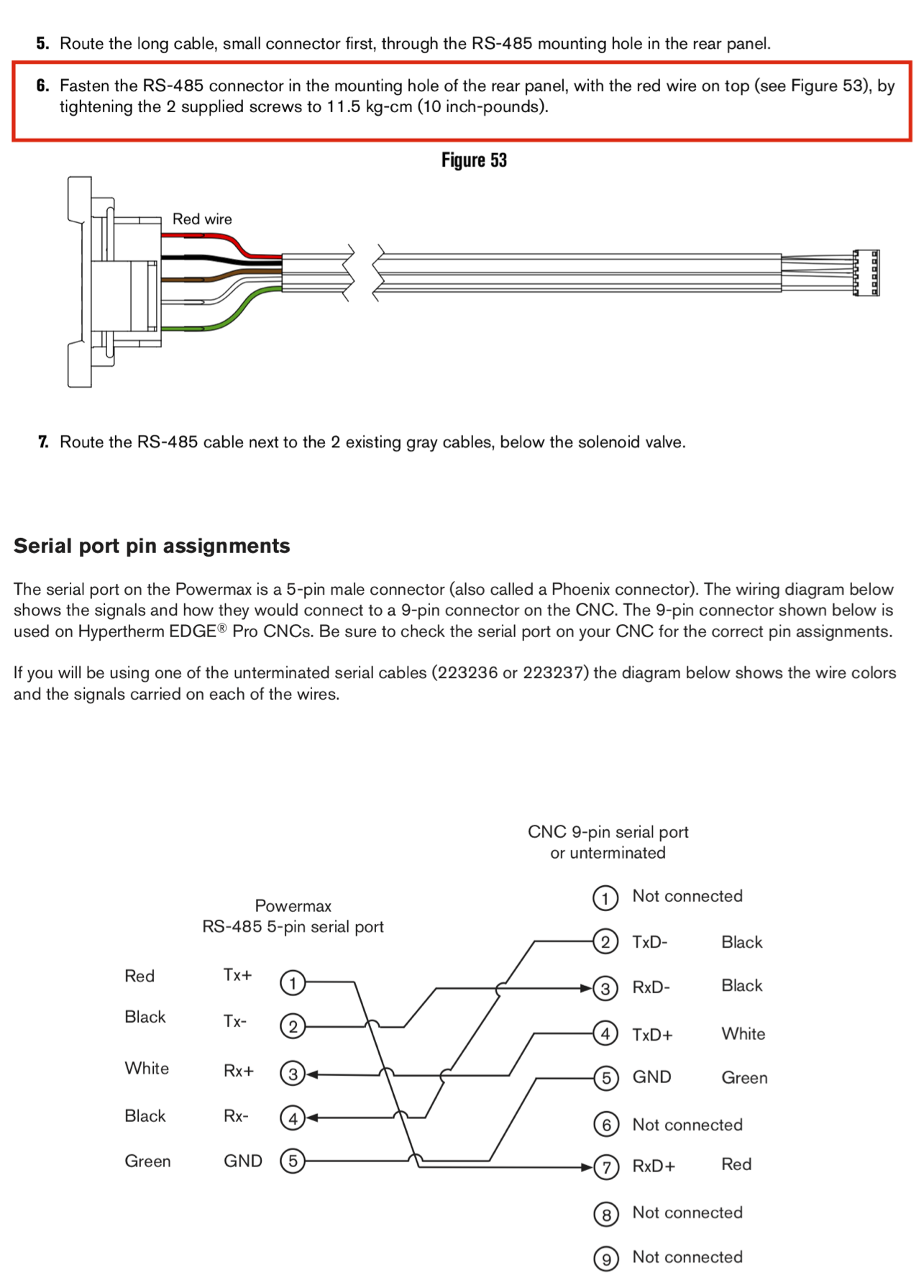

These extracts seem to show that pin 1 should be at the top, maybe Stefan will see this after he finishes his
cool part tumbler
and will chime in.

yep, that matches what I see on my machine. Maybe Stefan got his backwards somehow

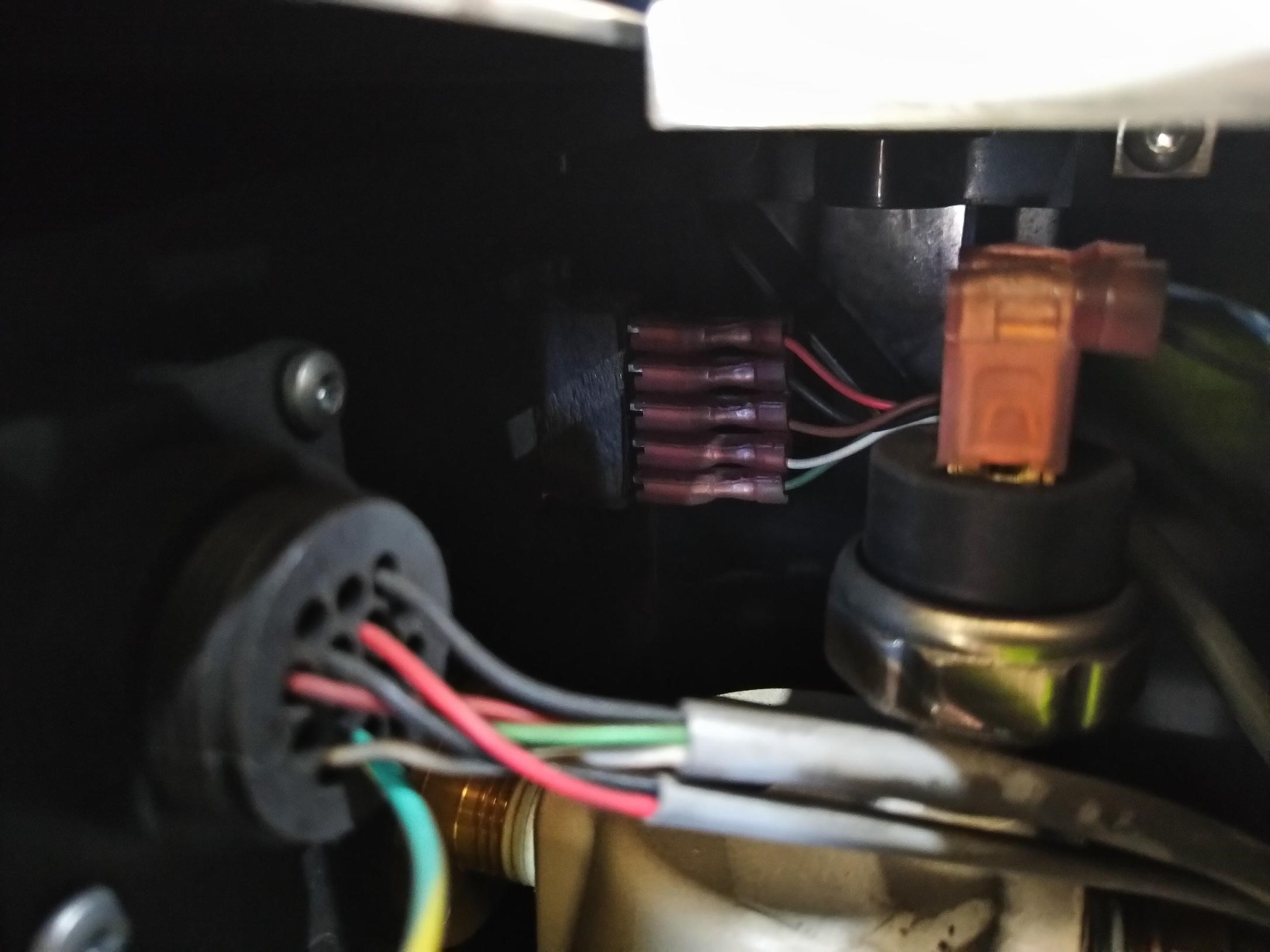

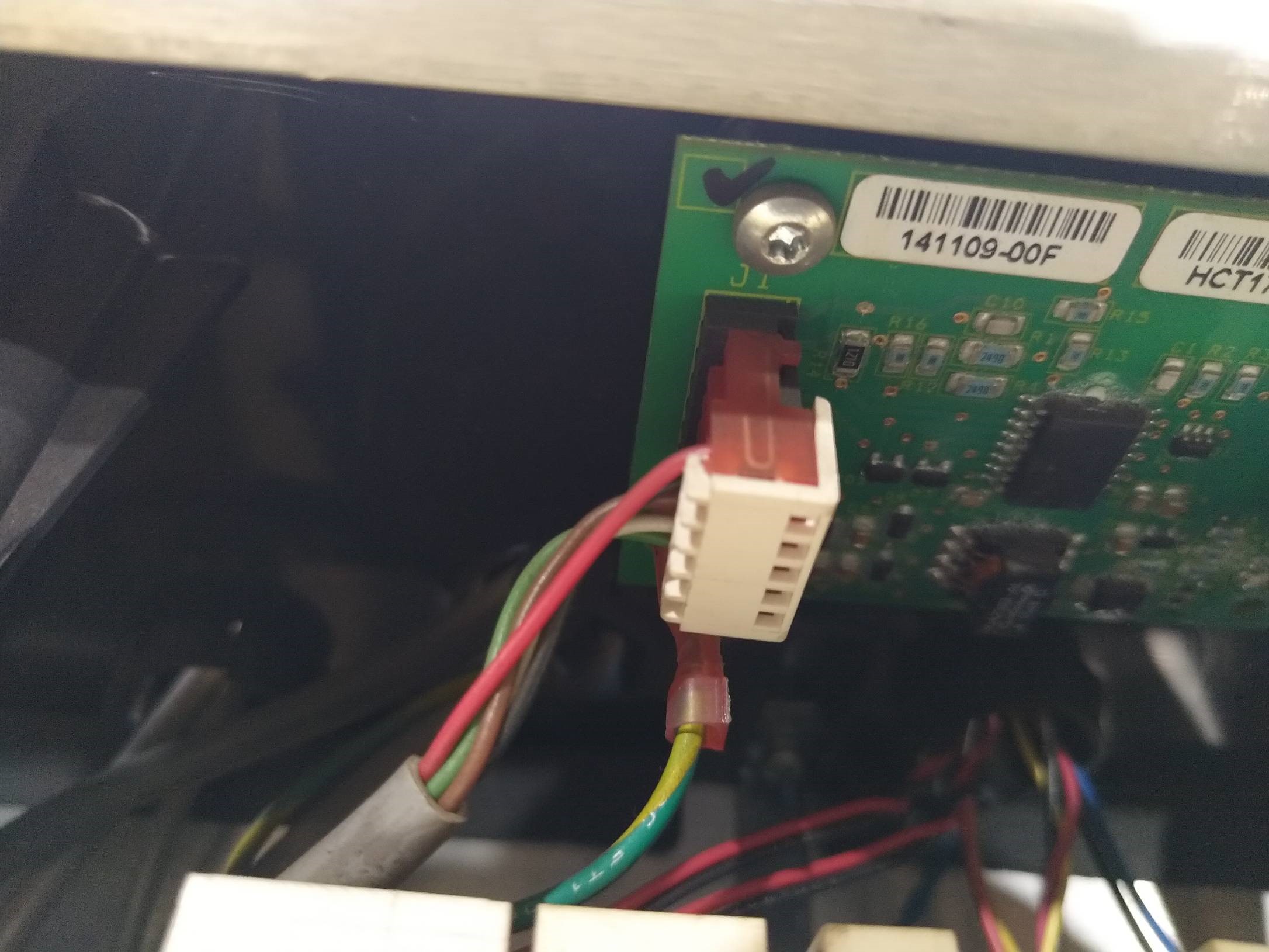

I find this interesting. I am away from work for a few days so when I get back I will pull out the RS485 wiring on the machine and see how its mapped.

Ok I have Finally checked my machine, and the wires match the diagram.

Does that mean pin 1 is at the top here: linuxcnc.org/docs/2.8/html/plasma/plasma...ml#rs485_connections
