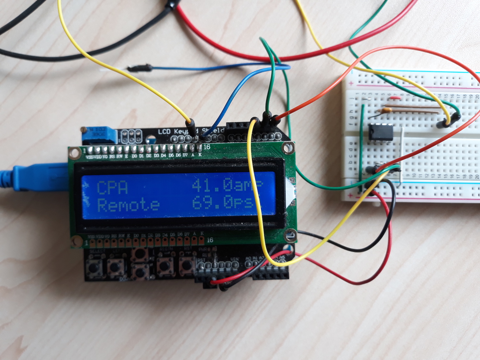

10 Apr 2020 03:07 #163440 by phillc54
Replied by phillc54 on topic RS485 For Hypertherms
Here is the next try at getting the port tester right.
Would it be possible for you to switch your machine to bar for a test and get me the min and max values to add to the imperial set you posted before.
I think I will spend a bit of time getting the Arduino to spit out the same values as that would make my testing a bit more comprehensive. It would be nice to get all these values for all the Powermax models.
I thought I would throw in a pic of my pmax000...
I will test it tomorrow morning, and definitely I can get the Bar values as well, sorry I should have thought of that. Wish I could help with all of the values from all models. I looked in my manual and couldn’t find them there for mine... I just got them from the screen prior to your changing the code to read it from the machine. The protocol manual seems a bit outdated as well, but I guess it works.
Haha the pmax000, that’s awesome. Seems like it uses a lot less electricity than mine lol. I have always been intrigued by reverse engineering. I wonder what it would take to reverse engineer the chip/interface on the power max side. Probably a lot of time none of us have for starters hah.

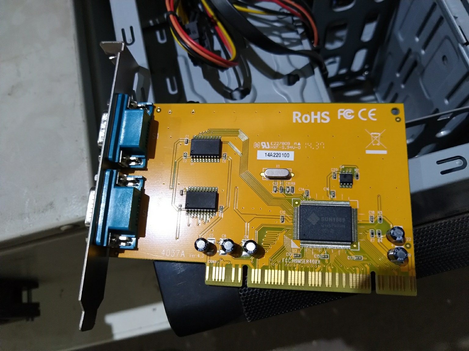

  • thefabricator03
  • thefabricator03's Avatar
  • Visitor
  • Visitor
10 Apr 2020 05:12 - 10 Apr 2020 05:14 #163447 by thefabricator03
Replied by thefabricator03 on topic RS485 For Hypertherms
Ok, I have checked everything and I am not sure how this is working,
The card I am using,
www.sunix.com/en/product_detail.php?pid=135
And the connector I am using to the card,
The connector is just a straight through connector, no conversion of signals. The pins map to 1-5 on the DB9 connector.
I was under the impression that this was the brains of the conversion for the USB to RS485 converter.
Not sure how it is working but it is working for me.
Last edit: 10 Apr 2020 05:14 by thefabricator03.

10 Apr 2020 16:54 #163511 by snowgoer540
Replied by snowgoer540 on topic RS485 For Hypertherms
Haha, me either. Although in my search for the answer, I was able to find a pdf for a card (attached) that uses the same SUN1889 serial chip as your card. The PDF shows that the chip IS capable of RS-485, even though the manual for the card you have says it is RS-232 specific.
So it would seem that my card claimed it CAN do RS-485 and CANT, and your card claimed it CANT do RS-485 and CAN. :laugh:
At any rate, I ended up hooking mine up to the COM header on the motherboard. I haven't tried to use it without the converter, maybe I'd be in the same boat. I'll try it later when I try Phill's new code. Mostly out of curiosity.
