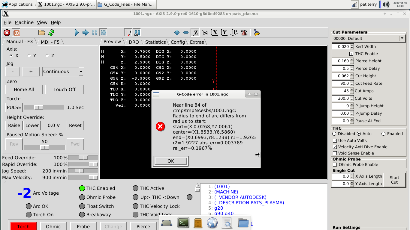

08 May 2020 13:27 #167069
by dvn4life1972
Replied by dvn4life1972 on topic Fusion 360 post processor file for Plamac
I appreciate the time and effort put into this pp. I couldn't dream of making an attempt at it. I've tried to use it several times, and I keep getting the same type of error at the machine when I load the gcode file. I've attached a screenshot of the error message as well as attached the gcode file itself.
Pat
Pat
- phillc54
- Posts: 5711
- Thank you received: 2100
08 May 2020 18:32 #167088
by phillc54
Replied by phillc54 on topic Fusion 360 post processor file for Plamac
Maybe it needs some more digits of precision for the calculations.
You could try changing CENTER_ARC_RADIUS_TOLERANCE_INCH to say 0.004
linuxcnc.org/docs/2.8/html/config/ini-co...l#gcode:ini-features

- CFE
- Posts: 193
- Thank you received: 35
21 Jul 2020 21:56 #175372
by CFE
Replied by CFE on topic Fusion 360 post processor file for Plamac
In the 'Property' section of the Post Process dialog box in Fusion change the "MergeCircles" value to "NO" this will fix the radius differs issue
