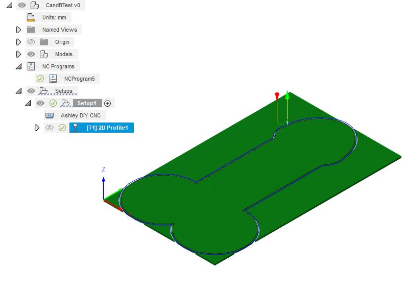

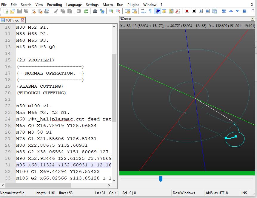

I used the F360 post processor for the first time today. I got it from forum.linuxcnc.org/plasmac/38438-plasmac-post-processors#159042. Seemed to all work fine until I tried to run the generated g code in Plasmac (qtPlasmac). I got some error messages about arcs not have correct start and ends on line 31. So, I opened the g code in a viewer, and sure enough, the arc on line 31 is incorrect.
Did I mess something up, or is this a gremlin? And yes, the part is what it looks like! F360 and g code file attached.
