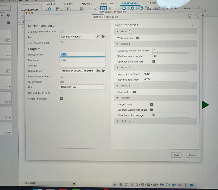

13 Jun 2024 11:18 - 13 Jun 2024 11:44 #302956
by RMJ fabrication
Replied by RMJ fabrication on topic Fusion 360 post processor file for Plamac
I installed the fusion360 post processor from here forum.linuxcnc.org/plasmac/38438-plasmac-post-processors#159042 and I am unable to get it to produce valid gcode successfully. I am trying to cut out a simple 10" sign and this is the error message I get every time I try to load the gcode into qtplasmac. I also cannot see the part on the screen. Attached is my post process window, can someone please guide me on how to proceed correctly making gcode files with fusion360 thanks!

13 Jun 2024 14:38 #302965
by snowgoer540
Replied by snowgoer540 on topic Fusion 360 post processor file for Plamac
It means you’re calling a material number that doesn’t exist/is not set up in qtplasmac. Simply create a material with the appropriate settings on the parameters tab with the material number you’re referencing and all should be well.

26 Jun 2024 17:30 #303856
by RMJ fabrication
I am now running into this error again with every new gcode file I make and I didn't change anything. All the Gcode files look exactly the same as the one that works coming out of fusion. Qtplasmac keeps adding M02 (end program) to the first line of my gcode files. please can anyone help, what number does the material number need to match in order to stop qtplasmac from doing this?

26 Jun 2024 18:41 #303859
by phillc54
Replied by phillc54 on topic Fusion 360 post processor file for Plamac
Check that all material numbers called in the G-code file do exist in the QtPlasmaC materials.

26 Jun 2024 19:12 #303860
by RMJ fabrication
Ok I got it now thank you so much sir. I created a new material with the material number one thats all I was missing.
