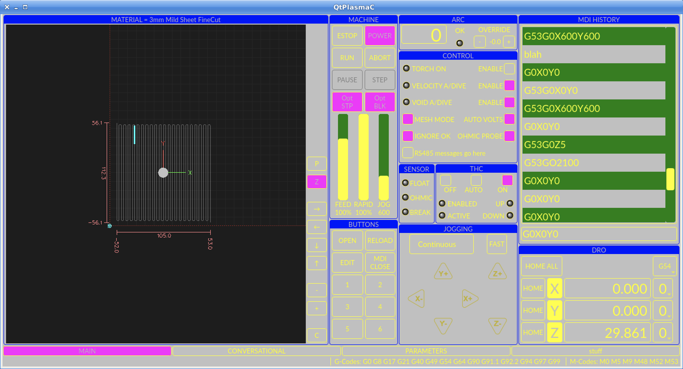

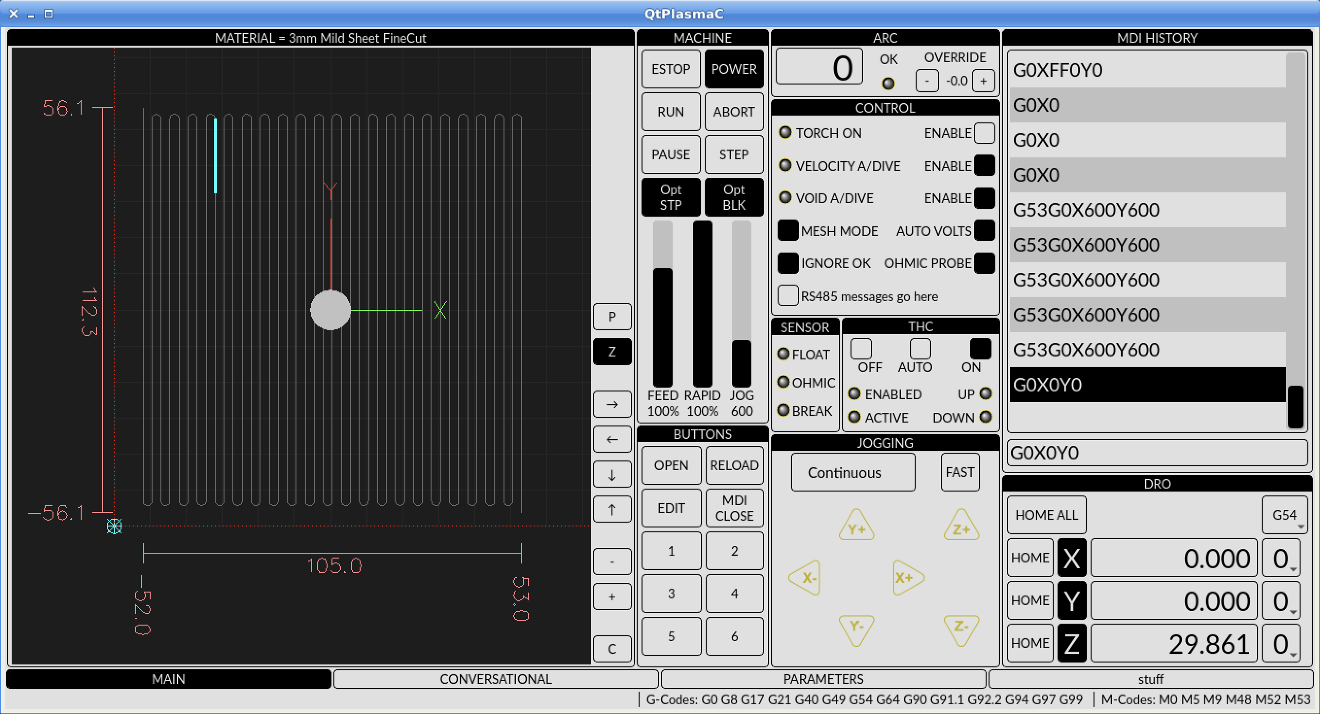

- Are all of the colors and indicators easily visible with plasma shades on (tinted cutting glasses)
- Will the dark screen be subject to a bad glare from bright shop lights as opposed to a lighter colored screen?
None of this was taken into consideration as I was plodding along I was making it easy on my old eyes as I was working on it. The intention is the have colors changable by the user. This will only be done in groups, so foreground is a colour group, background is a colour group, frames and tiltles are a colour group etc. I'll add a pic that shows the diferent groups albeit garishly. Doing this means that I may need to revert the jog buttons to text as I have no clue how (or if) images can be recoloured (see the grey pic below).

Grey:
Warning: Spoiler!
Color Groups:
Warning: Spoiler!
The following user(s) said Thank You: tommylight, Clive S, rodw, Grotius, snowgoer540, pinder

Hi Phil,
The gray one looks nice.
