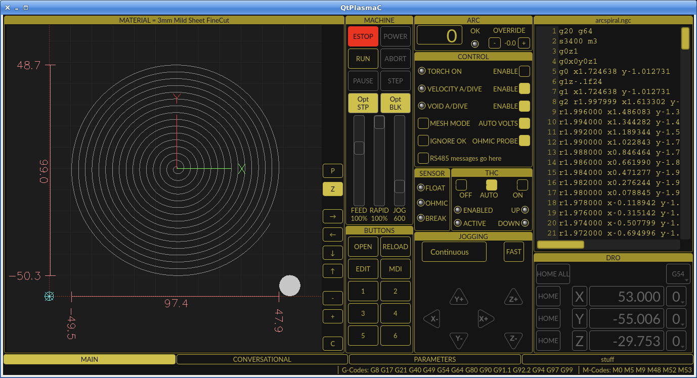

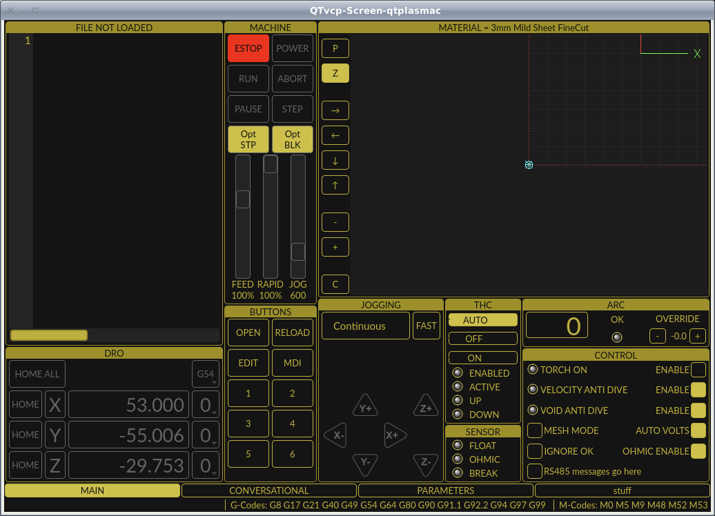

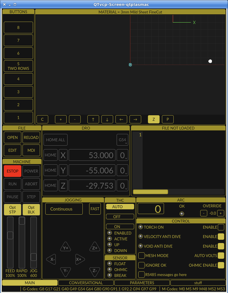

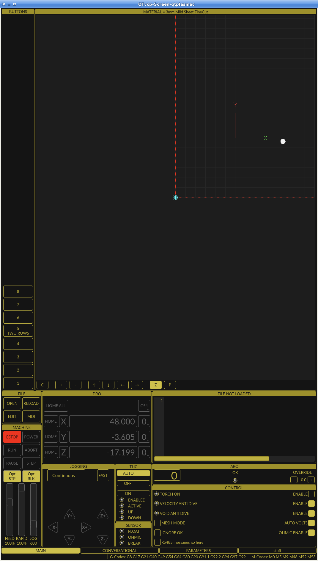

I have revived this thread because I have done a bit of work on a GUI based on the
pinder
theme.
I have three versions, a landscape 4:3 version, a landscape 16:9 version and a portrait version. All screens are resizable. The minimum monitor sizes required are: 4:3 = 1024x768, 16:9 = 1366x768, portrait = 768x1024.
Still a lot to do but I think the main page layout is close.
Some screenshots of where I am at:
16:9 1366x768:
4:3 1024x768:
portrait 768x1024:
portrait 1080x1920
