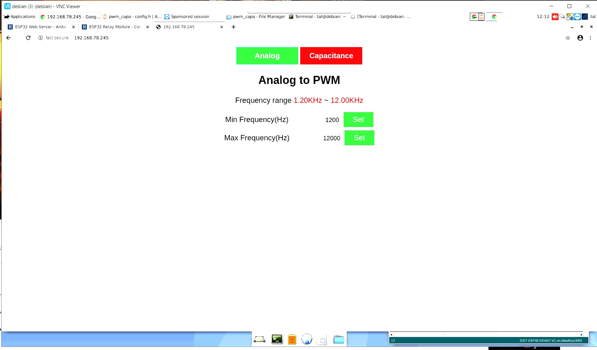

- taloot
- Posts: 175
- Thank you received: 89
30 Jul 2020 15:46 - 30 Jul 2020 15:57 #176536
by taloot
Replied by taloot on topic PlasmaC Fiber laser 1Kw head height control + auto focuas
the main diffrance between laser and plasma is as follow
laser have PWM on 24v for modulating of the laser
0-10 v to set the power
enable / disable for shutter
gas control also another story
there is pricing gas pressure and cutting gas pressure
this is connect to 0-10v --- to SMC propotional regulator this is for o2 only
for n2 only on and off valve and same to air..
i make qtpyvcp using serial comm to laser source source,, but u still need PWM pin
capacitance sensor i make already..
if anyone have an idea about any one of those and how to make it the correct way let me know
so there is pircing and cutting each one need the follow
freq 0-20khz depent on ur laser
power 10 -100
gas type N2 O2 Air
gas pressure in psi
foucs setting <--- this is only important when u cut thick metal
i have chinese cutting system... but its very weak compare to linuxcnc,., no way to compare
power 10 -100
gas type N2 O2 Air
gas pressure in psi

- Posts: 21957
- Thank you received: 7478
30 Jul 2020 16:58 #176541
Replied by tommylight on topic PlasmaC Fiber laser 1Kw head height control + auto focuas
PWM is quite easy to do with discrete elements, 2 transistors and some resistors.

- taloot
- Posts: 175
30 Jul 2020 17:06 - 30 Jul 2020 17:11 #176543
by taloot
7i7e i think it should work without the need for the converter
Last edit: 30 Jul 2020 17:11 by taloot.
- taloot
- Posts: 175
30 Jul 2020 17:10 #176544
by taloot
i have this for this application
store.mesanet.com/index.php?route=produc...69_63&product_id=290PWM is quite easy to do with discrete elements, 2 transistors and some resistors.
