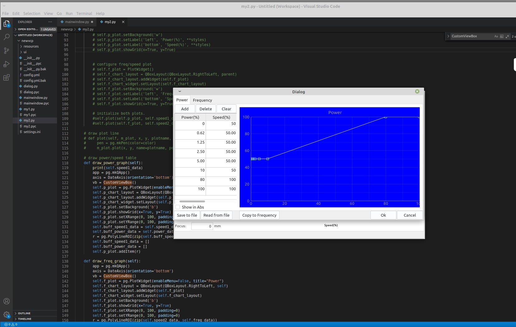

okey i have done
1 capacitance sensor to replace the THCAD
2 laser comm using rs232 similar as ur python script
3 gas control console monitor and control (qtpyvcp)
4 independent laser setting while cut or while mark or pierce (qtpyvcp)
5 dynamic power curve ( speed vs laser power or PWM freq)
6 focus setting

i will use 2 pwm to analog convertor (0-10v)
1 for laser
2 for gas valve
is it to linked to spindle control?
if yes can i load 2 spindles?

you are following right
exactly 3 pwm generator
2 for the metioned above
and 1 for laser it self.. (24v PWM)
can i use PWMgen instead? if so can i see example?
a lot of options,, but they are important for mirror finish cutting
i will buy ready made convertor, but how can i link it inside hal file
do i have to load pwmgen,, for each function
