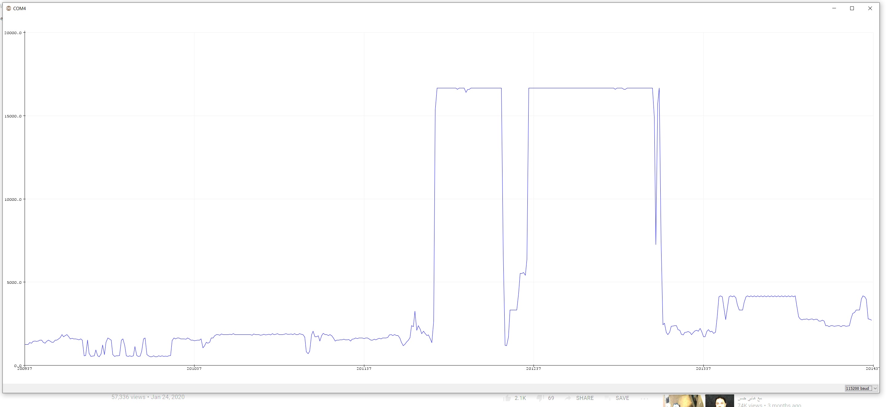

24 Apr 2020 16:35 - 24 Apr 2020 16:38 #165411 by taloot
1st capacitance testing
it need to be calibrated for each sheet size
im comparing esp32 and stm32
Last edit: 24 Apr 2020 16:38 by taloot.
