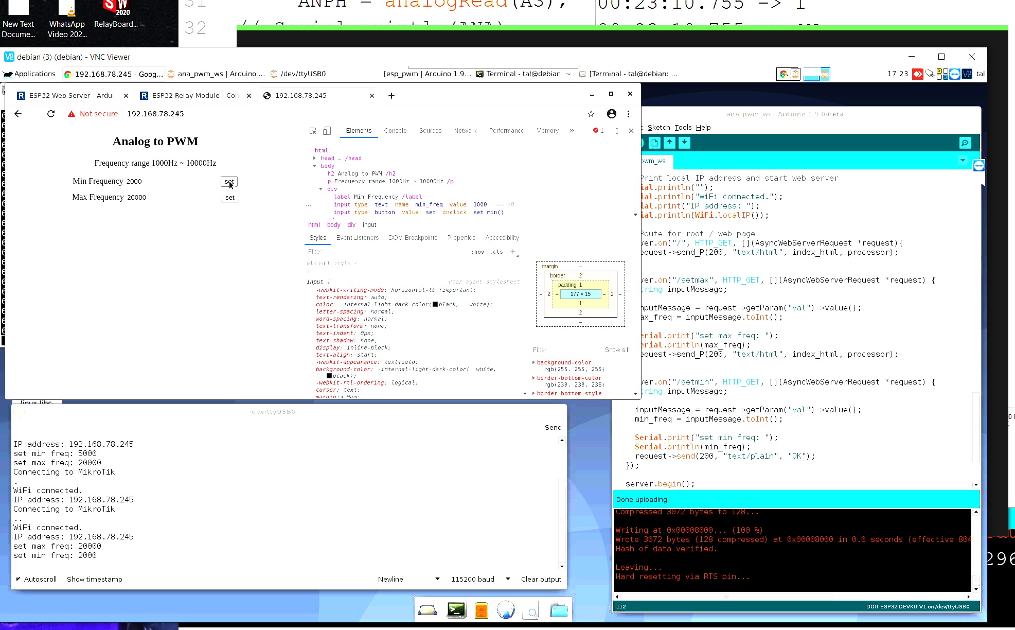

Replied by taloot on topic PlasmaC Fiber laser 1Kw head height control + auto focuas
yes about to finish it,
i make an opensource THC thats support plasma and support laser (capacitance)
and webserver (hosted in esp32 hardware )
using webserver u can set the THC mode 1-laser 2 plasma
also capacitance calibration upper and lower limit ( because value vary depends on head specs size and sheet thickness )
higher and lower frequency for PWM ...
i use ESP32,becouse its faster and more stable PWM, also the hardware is very capable WLAN and BLE.
now it should work well.. but i need to modify Linuxcnc,, to remove the retraction after probing coz it will probe to piercing height directly
in 2-3 days it will be online in my github
i bought this head its new desing
also i found cheap and good laser sources
4 weeks old laser source from JPT its lighter than other sources, cost about 6k$
